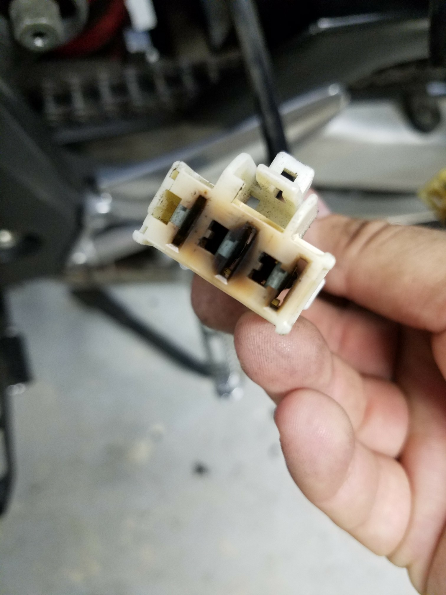

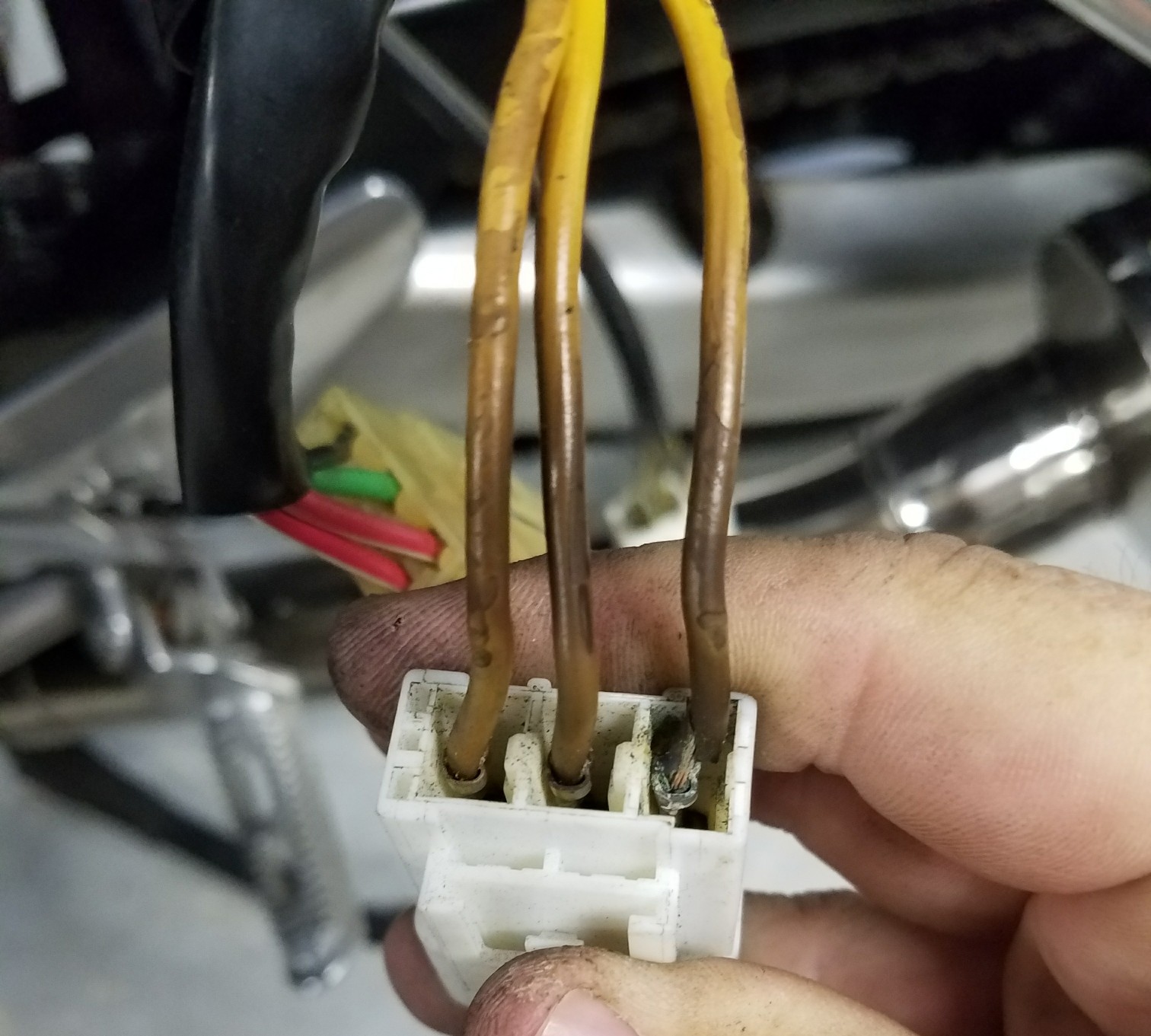

Got a couple pics of what I found.. last time I checked the plug it looked brand new. Will end up removing about 2" or so of wire on the r/r side. All good, will have it fixed soon enough. Thanks for the link John, had been looking at some weatherproof ones from msd but cant find wire gauge size listed on amazon.
Usually check this plug once every couple years. I just checked it while the tail section was off and the plug shows the signs of failure in the making. My volt meter on the bike never showed any sign of fluctuations on my last ride so that is a good sign. Did a quick check of stator and R/R and both check out as well. Will need a new plug and pin connectors to install. Doubt honda sells these, anyone got a source to buy the 3 connector? Thanks
