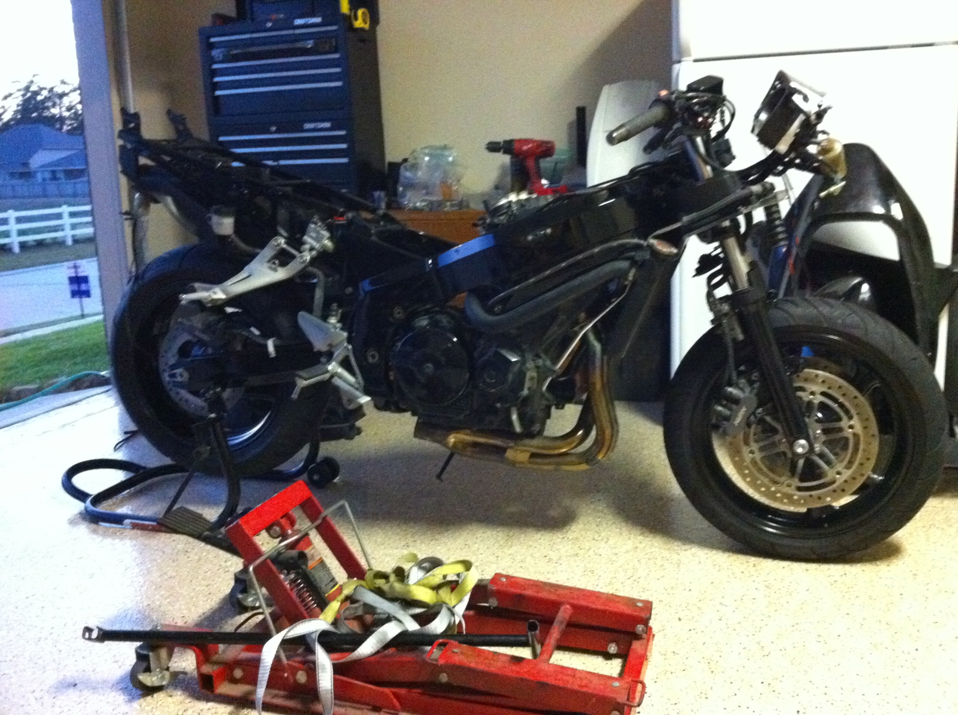

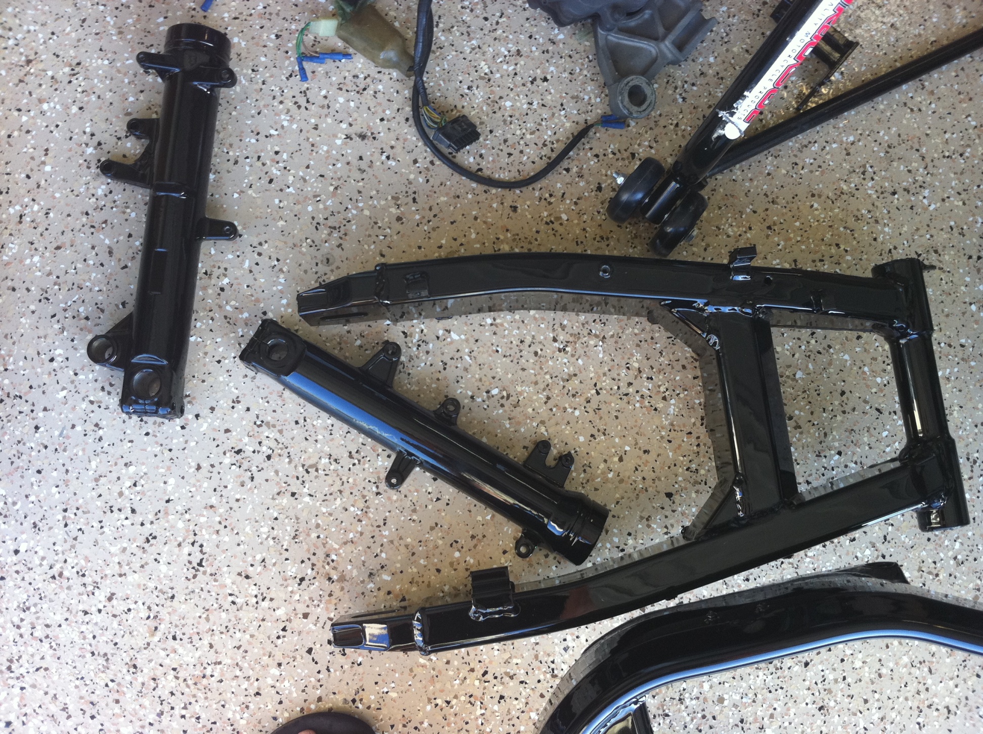

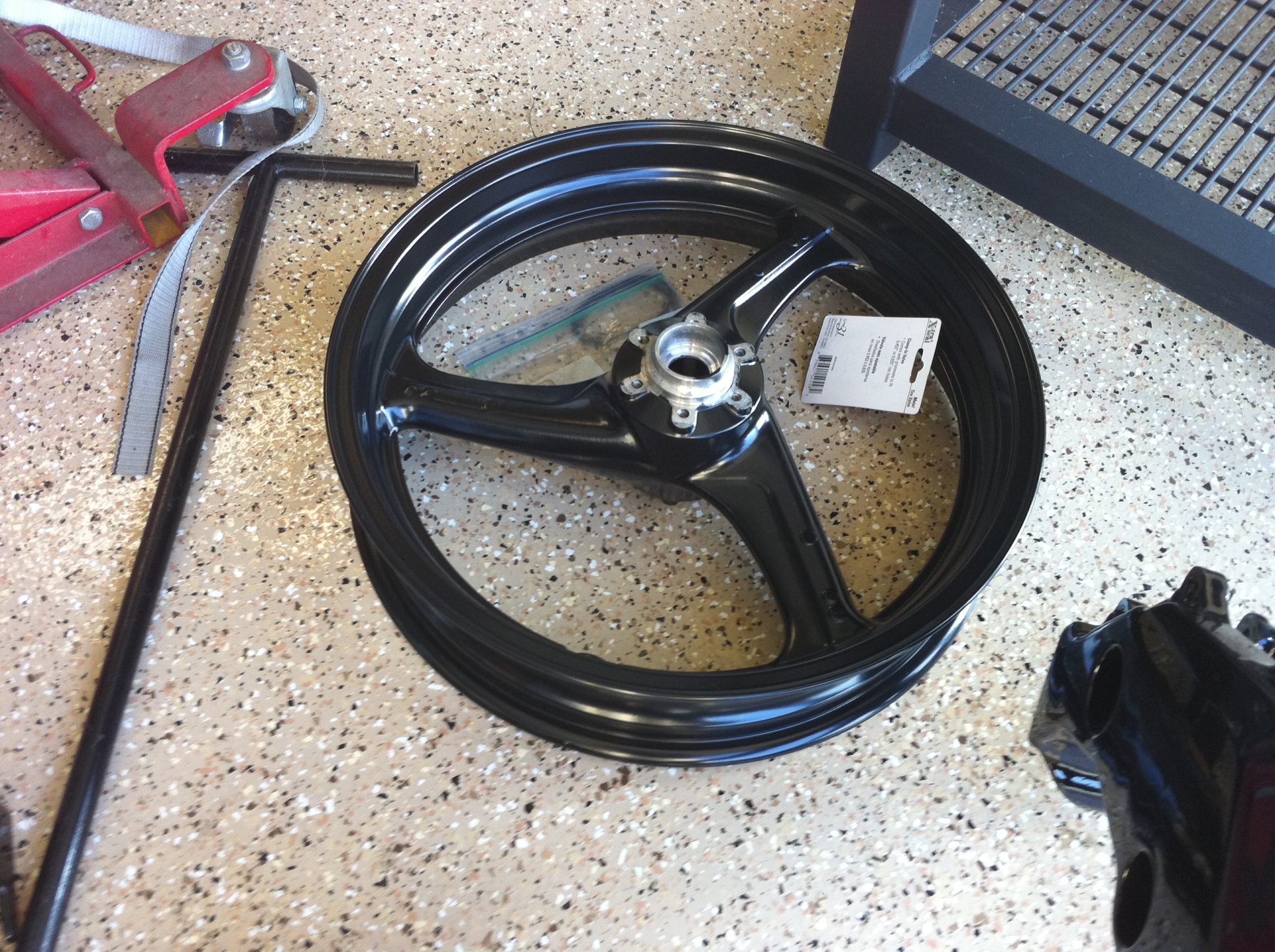

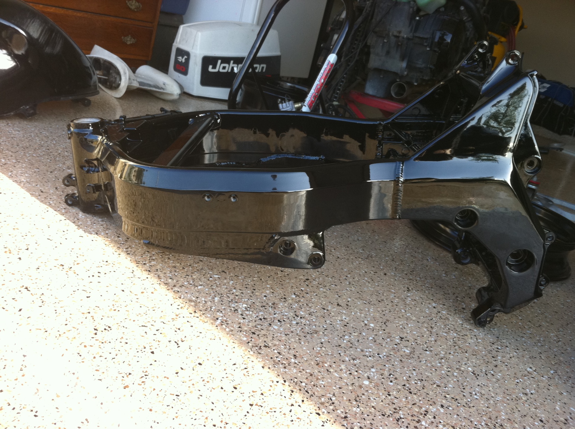

RU660R Posted February 21, 2011 Posted February 21, 2011 Here's some pics. Edit: As you where posting I was uploading. Quote
cityboy21 Posted February 21, 2011 Author Posted February 21, 2011 Thanks RU. Everything turned out beautiful. I would like to match the wheels to the original matte of the frame. Quote
