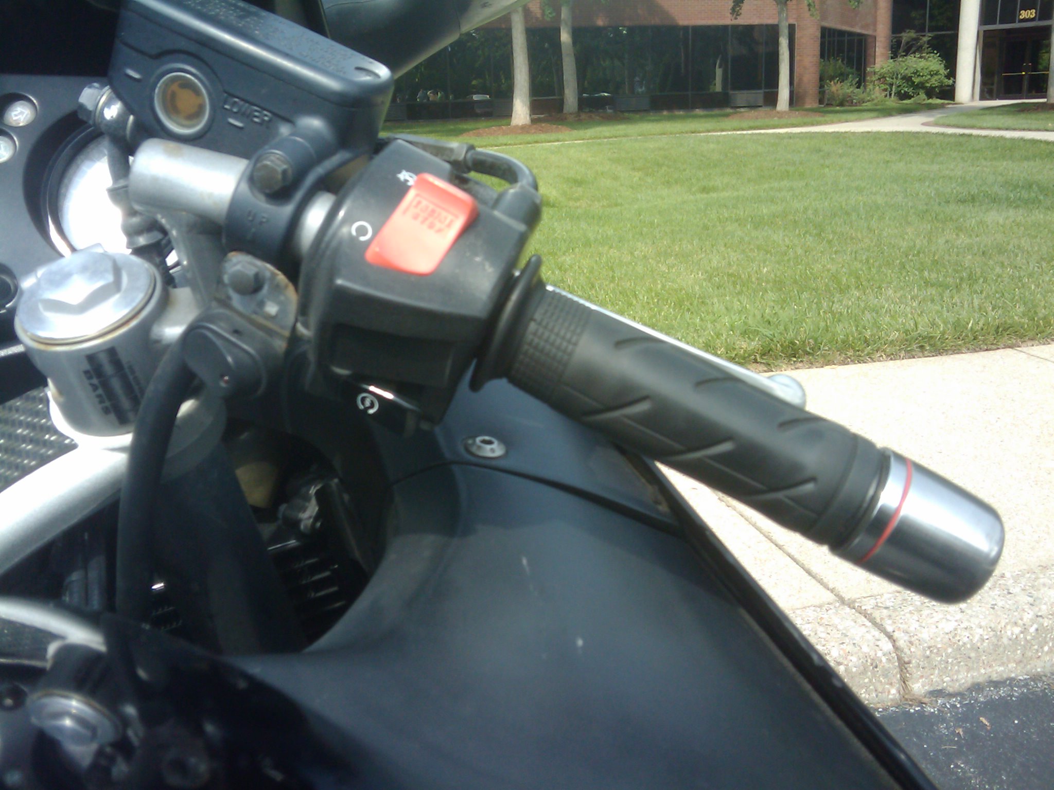

matthend Posted June 14, 2009 Posted June 14, 2009 Just got back from trailering mine and my fathers bikes to north carolina and back. I unload my bike to discover the right helibar now sits about 1.5 inches lower! I have throttlemeister bar ends, so maybe that contributed. I coudn't have overtightened one side because the bike was upright on the trailer, and I was concerned about over compressing my forks. Can I bend it back up with a fence pole or something, or is it ruined structurally now? Thanks guys, I am so pissed I can't see straight!! Quote

matthend Posted June 15, 2009 Author Posted June 15, 2009 I should clarify. I bought the "new improved" more expensive CD. It has plastic cylinders that go over the bar ends, presumably to keep from messing with peoples grips. The problem with that is it puts all of the pressure on the very end of the bar instead of spreading the force across the entire grip. My throttlemeister bar end probably didn't help because it moved the point taking that force further out. Calling them and raising hell when I get a free minute. Will update with wht they say Quote

01xxallen Posted June 23, 2009 Posted June 23, 2009 I have heard of CD's bending Heli's but never saw any. Since the Heli's have a bend upward, I wonder how they would do as an attachment point for soft hooks. Too far in? Maybe some of those soft covers for the straps. Adding length to the bars (throttlemiesters) will dramatically increase the leverage at the weld. I'm curious, what bent? The handlebar part or the curved part? Quote
