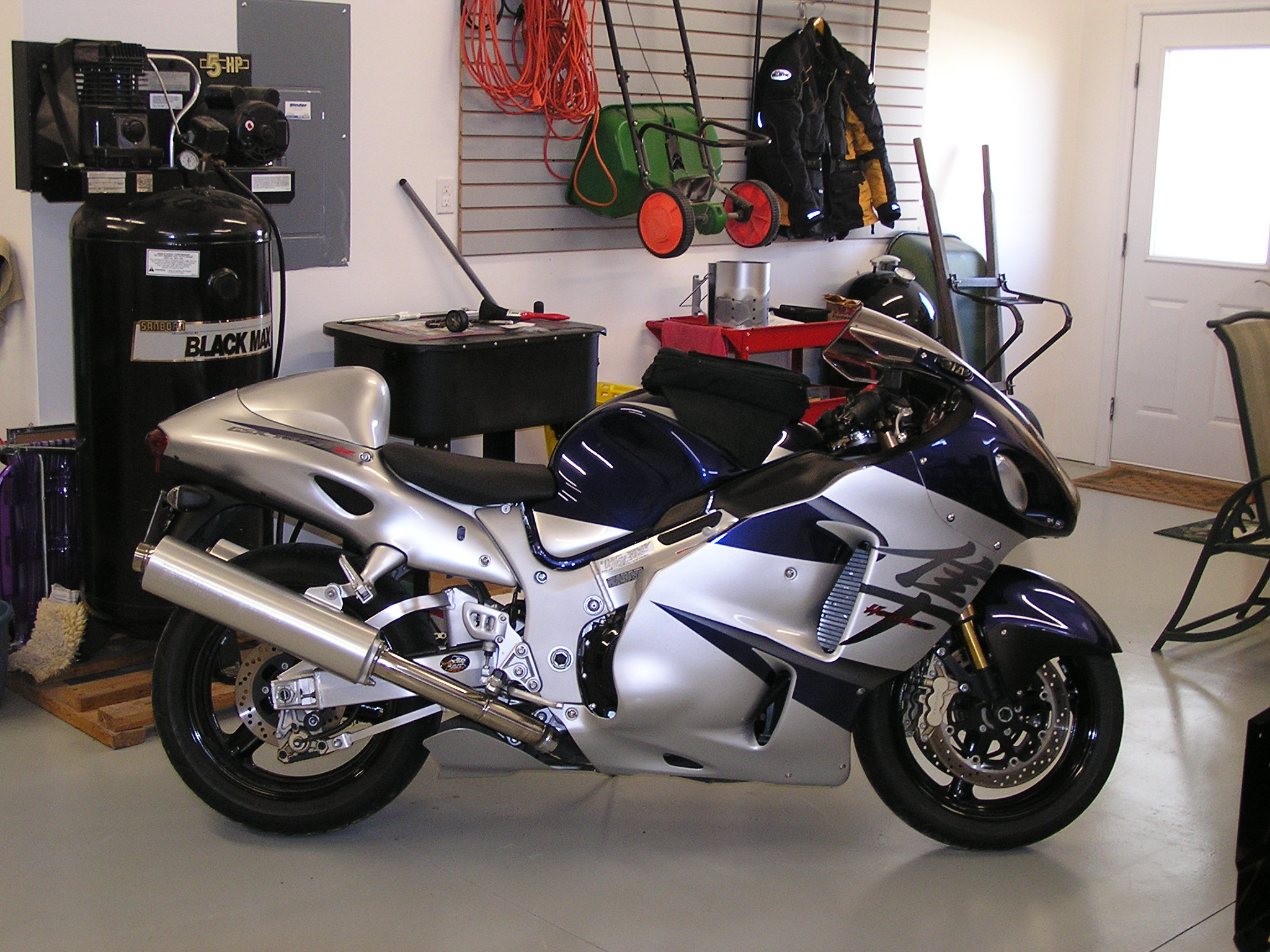

uvaldeXX Posted October 22, 2008 Posted October 22, 2008 I've owned my 02 bird since May of '07. I've spent the last year trying to learn how to ride it, as it is my first "sport bike". Added a Throttlemiester and change the tires to PR2"s, other than that, it's stock. Wondering what mods other riders have made that in retrospect they think really improved performance and or handling. Looks like many recommend the 6mm shim, that's pretty damn cheap! thanks, Jim Quote
