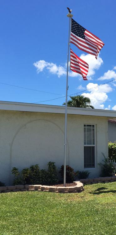

John01XX Posted August 13, 2016 Posted August 13, 2016 Here is a quick picture I took of mine today Quote
DBLXX Posted August 14, 2016 Posted August 14, 2016 Very nice - love when people have a flag in their yard. Doubly glad no one complains. Quote
