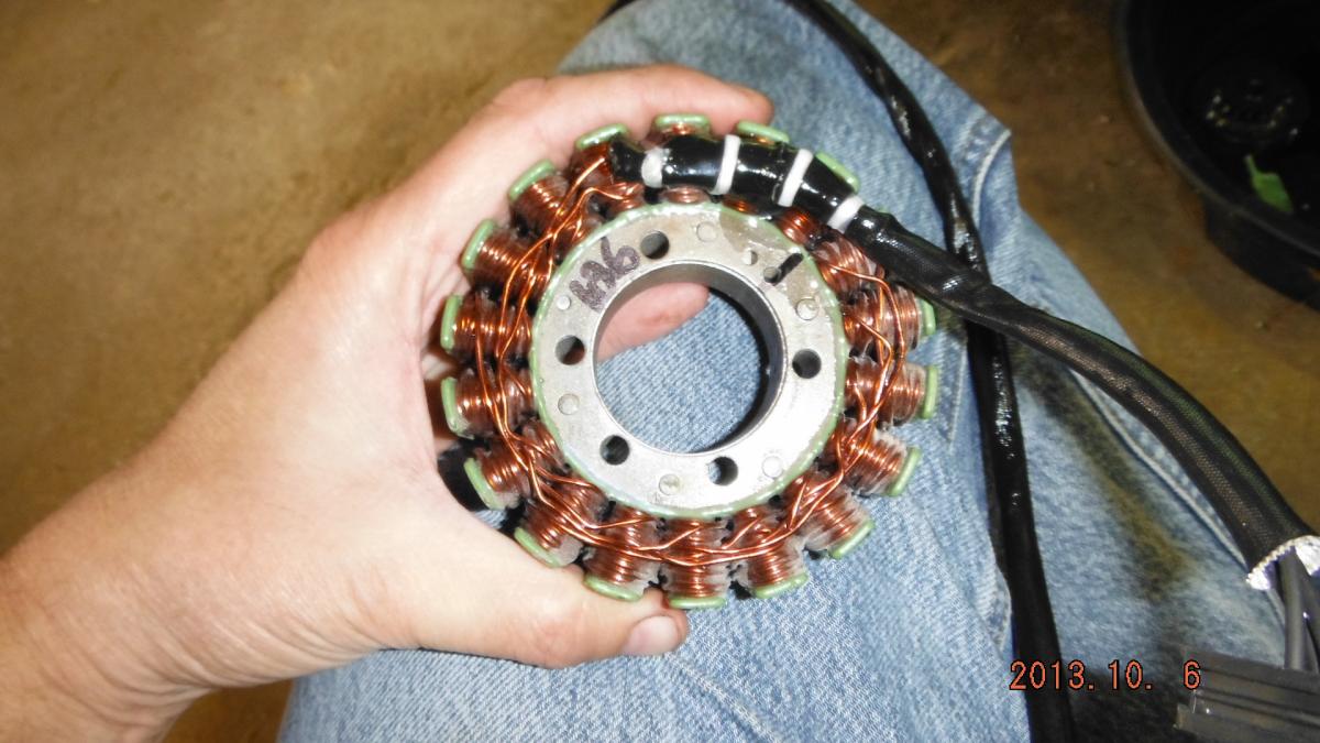

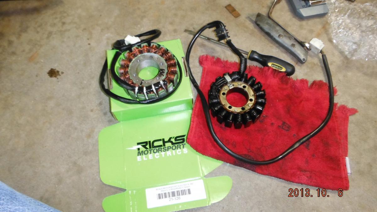

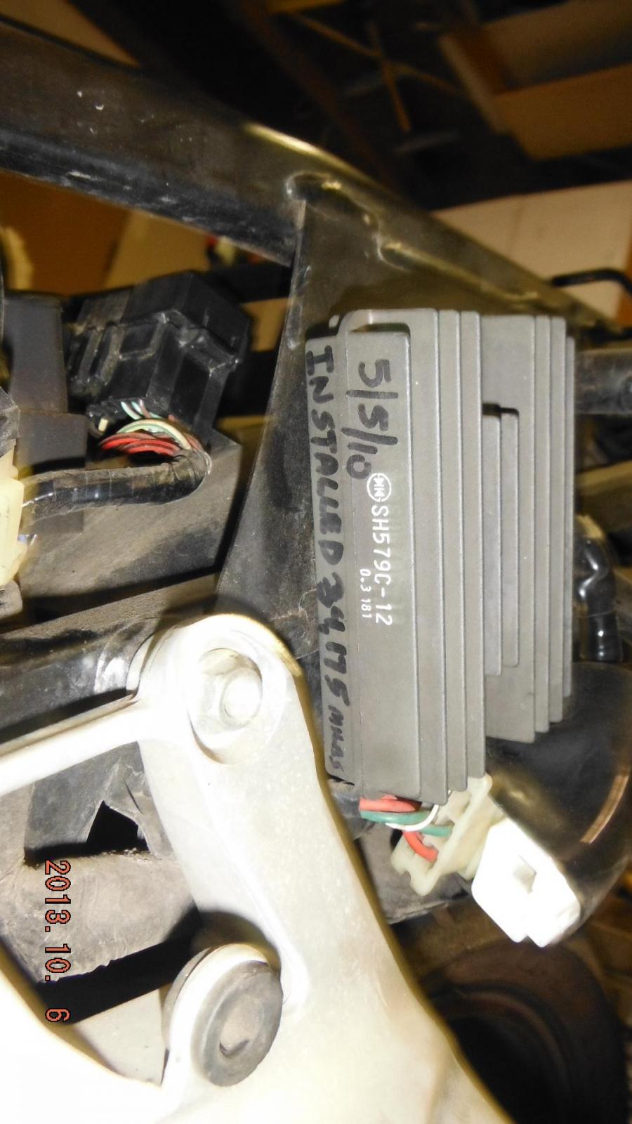

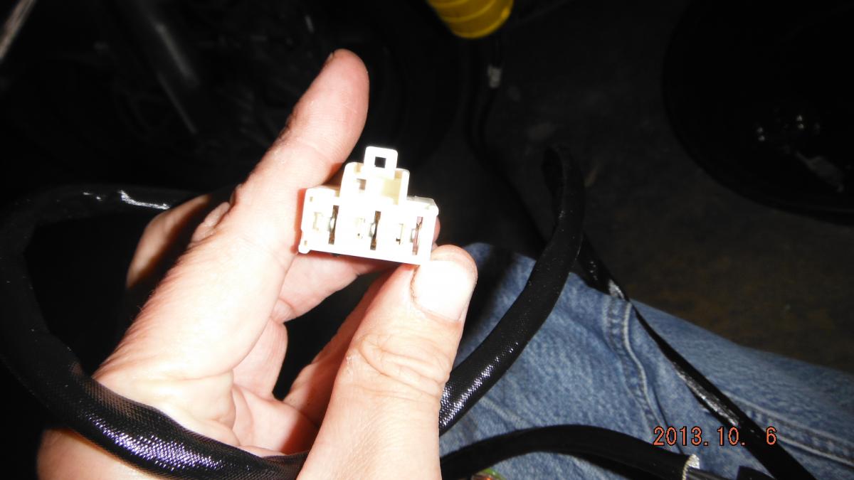

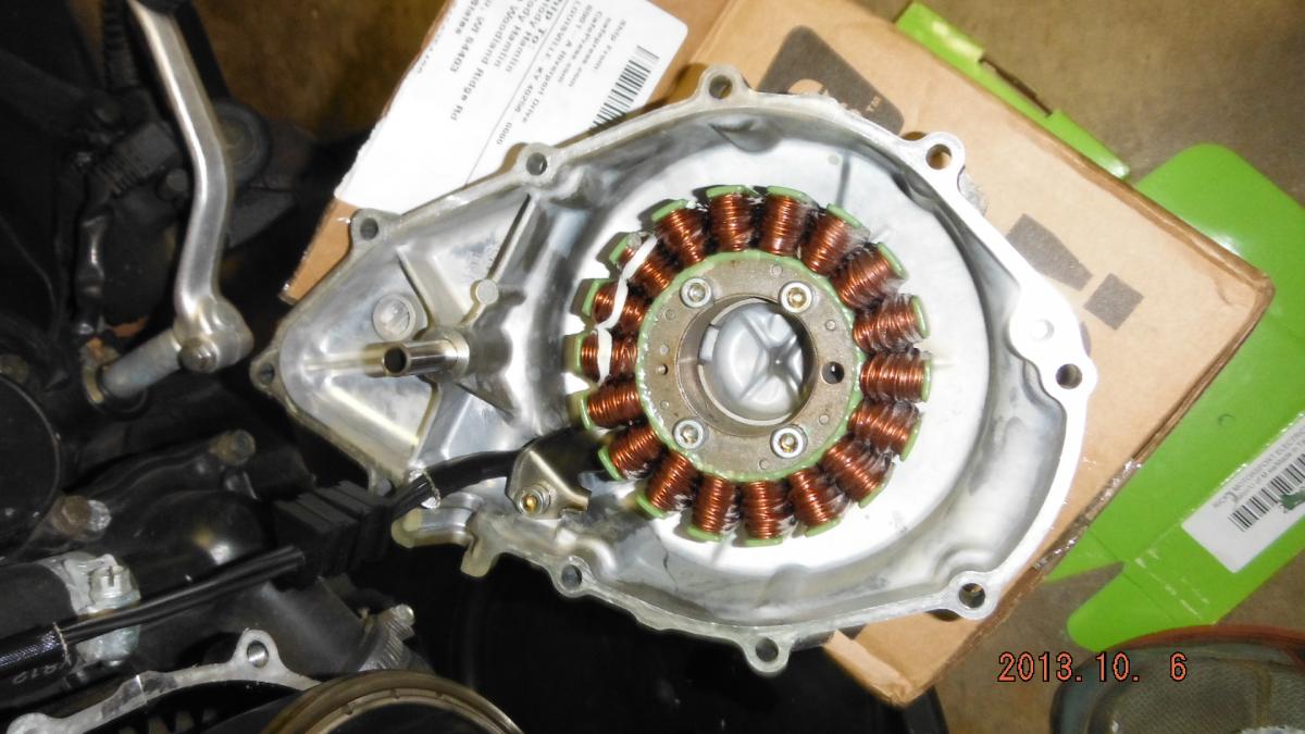

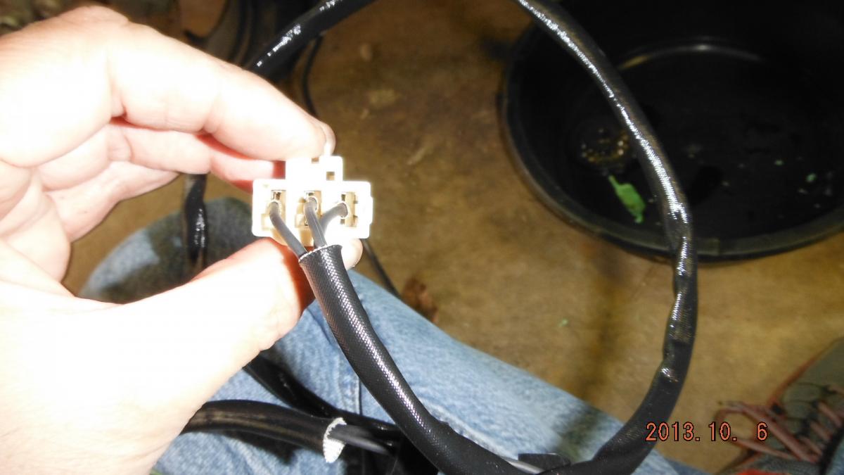

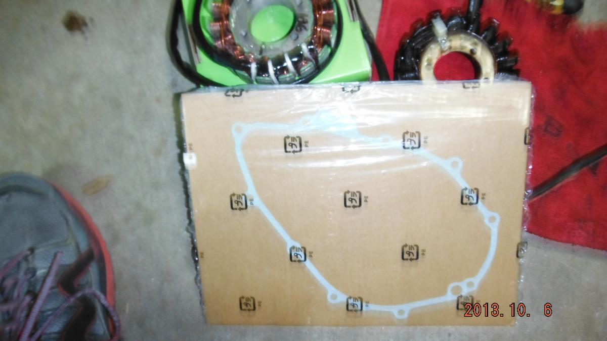

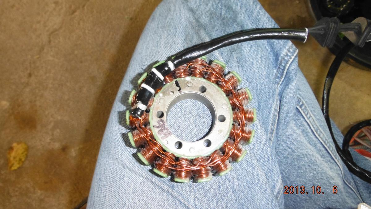

XXitanium Posted October 3, 2013 Author Share Posted October 3, 2013 Is "compuncted" a word? I went and picked it up today. They diagnosed a bad stator and the diodes were OK on a static test, but couldn't diagnose a dynamic test w/out having the new stator installed. It's a Rick's stator. I ordered an OEM gasket off flEabay..... I have an early regulator in a box out in the garage - spare. Can they be re-wired? Man, it was a fun ride home. Quote Link to comment Share on other sites More sharing options...

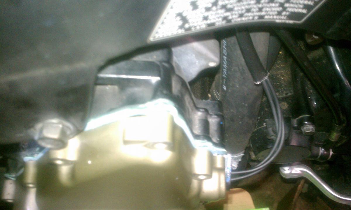

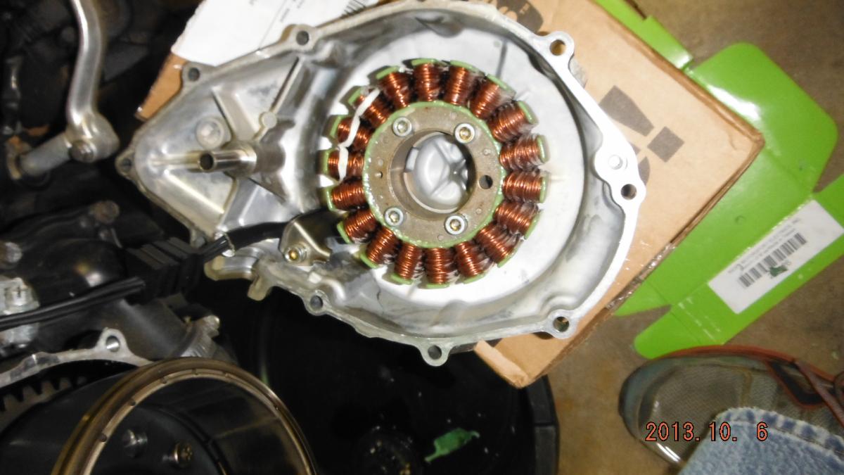

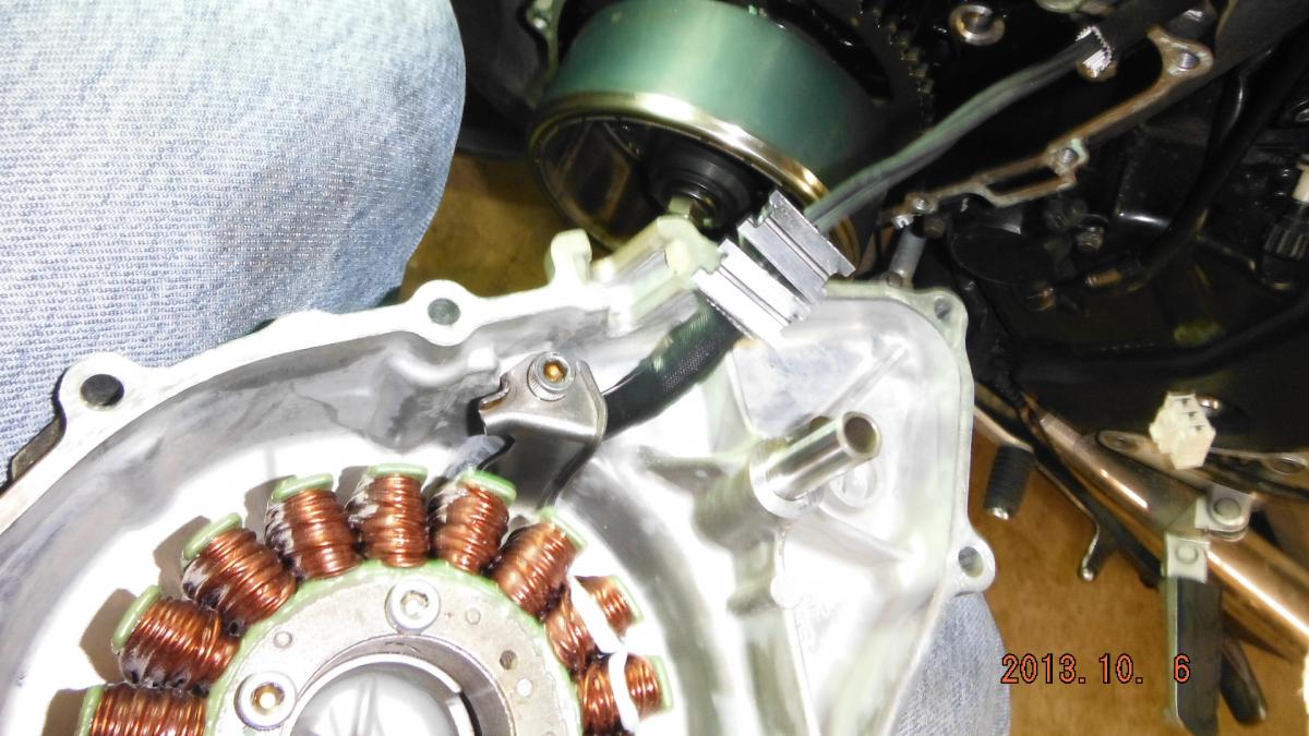

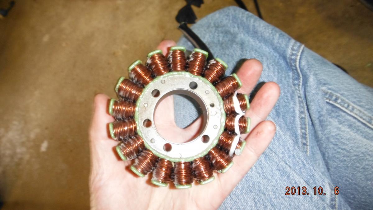

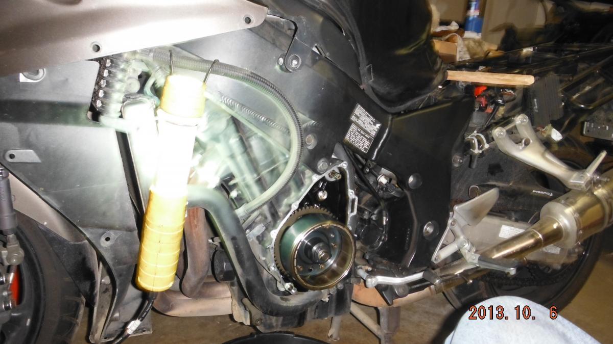

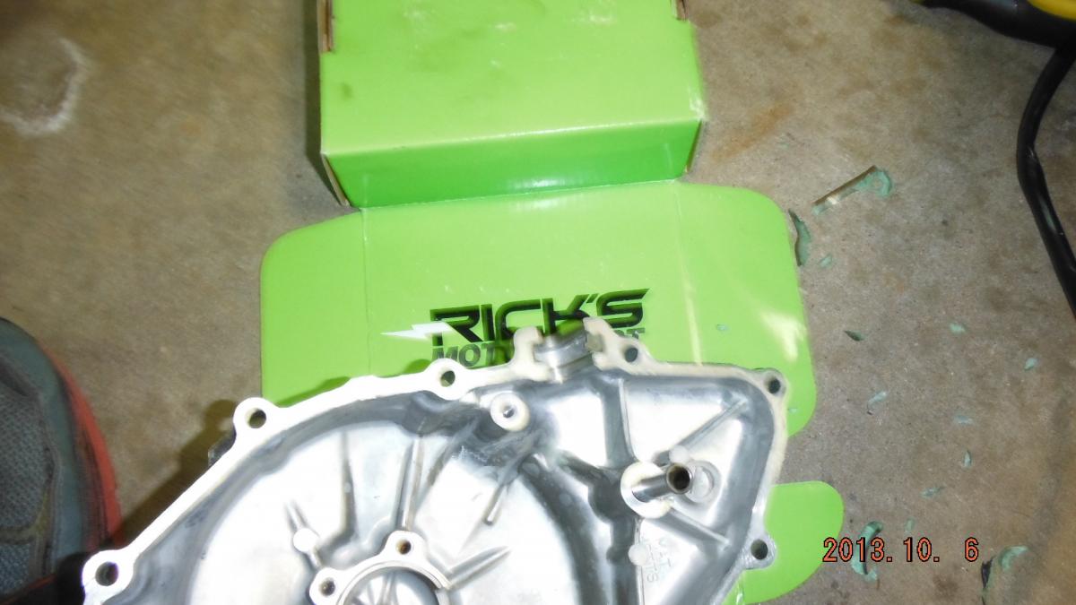

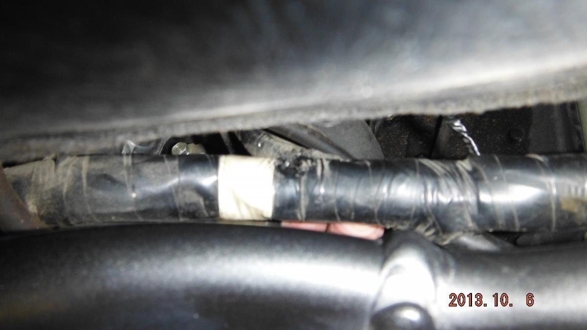

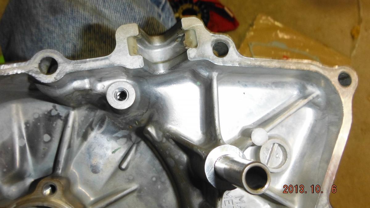

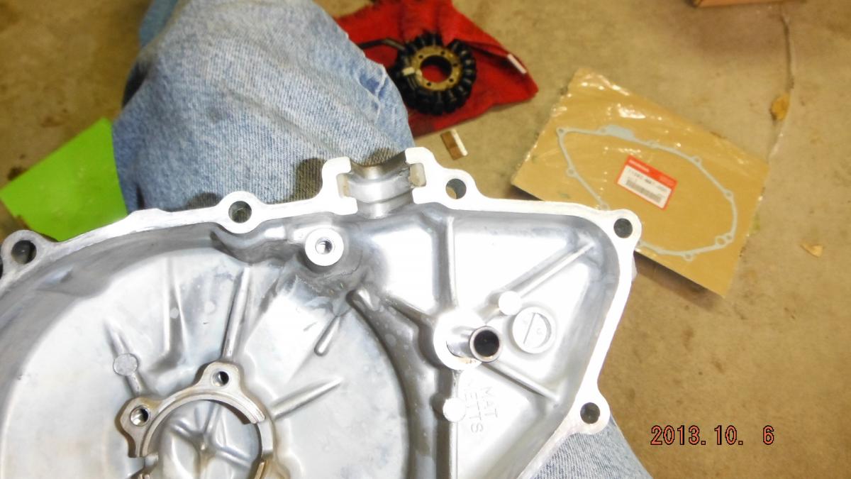

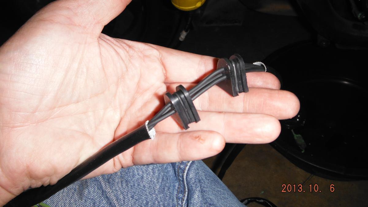

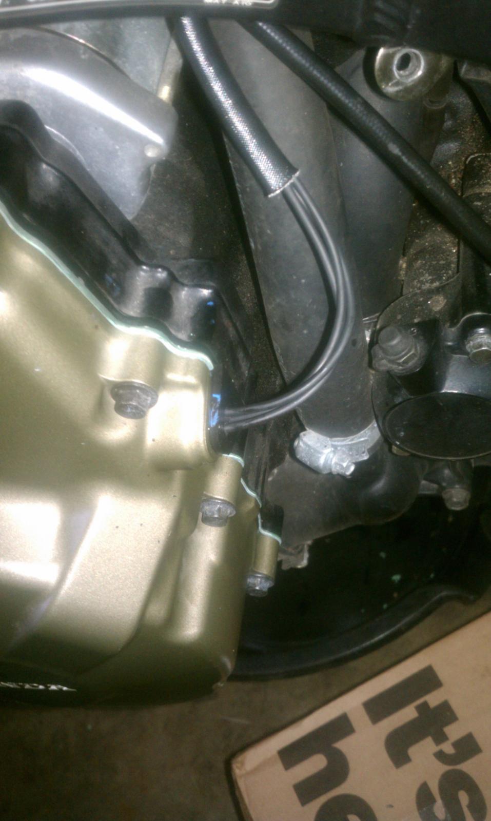

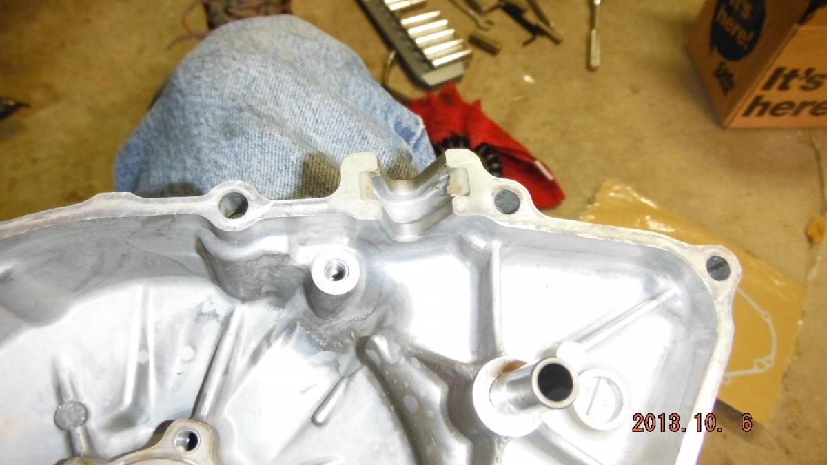

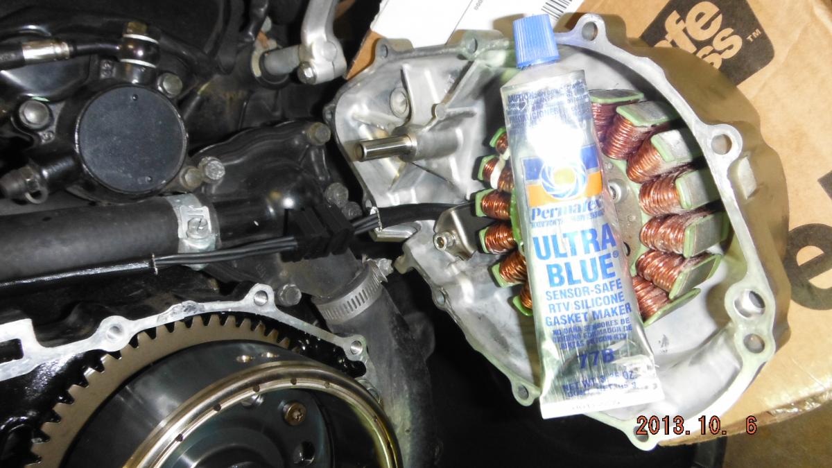

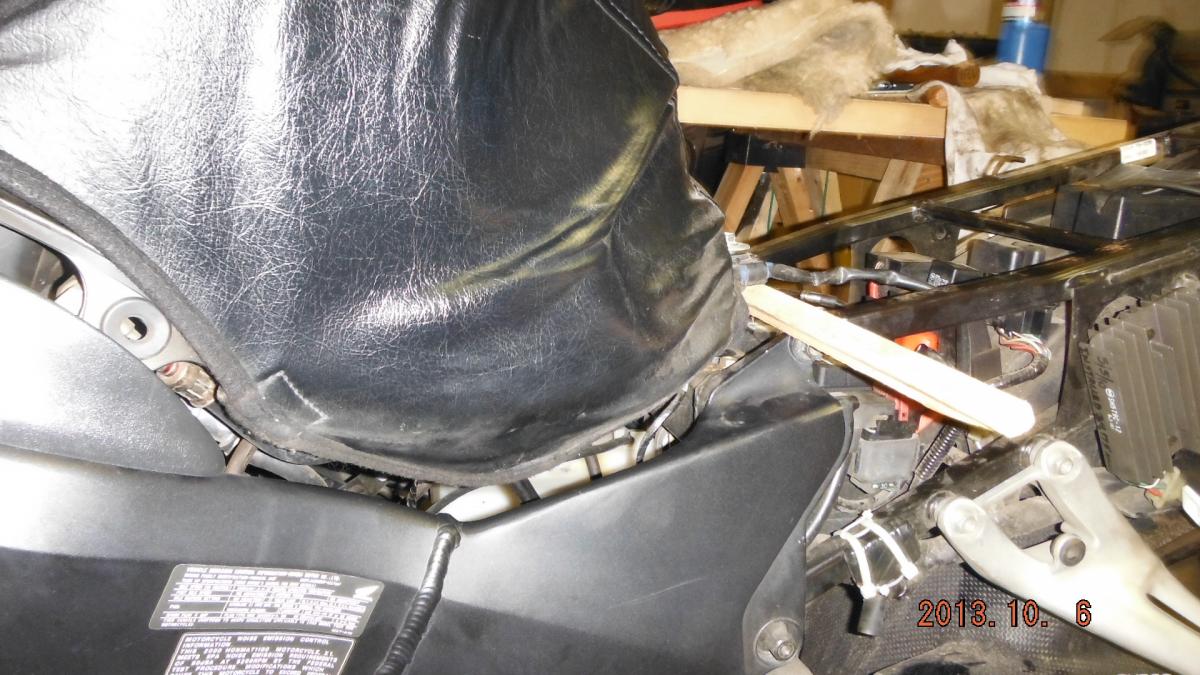

XXitanium Posted October 6, 2013 Author Share Posted October 6, 2013 I'm starting to put it back in. I think this may have been the factory stator. There appears to be a stealth wire-tie below the tank that has a plug that pins into the frame. It looks like it's main purpose would be to keep wires out of the way while the bike was being assembled. That ook a little monkeying around. I had to take the tank loose. The new stator came with the rubber grommet/seals on the wires for where they poke through the stator cover. It looks like (the factory?) had some silicone placed in with the old grommets. I noticed it when I was cleaning off the old gasket. QUESTION: Do I need to put in some RTV sealant like was there? Quote Link to comment Share on other sites More sharing options...
Zero Knievel Posted October 7, 2013 Share Posted October 7, 2013 I would. They aren't waterproof, but you don't want just anything getting in there. Quote Link to comment Share on other sites More sharing options...

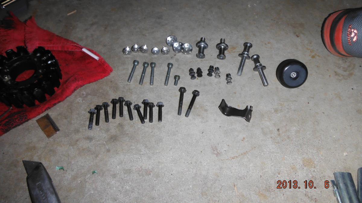

XXitanium Posted October 8, 2013 Author Share Posted October 8, 2013 I did. Caleb texted me. I had blue laying around. I finished the stator install. I don't seem to have a correct amount of fairing screws though. I'm looking at the left side. I'll highlight the ones I think I have wrong. Along the top row, I have two small ones and a large one. There is a place for a small one at the bottom front that ties into the back-plane - gets a lot of mud kicked up on it. I have a small one there. I seem to remember taking a large one from below/behind the front wheel. I didn't look closely and I don't see how it would work either. There is one through the flexible piece that sets behind your leg. That looks like it should be small. I have a large there. There is one that goes below the stator cover. I have a large one there. One of the large ones from stock has been replaced by a frame slider. My maintenance manual isn't really specific on which ones go where. Could someone confirm these for me please? Thanks, Bill ...from the other thread. I went past my mechanic. He threw a meter on it for free. It appears to be charging. He showed how the test goes. You start the bike and the amps drop off as the battery starts to top off. I took some pics. Is there a way to batch load? Quote Link to comment Share on other sites More sharing options...
XXitanium Posted October 8, 2013 Author Share Posted October 8, 2013 Pics Quote Link to comment Share on other sites More sharing options...
XXitanium Posted October 8, 2013 Author Share Posted October 8, 2013 more pics. Quote Link to comment Share on other sites More sharing options...
XXitanium Posted October 8, 2013 Author Share Posted October 8, 2013 aaaand, a couple more. Quote Link to comment Share on other sites More sharing options...
