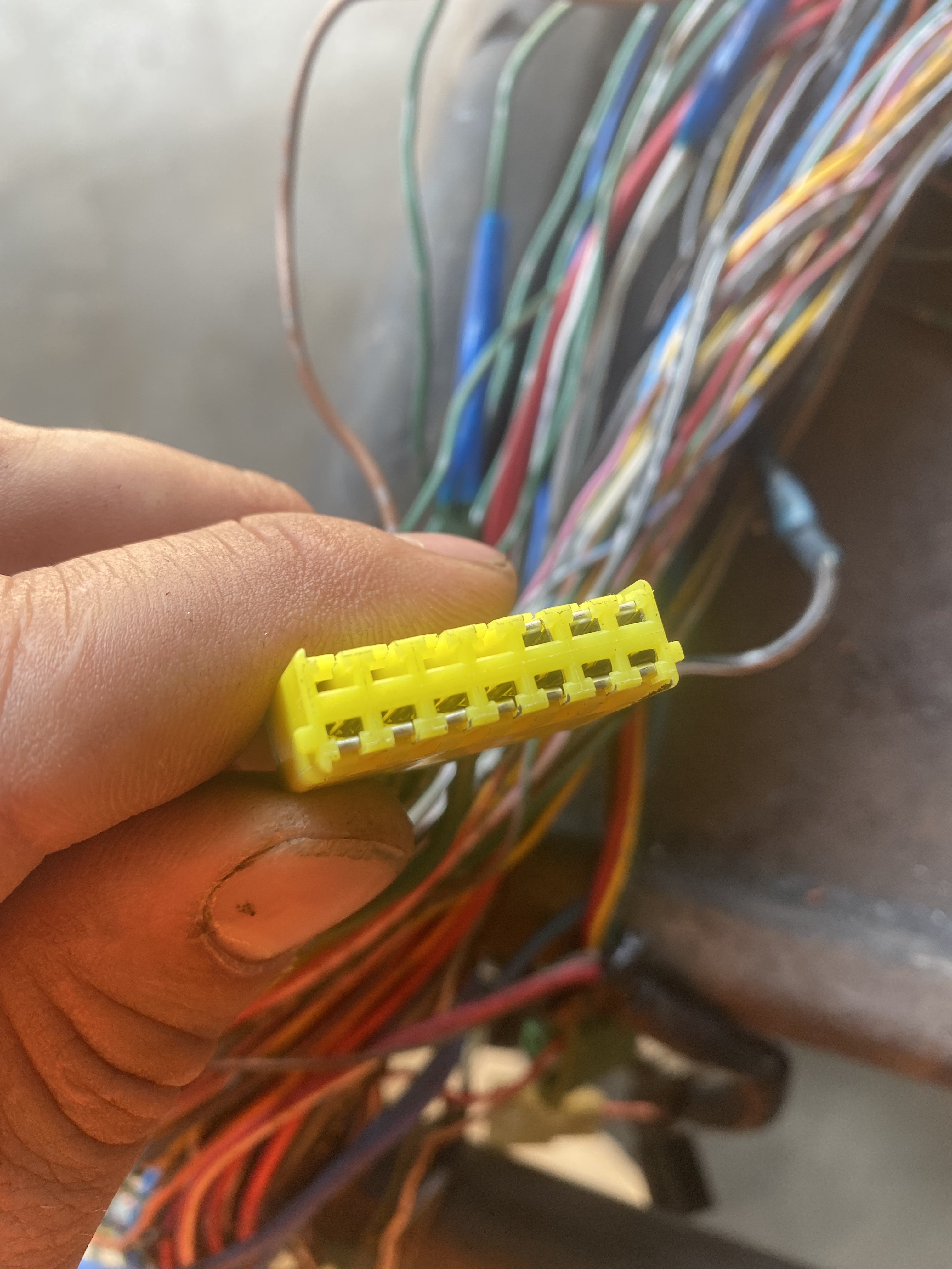

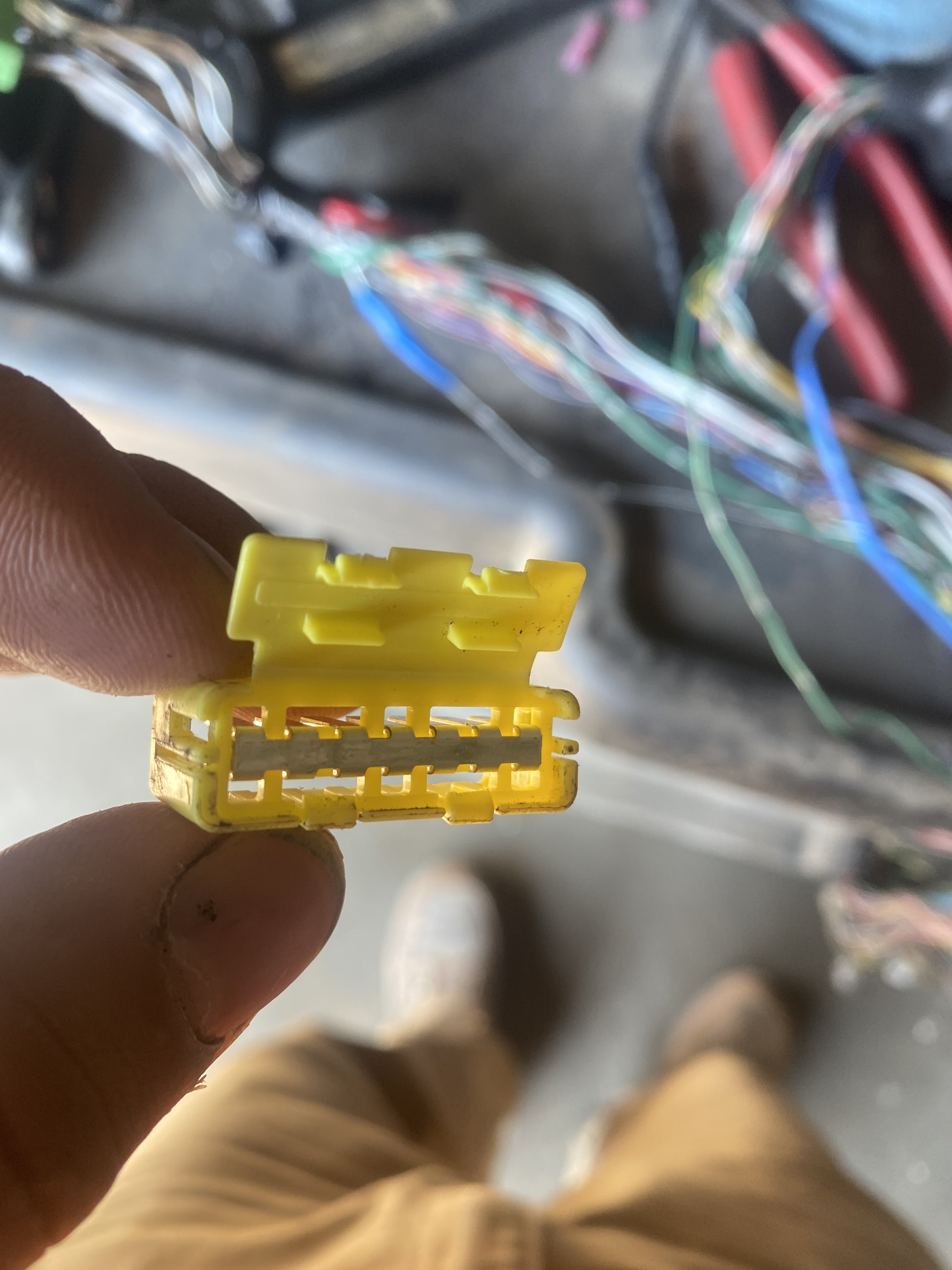

"There is continuity between all wires in the ground distribution when back probed with the cap on. "              That may be so but is not the whole story. Look carefully inside the cap and check the bus bar. It is not continuous. Honda in its wisdom broke this bar into sections. The solder job should match this exactly. If memory serves there were 4 altogether.

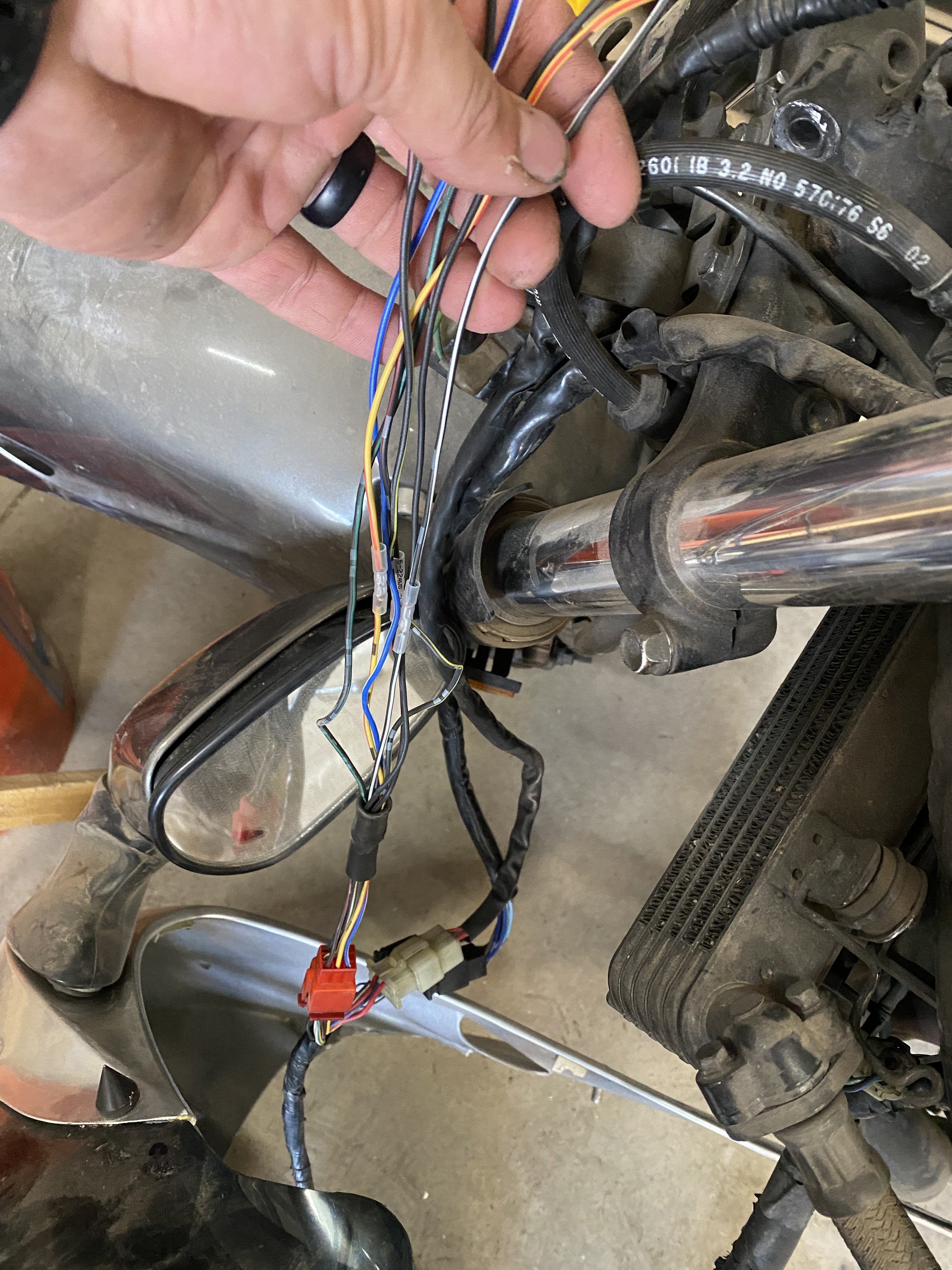

Well I was able to get the harness buttoned back up today. Also found another harness issue after and was able to confirm that the bank angle sensor. (New one from used harness and old one were bad). “Hot” wired the bank angle sensor and confirmed voltage at the fuel pump. Also had 4 wires melted together in the right hand control harness. What’s crazy is it tested good continuity through kill switch circuit when on, and none when off.

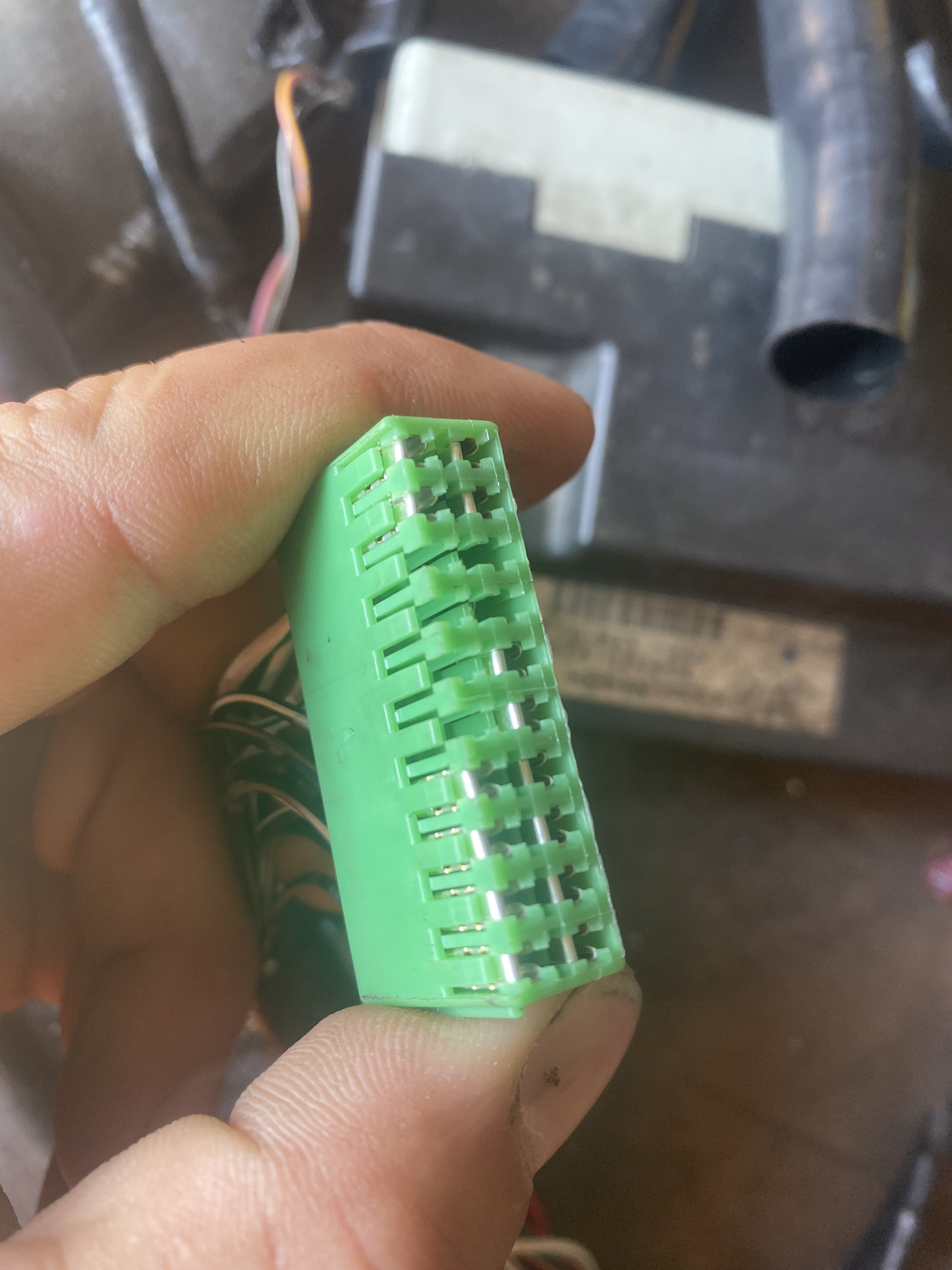

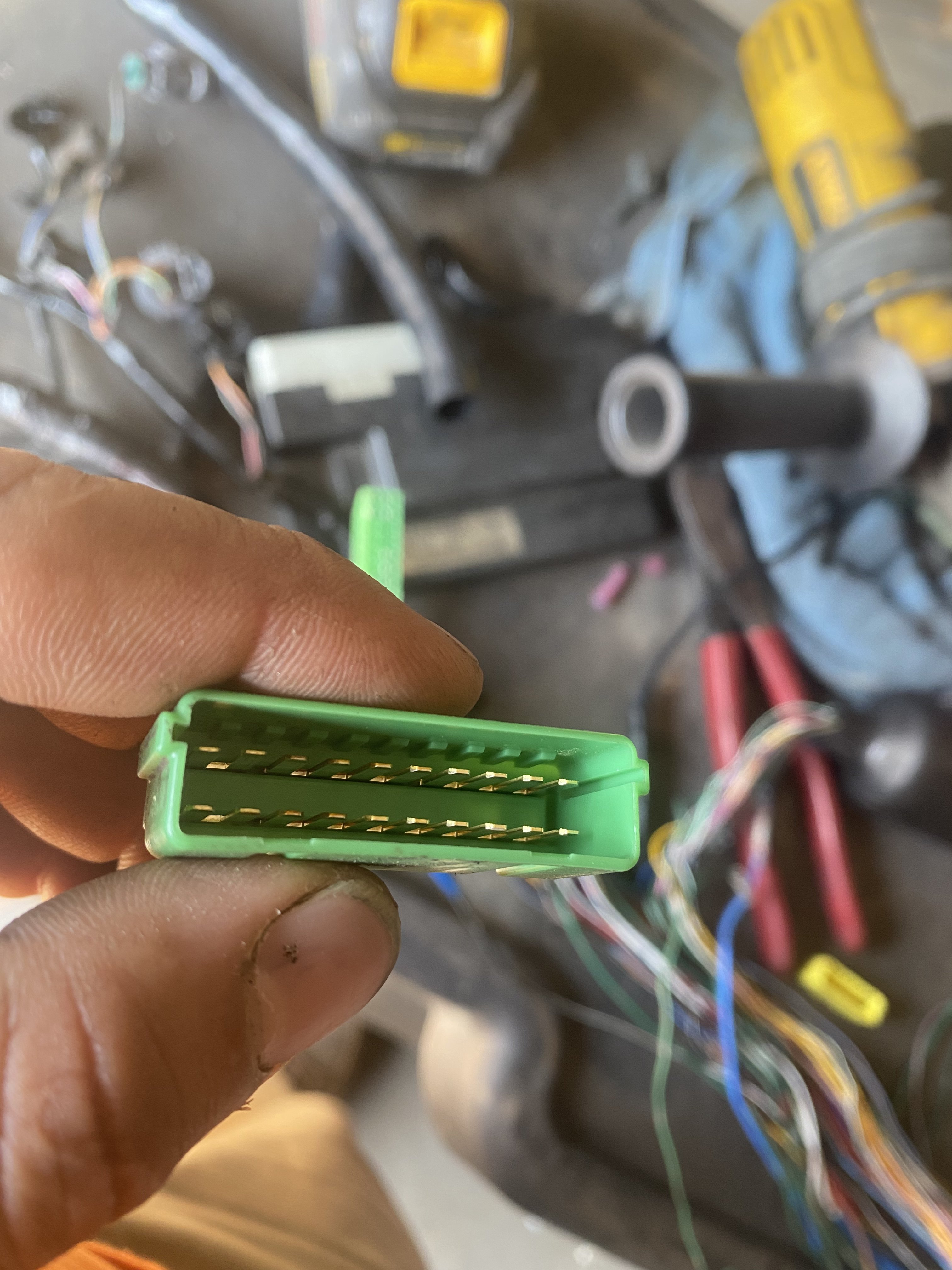

As for the loom fix. It is immaculate. Both the negative and positive. The yellow is my ground block that is all interconnected as show in pictures.
The green was my positive with 4 separate groups connected like Fizzy and Furbird said.
