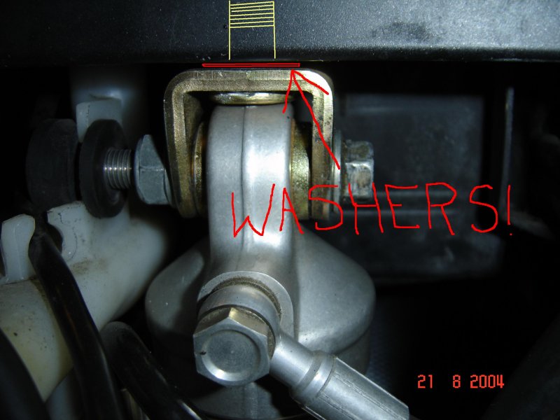

Thanks to Redbird for the photo and AirborneXX for the writeup! 1. Put bike on the center stand. 2. Remove gas tank. 3. Loosen the nut that holds the upper shock mount. This nut is sometimes very tight and you may have to grind the plastic from the inner fender that surrounds the nut in order to get a good grip on the nut. Loosen the nut until the rear tire touches ground. 4. I used 7/16" flat washers, you will need 3 or 4 and measure the thickness until you get enough to make 6mm. Cut out enough of the washers so they will slip around the shock bolt, in a C shape. 5. Put them between the upper shock mount and the frame. This space will open up as you loosen the nut. 6. Tighten nut reassemble bike and enjoy! * Photo is from the rear of the bike looking forward, the black you see in the background is the battery box
