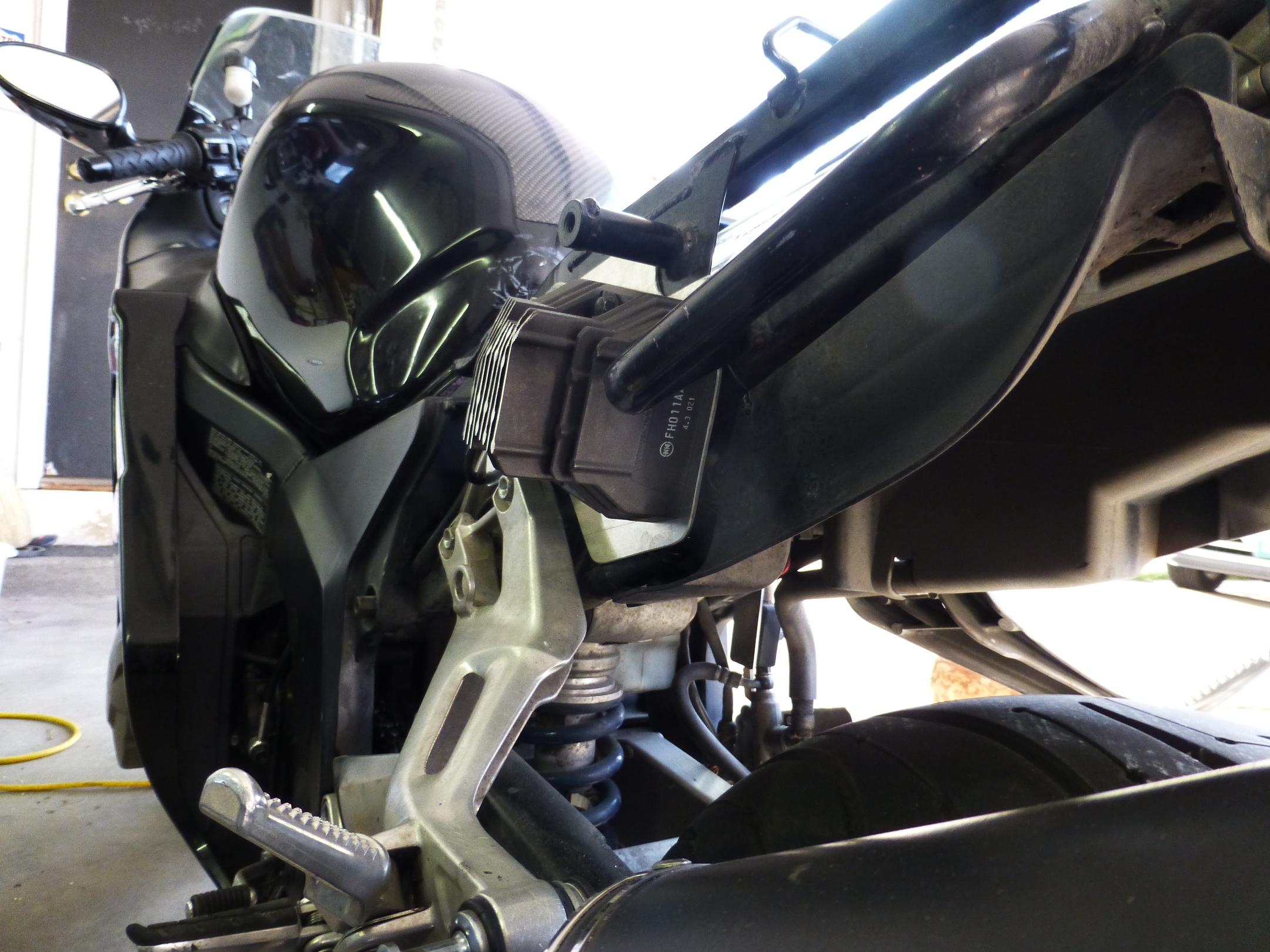

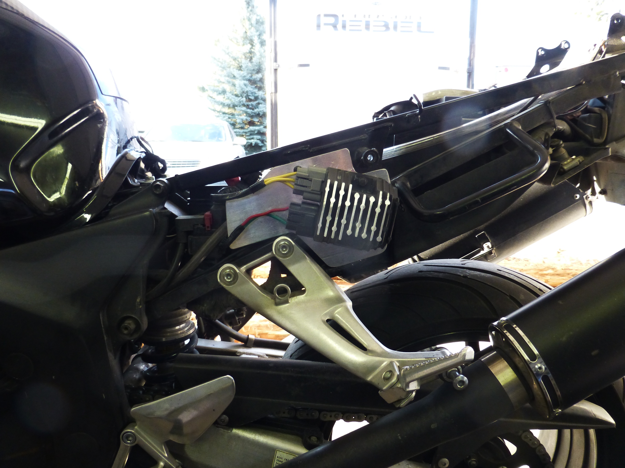

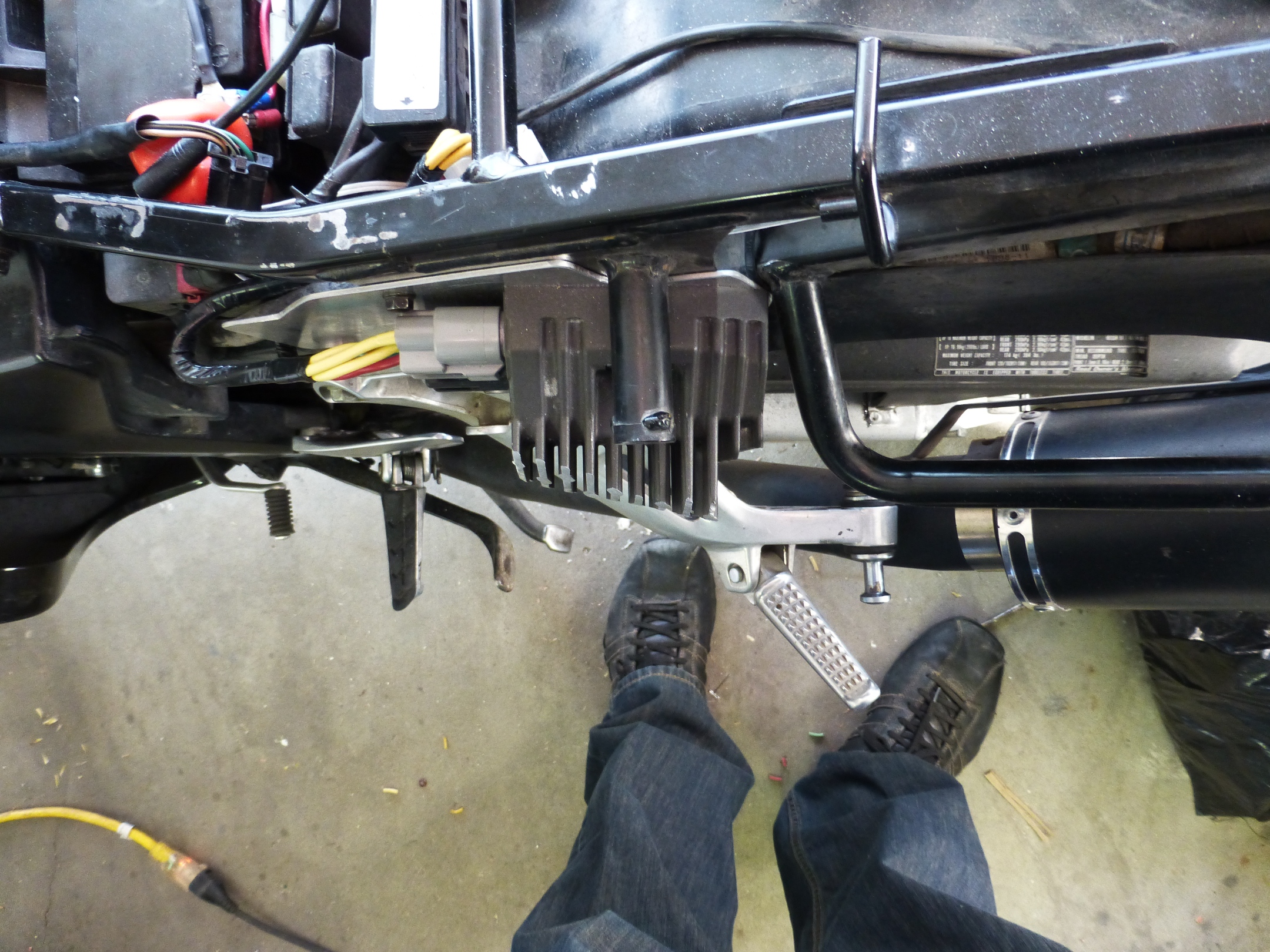

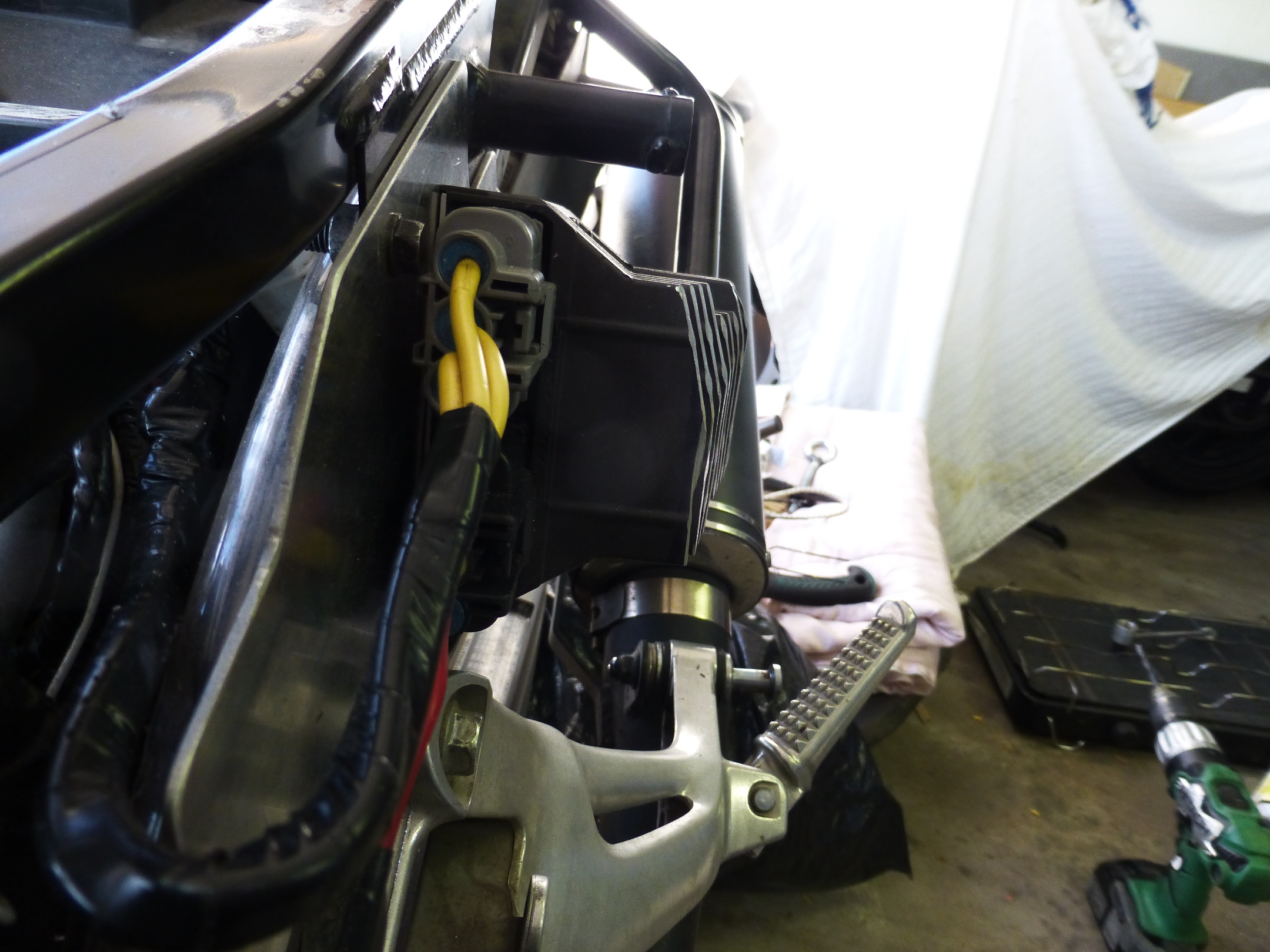

Chewtoy Posted September 15, 2012 Posted September 15, 2012 Noticed the battery needed a bit of water last weekend. Then noticed it was bulging along the sides! Took a look @ the r/r and the dang thing was cracked. So rather than replace with the same thing, went to roadstercycle.com and got one of theirs. It's a bit larger, and you have to do some wiring to hook it up, no more than changing the connectors on the existing wire ends, and you have to take care to mount it, as it's larger than the stock r/r, and you need to set it so it clears bodywork, but it's NBD. I only had to drill 1 hole in the rear subframe. A new Big Crank battery finished the job. So I have a better r/r with better connectors now. Total cost about $225. It's a Saturday afternoon job, I did some each night this week after work. The regulator was ordered on Sunday and arrived on Monday (!), but the battery took until Friday to appear. Pictures at the link. Hope this is of use to someone. https://plus.google.com/u/0/photos/10798003...490174598133313 Quote
Zero Knievel Posted September 16, 2012 Posted September 16, 2012 I got my R/R from Ricks. It fit almost perfectly...had to file off a 1/2" by 1/2" wedge off the heatsink to ensure it didn't touch the fairing. As the heatsink is oversized from OEM, it wasn't a problem. Quote
Chewtoy Posted September 16, 2012 Author Posted September 16, 2012 no filing needed here. Let's see which one lasts longer! Quote
HANKSXXX Posted September 16, 2012 Posted September 16, 2012 The difference is OEM or Mosfet (R-1, FJR style) The Mosfet is a big improvement... Quote
Zero Knievel Posted September 16, 2012 Posted September 16, 2012 The difference is OEM or Mosfet (R-1, FJR style) The Mosfet is a big improvement... Ricks is the Mosfet style. My voltage runs lower than the OEM R/R I had on...which isn't a bad thing. OEM regularly held around 14.6. Mosfet runs 14.3 and monitors voltage via the hot wire rather than needing a separate wire to ground. Quote
