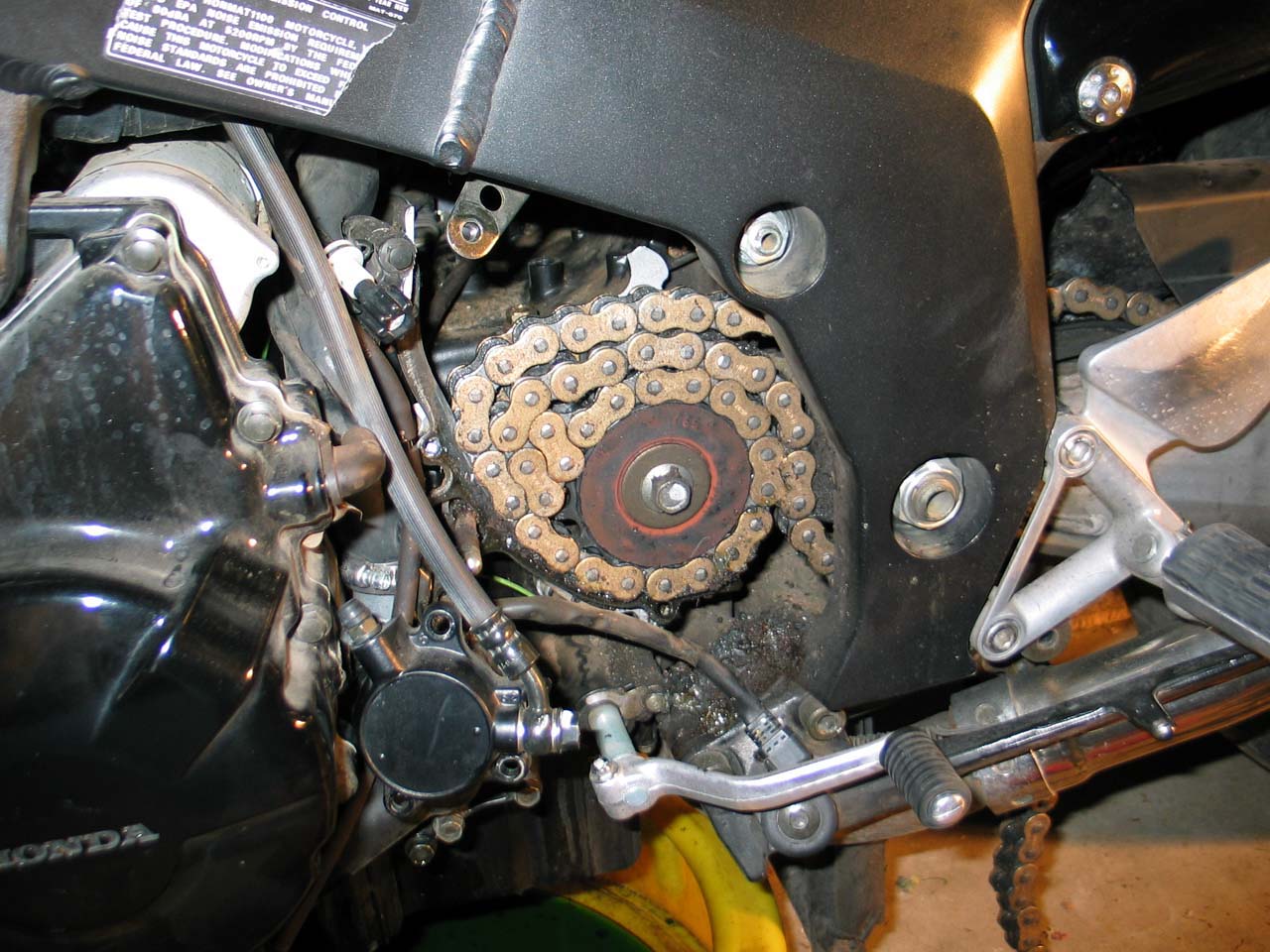

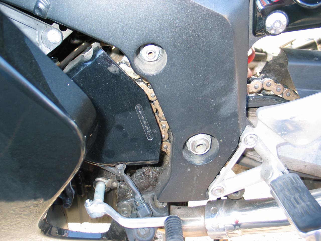

Red J Posted April 27, 2006 Author Share Posted April 27, 2006 I think I dropped the masterlink, cause it was like it was disassembled. No busted pins or busted sideplates or anything. I was on my way to Kansas City from Wichita (~180mi) and just got to the suburbia of KC. Pulled off the freeway to get a drink. I was doing around 20 and decelerating. The engine stopped, and I coasted to the median (traffic...). No lockup, chain was dragging behind the engine but not yet to the sprocket. No drama, really. I prefer it that way, to tell you the truth... Pushed it off the road, got on the cellphone and started to find a dealer with a chain. Went and found one, no masterlink, though. Dejected, I went back to the bike and started to wait for a friend to come and pick me up. That's when I saw this and knew my day was over: Then I saw this, but not before we spent the nite drinking. I was just running thru some old photos and found these. Ah, memories. Quote Link to comment Share on other sites More sharing options...

Fiona Posted April 27, 2006 Share Posted April 27, 2006 Sorry man.. forgive my ignorance here. Since I don't ever take my bike apart I'm not sure what I'm looking at there other than a busted chain. Am I reading correctly that there was more damage there than just to the chain? Something in the engine/tranny busted too? Quote Link to comment Share on other sites More sharing options...

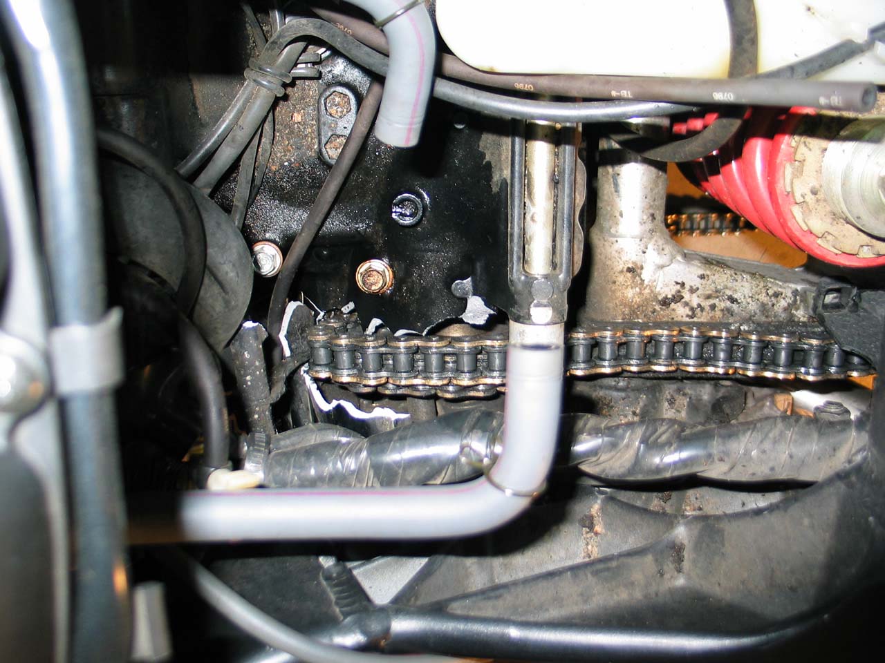

Red J Posted April 27, 2006 Author Share Posted April 27, 2006 Sorry man.. forgive my ignorance here. Since I don't ever take my bike apart I'm not sure what I'm looking at there other than a busted chain. Am I reading correctly that there was more damage there than just to the chain? Something in the engine/tranny busted too? It's not immediately evident if you've not done the job. Under normal conditions, there is room between the engine case and the sprocket for one chain, not two or three. Basically, the chain packed itself into the case and cracked the metal surrounding the front sprocket. This in itself is not that big a deal, but the sprocket cover also mounts the clutch slave cylinder, so even if I'd have put it back together, I would not have had a clutch. Plus the waterpump was also cracked (directly in front of the sprocket). Such was the need for the U-Haul. This is the view from the topside, looking down from underneath the tank. Normally, in this view you cannot see the chain. It didn't violate the engine/transmission sump, but it did require either: The replacement of the engine cases. or The repair of the engine cases, which would have required the disassembly of (at least) the transmission I replaced the cases, since the repair was going to cost plenty. After it was all said and done, I should have rather parted the bike out, or bought a complete engine. I ended up buying an engine from a board member which had an internal problem. I used the cases, and swapped my internals into it. Quote Link to comment Share on other sites More sharing options...
Fiona Posted April 27, 2006 Share Posted April 27, 2006 Sorry man.. forgive my ignorance here. Since I don't ever take my bike apart I'm not sure what I'm looking at there other than a busted chain. Am I reading correctly that there was more damage there than just to the chain? Something in the engine/tranny busted too? It's not immediately evident if you've not done the job. Under normal conditions, there is room between the engine case and the sprocket for one chain, not two or three. Basically, the chain packed itself into the case and cracked the metal surrounding the front sprocket. This in itself is not that big a deal, but the sprocket cover also mounts the clutch slave cylinder, so even if I'd have put it back together, I would not have had a clutch. Plus the waterpump was also cracked (directly in front of the sprocket). Such was the need for the U-Haul. This is the view from the topside, looking down from underneath the tank. Normally, in this view you cannot see the chain. It didn't violate the engine/transmission sump, but it did require either: The replacement of the engine cases. or The repair of the engine cases, which would have required the disassembly of (at least) the transmission I replaced the cases, since the repair was going to cost plenty. After it was all said and done, I should have rather parted the bike out, or bought a complete engine. I ended up buying an engine from a board member which had an internal problem. I used the cases, and swapped my internals into it. That sounds like a mess that would have made me sit on the side of the road and cry til I got struck by lightening. Thanks for the detailed info...I surely hope I don't ever have to see the inside of my bike that way. Quote Link to comment Share on other sites More sharing options...

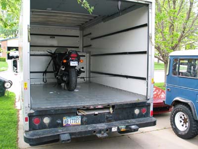

Red J Posted April 27, 2006 Author Share Posted April 27, 2006 It was a sunny day, so I'd have been waiting a long time. I like working on shit, so it wasn't a total waste. Quote Link to comment Share on other sites More sharing options...
