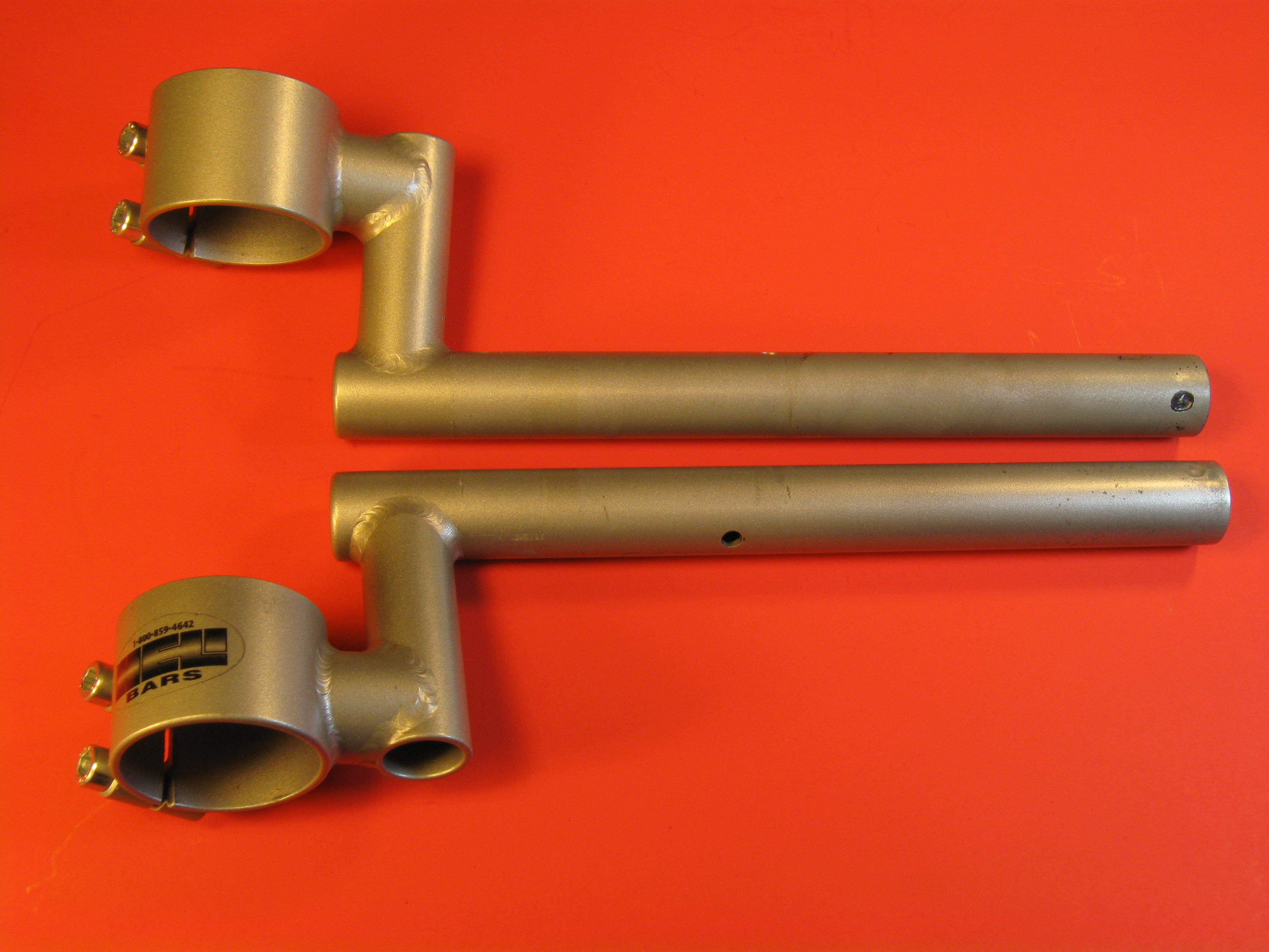

For sale: used set of Helibars. Excellent undamaged condition, all internal threads good, never down- no road rash on ends, not much use. $140 total delivered to any USA lower 48 state. sandman800ss@hotmail.com Update: received zero response here, put them on eBay at same price, SOLD in 24 hours. Sorry guys, I had to do it!
