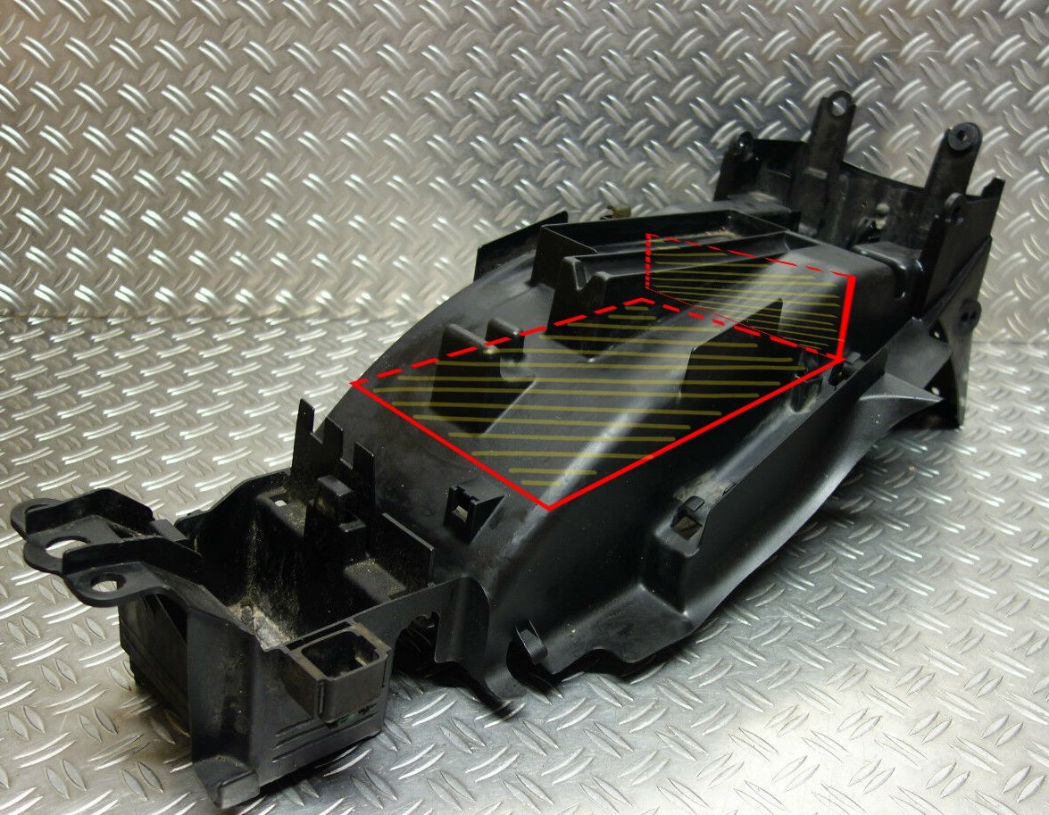

Disgusting thread ressurection. I've been thinking about this, I need somewhat bigger space under the seat. What are my options (aside from the elegant Tupperware solution
) - can the undertray plastic be welded? ABS I supposed, can I make into a specific shape, or am I destined for flat pieces and welding. Also, whats some minimal clearance from tyre to the undertray, wouldn't want to have those two touch

HOW TO: Double your underseat Storage
in The Garage
Posted · Edited by FTM
Haha ok but after the sumo test, how can I modify this undertray? Other than cut a hole and slap a flat piece of plastic and weld it shut all around.
Something like this
