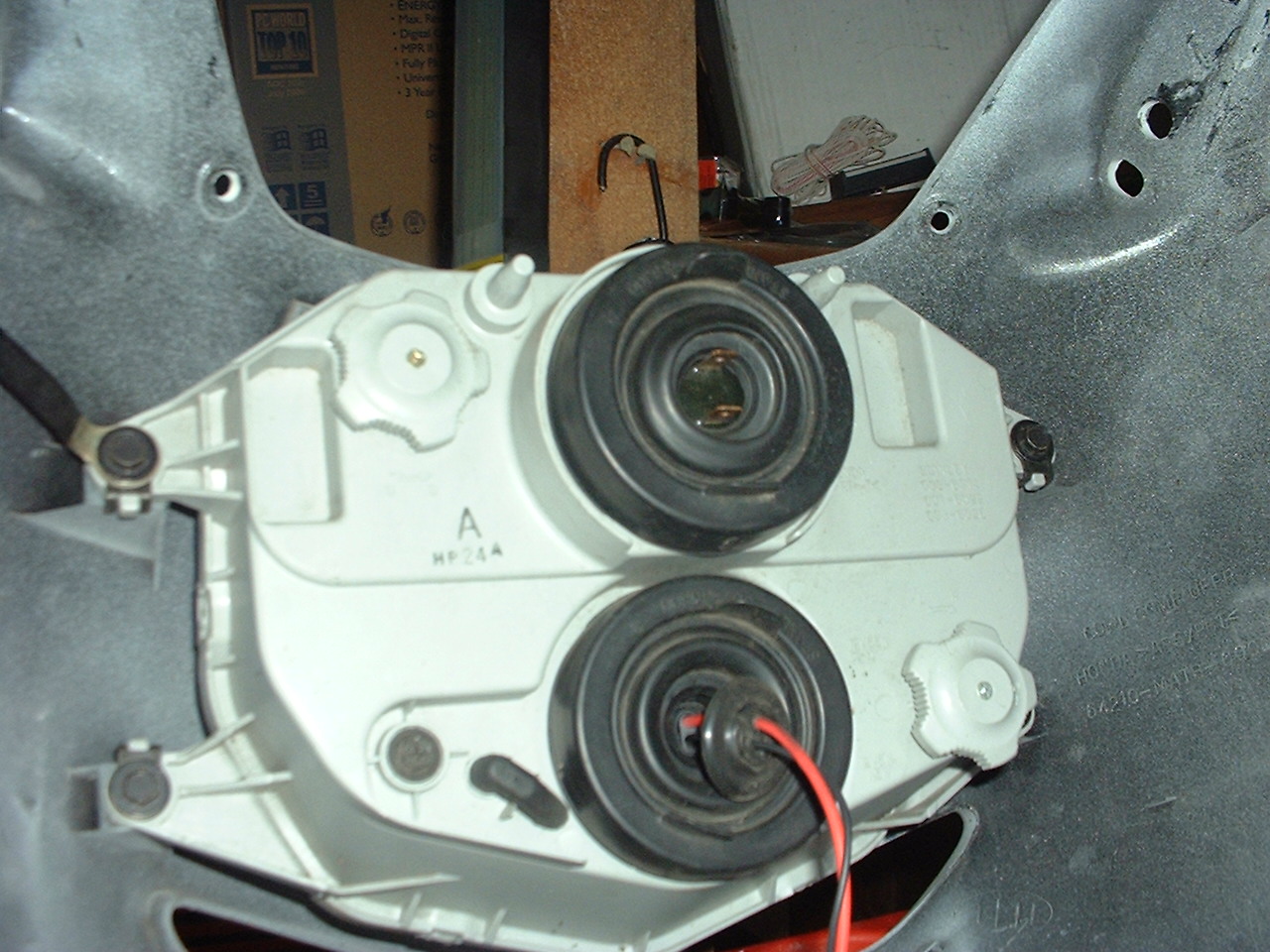

If the ram air tube is not correctly installed, there may be a bit of flex in your front cowl...enough to slightly re-aim the headlight. I wouldn't reset your headlight until the first condition is corrected. However, should you feel the need, here is a picture of the back of the headlight mounted in the cowl just as it sits on your bike.
The left knob moves the beam vertically...clockwise = up. The right knob adjusts left and right...clockwise = right. These knobs can be reached from underneath the cowl, and they are very stiff to turn...in order that they hold their position once set.
