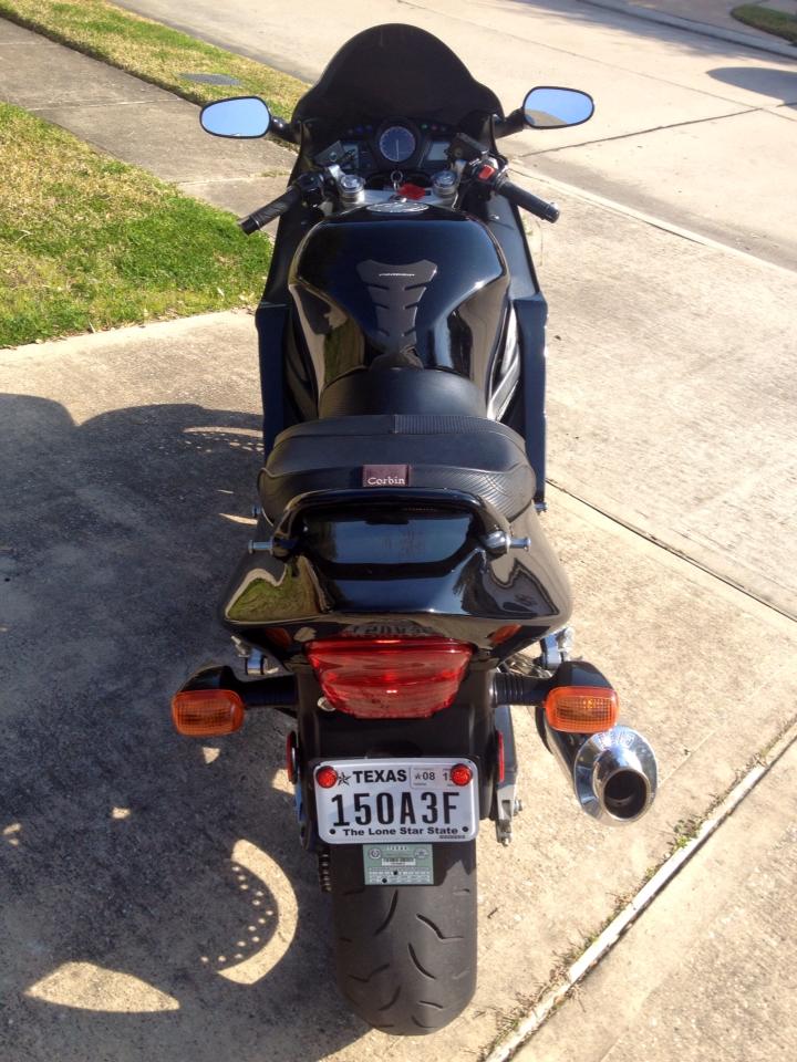

Sale pending

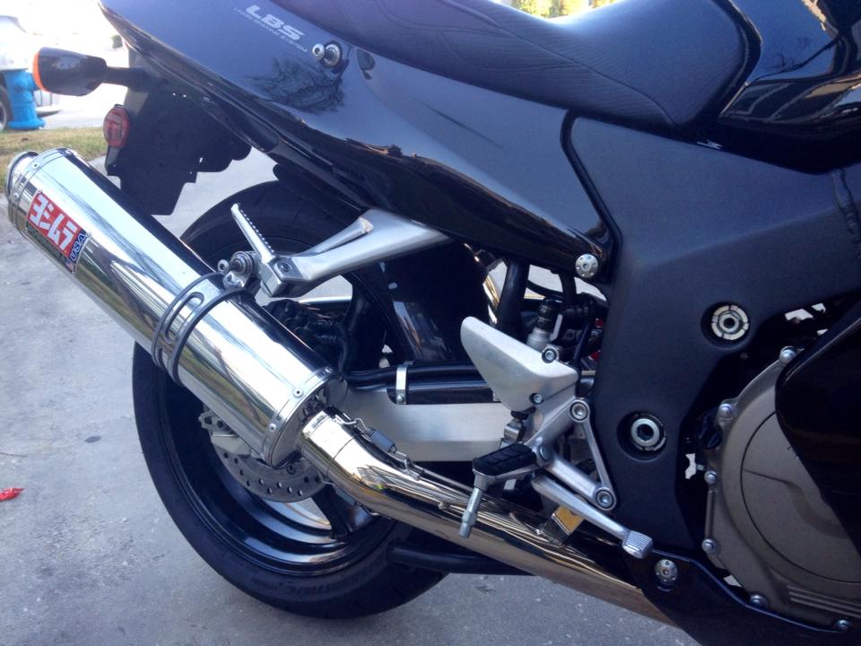

nice bike, looks clean
that isn't a full exhaust, but a yoshi slip on exhaust, full exhaust would include replacment of header also. Not to be a dick or anything but might help you have a better description of add ons if you post it on craigslist and the like.
good luck with sale
Those are multiple photos of the bike through its progression. I had Stock exhaust then delkevic slip ons, and finalized with a Full Yoshimura. I wasnt aware I had to list the history of changes to sell what the bike has on it NOW.
My list is as detailed and structured as it gets. So thank you for your criticism, noted...and the like. Enjoyed your quote in your signature btw.
that isn't a full exhaust, but a yoshi slip on exhaust, full exhaust would include replacment of header also.Look at all the photos. I see three different exhaust in them. The first shot would be the full Yosh.
^ Thank you for being able to decipher through that.
Thanks gentlemen.
$275 shipped (lower 48 states)
Delkevic 350mm Slip ons (500 miles) $275 shipped (lower 48 states)I went Full Yoshi, no need for them.
