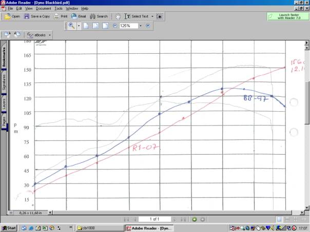

  5. The Bird was dynoed today. It gave 153 rwhp on a dyno that reads about 10 % less than a Dynojet 250. Even if that was said to be verified on several engines, it’s hard to believe that it would read 153*1.1= 168 rwhp on a 250 dyno. The bike is terribly strong though; it raises the front wheel some from ground on third gear The recent power is the thin upper grey line, blue line is stock and red line is Yamaha YZF R1 -07 from www.sportrider.com dyno graph. Dyno_Blackbird.pdf
