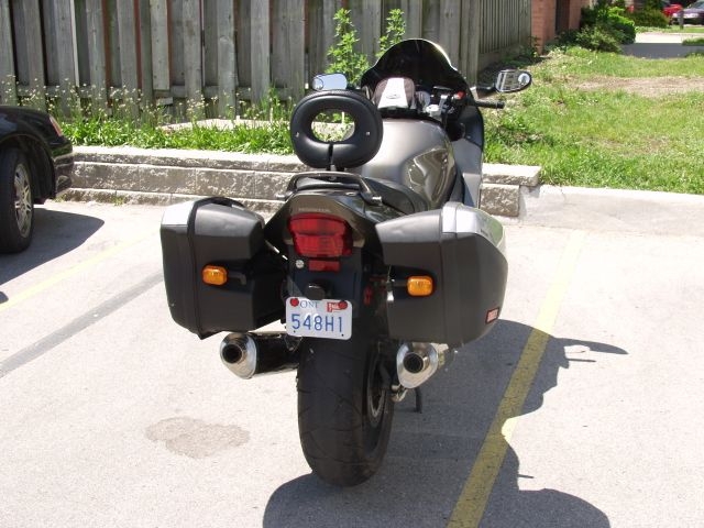

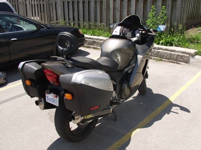

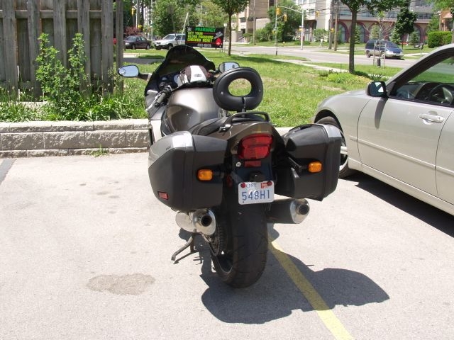

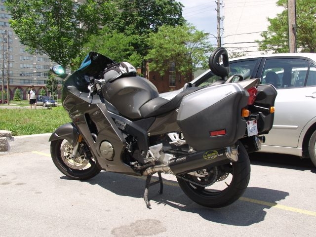

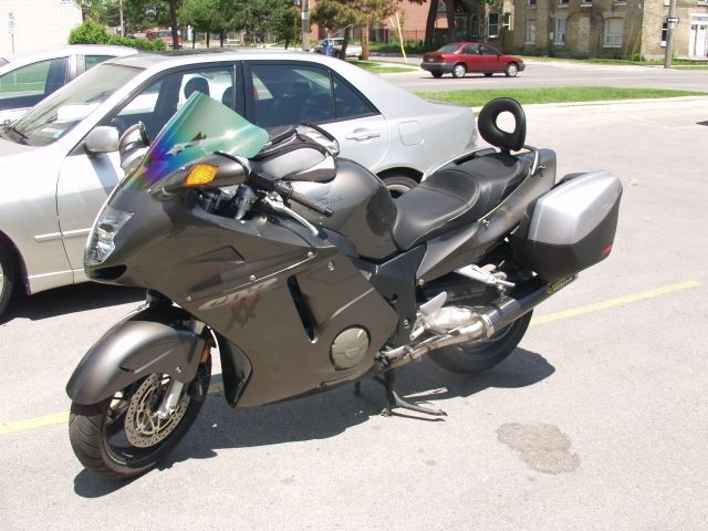

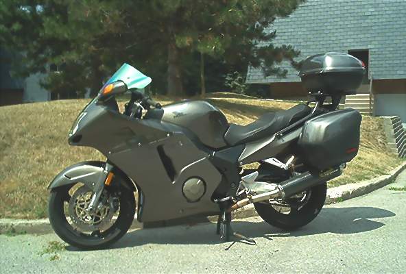

[attachmentid=1215][attachmentid=1216][attachmentid=1217][attachmentid=1219][attachmentid=1220]Hi Guys, here are the photo's of the latest mod.
It took a little cutting here and there but I think they look good, what do you think?
I had to extend the brackets from the top of the rack by 4", I used flat stock drilled it for 6ml bolts top and bottom, drilled the frame and bolted the rack on.
For the bottom bracket of the rack all I had to do is cut bushings 2" long and bolted them on where the exhaust would normally be bolted on.
The ST bags have a two bolt bracket at the bottom which allows you to bolt the exhaust on the bottom of the bracket. I had to have the local exhaust shop cut a small V out of the bottom of the exhaust, bend it down so the exhaust clears the bottom of the bags and weld with stainless wire.
When the exhaust was lowered the centre stand touched it a bit so I heated the centre stand arm and bent it just a bit for clearance.
Now all I have to do is get rid of the ducatti stickers and paint the covers.
Mark

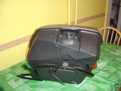

F...K your lucky you got the ducati mounts to . Can i see a pic of the mount without the bag on it . Can you tell me what the mount is made off ? Alum ? Steel , Plastic ?. Just check it with a magnet . If it is steel it should not be that bad of a job. If its alum it would be that bad if one could weld alum .
I'm curious if you would mind teling me what you had to pay for them.
Pics of my givi mounts. I always intended to redo them in stainless, but they work, so i havn't bothered yet.
Nice job on the racks Herb,

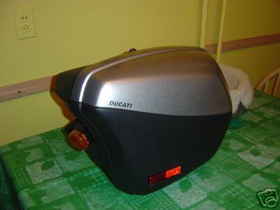

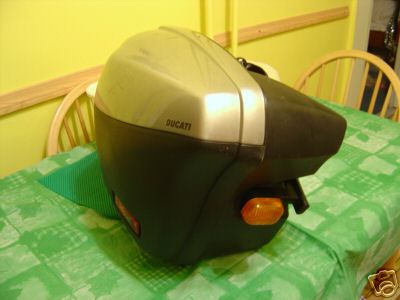

I haven't got the bags home yet, just bought em on ebay for $300. As soon as I get them home I will post some photo's of the mounts. I think the mount is steel but I'm not sure. Good thing I have a professional welder for a brother isn't it
I think we should be able to fix them up. I'm hoping not to have to lower the pipes. Bags look pretty good don't they, just have to scrape of the lettering and they should hold lots more than beetles would. I will send more photo's when I get some...Mark

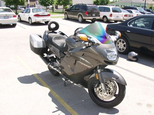

Well I did it, thanks to a lot of info posted here. I installed a set of 03 VFR bars on my 00 bird. left them up about a half inch above the top of the fork tubes. Went smooth as silk. Also installed a new irridecent double bubble screen, which gives the titanium bird just a little bling. The combination of the higher bars and the double bubble is great. The screen blocks wind around the helmet and at the same time allows wind in to the shoulders and provides great body lift off the bars. Thanks again for all the great advise in previous posts.
