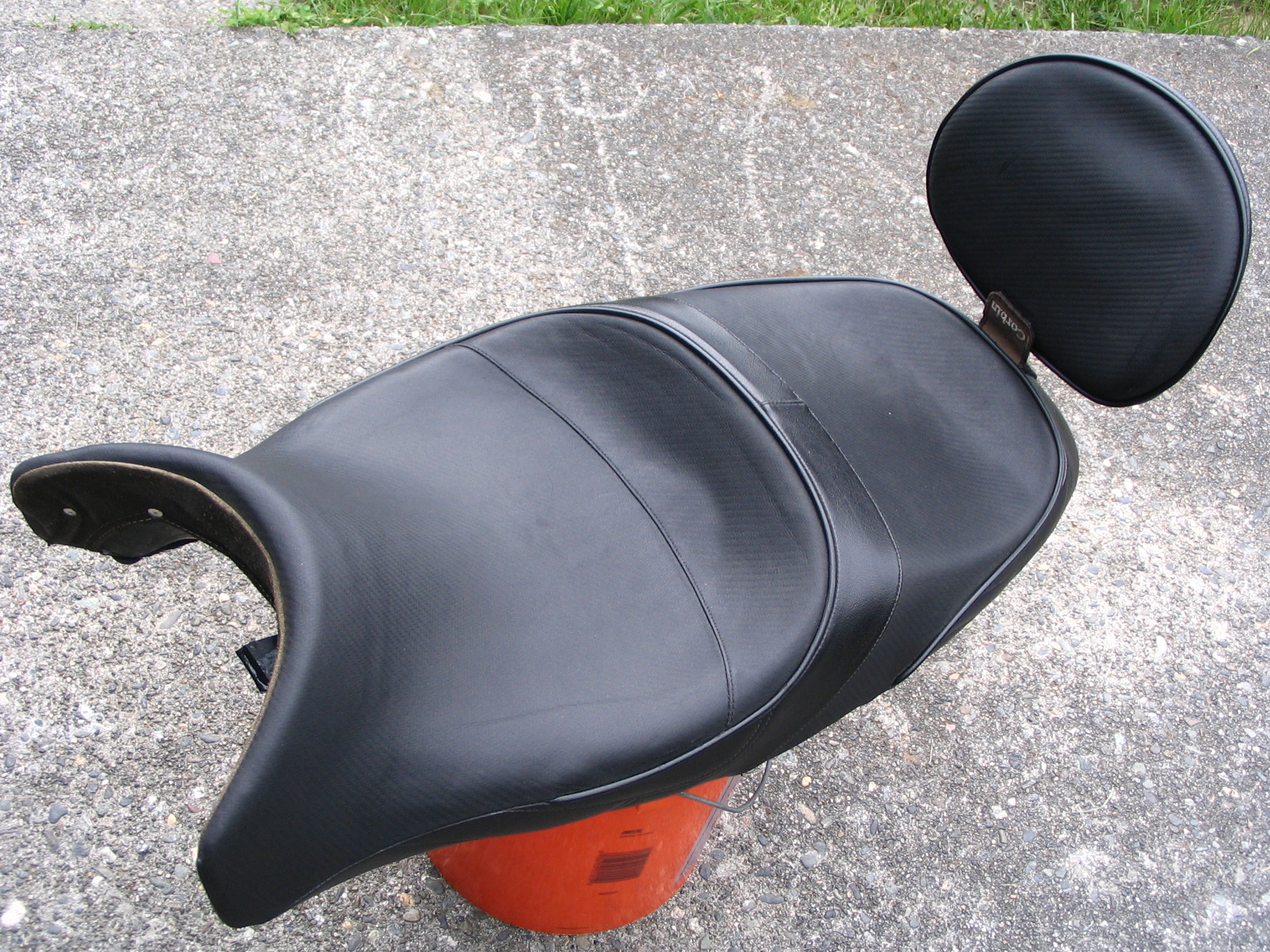

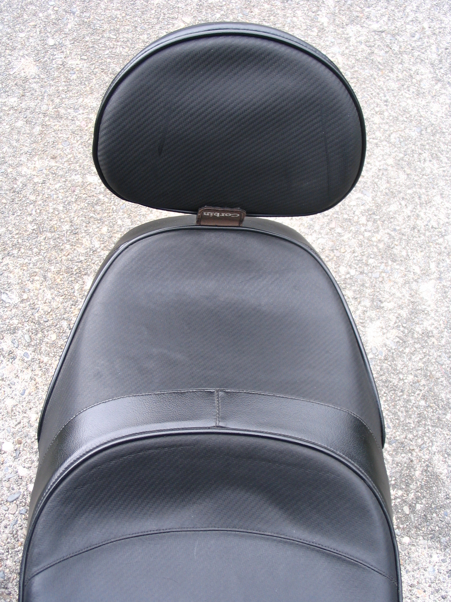

Corbin Gunfighter and Lady Seat with Backrest for Blackbird. $325 + shipping SOLD SOLD SOLD

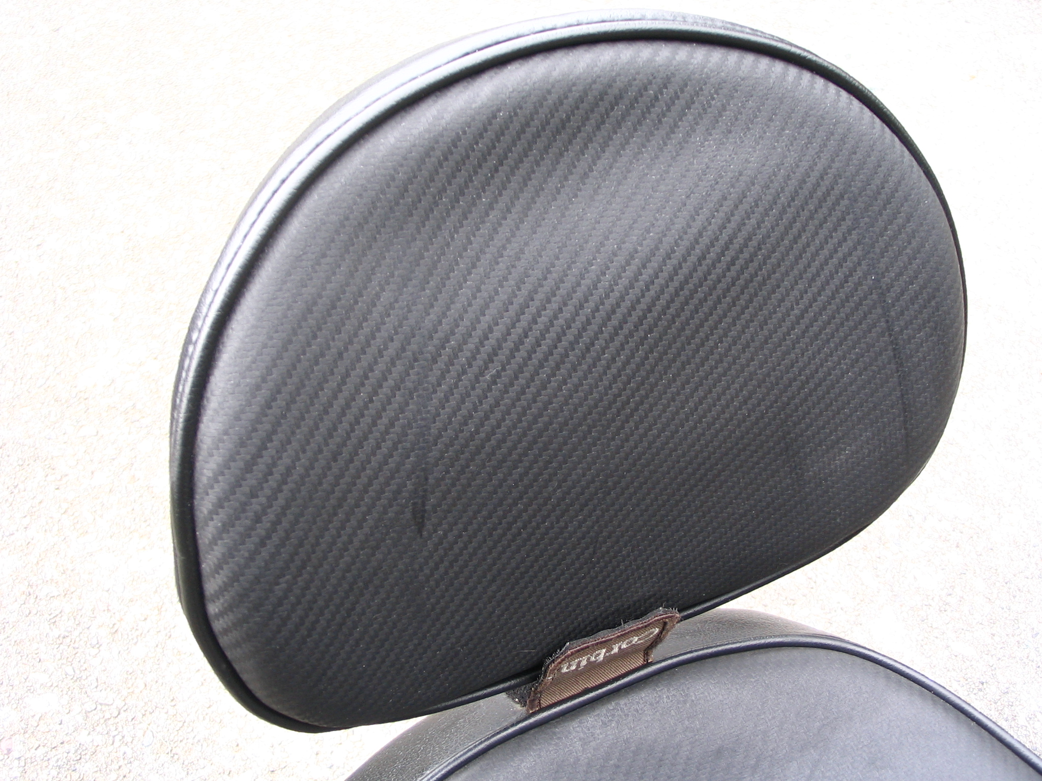

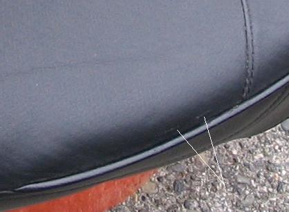

It was on my ’99 XX. It is covered in the Carbon Fiber pattern leather. It is in very good condition. I have used Lexol to condition and protect the leather. It does have two ½ inch scratches shown in a close-up picture. The scratches do not go through the cover and are not noticeable unless you look close-up. Also, the back pad has some marks on the cover from compressing it with a T-Bag elastic mount. Retail price at Corbin is $439 for the seat and $229 for the backrest. Paypal is my preferred method of payment.
The seat is ready to ship in a 32”L x 12.4”W x 18.5”D box filled with packing peanuts. The box weighs 18lbs. My zip code is 98270.

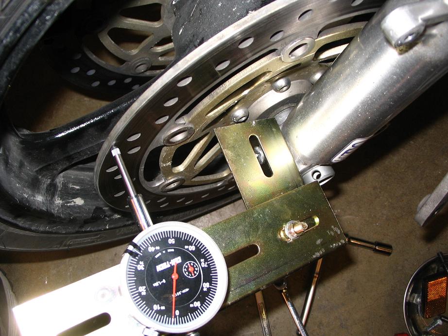

Boy it is easy to move those carriers. I used a rubber mallet and a 3/4" dowel. I gingerly moved the rotor back into place by tapping on carrier arms as needed. I will have to describe it better later. Got the wow down to .0025in at the worst area.
I did take it for a ride tonight and it seems better. The road was wet so it was kind of hard to tell if I was locking up the wheel on hard stops. It is better, not perfect but better. Thanks for the suggestions guys!
Most can be straightened by hand. I use the move it twice the amount bent. Find the middle, or maximum bend and move the correct way. Not as hard as you think.
Let me know, and go in small steps. start with a little and work up to the amount I said. If it is bent 20, move 10 and see if it comes back to 15. Make sence?

I wouldn't turn the rotors, bend 'em back into shape. Usually the rotor isn't warped, rather the carrier is bent. It's not hard to bend the rotor carrier, happens way too often during tire changes. Which may explain why only one of yours is bent.
So I should use my rubber mallet near the carrier to tweak it back. I will try that. Oh and I did change my own tire, but that was a while ago and I didn't notice the pulsing in the rotor until recently. But I am sure I could have bumped it somehow.

I posted over in the garage about finding I have a bad rotor on the front right of my '99XX. Anyone have a spare rotor they want to sell? My rotor is .193 in thick. I assume if I mix another it should be close to that.
Or, anyone have a line on the best price for some Galfer wave rotors?
I recently had my front wheel off as I had gone back to the stock springs in my forks. I lost weight and my gpsuspension modded forks had too stiff of springs. On my test ride in noticed a strong pulsing / shudder in the front. I had not noticed this before, so I assume I must have somehow bent, or dinged my left front brake rotor. I don't know how this happened as I was very careful with the rotors.
I had a ZX11 that had similar symptoms that I had to replace rotors on, so I was pretty sure I had a bad rotor. I had a Harbor Freight dial indicator left over from that issue a few years back. I fashioned up a ghetto bracket to mount the dial indicator. A picture is attached.
The runout tolerance in the manual is .012in. The left rotor measures at .002in, but the right had a big .020in wave. And both rotors are .193in thick, the limit is .16in.
So my '99XX right front rotor is shot. My first thought is to see if anyone has a spare rotor they would like to sell. I assume either side will work. My next thought is some Galfer wave rotors would be nice too.
Any suggestions?
