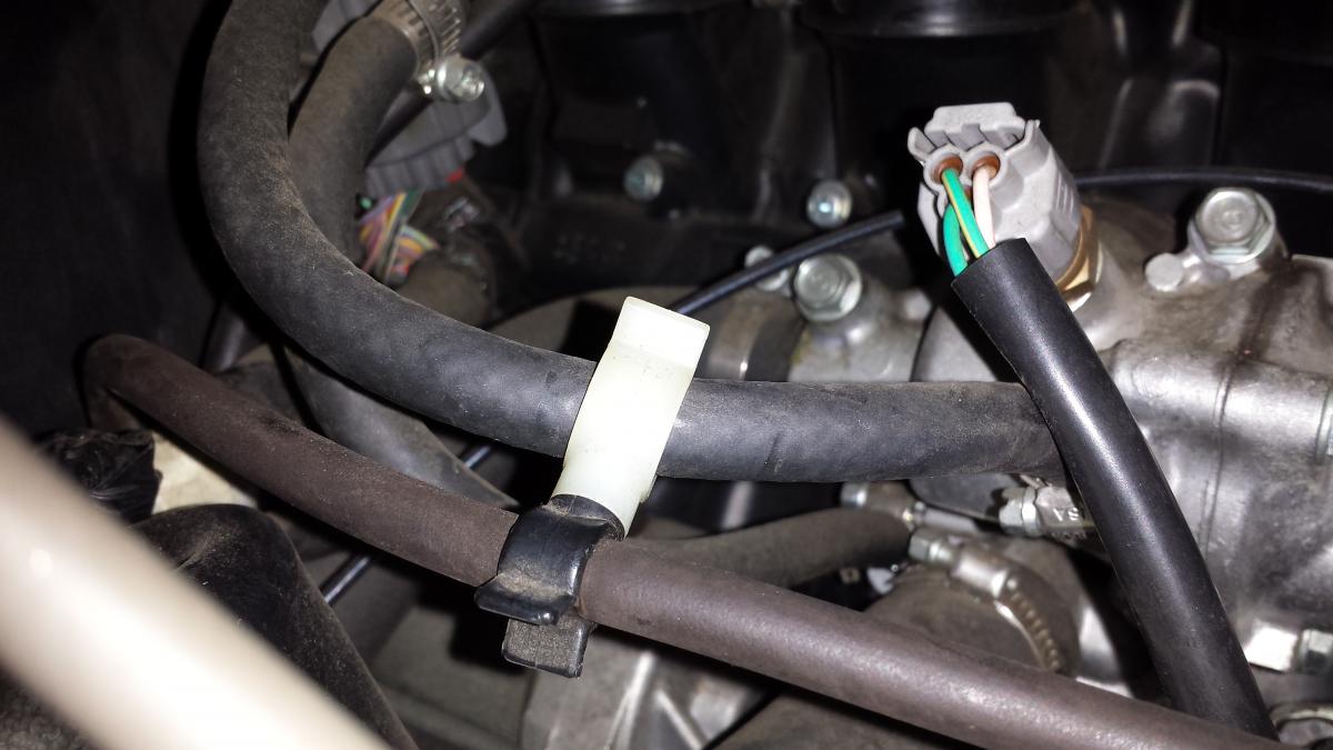

  4. the day after filling the tank, of course, I went to start it and it started ok and ran for a few seconds then dropped to maybe 1 or 2 cylinders then stopped altogether. In the last 12 months it's spluttered occasionally so I've been running injector cleaner through it. So when it died completely I was hoping it was just the fuel filter blocked, pulled the filter and it seems to flow fine. Everything looks fine, no loose wires or fuel leaks, recently I've replaced the air filter and low beam headlight bulb but I can't imagine that i've caused any issues doing that. There is a breather hose not connected to anything but I can't find anything it would have been connected to. the thinner hose in the bottom of the pic.

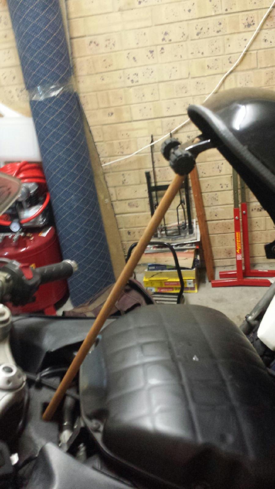

  7. my manual seems to only cover the carbed models, i can't see any quick release connectors on the fuel lines. i just want to replace the airfilter, tried a search in the garage and youtube no luck.
