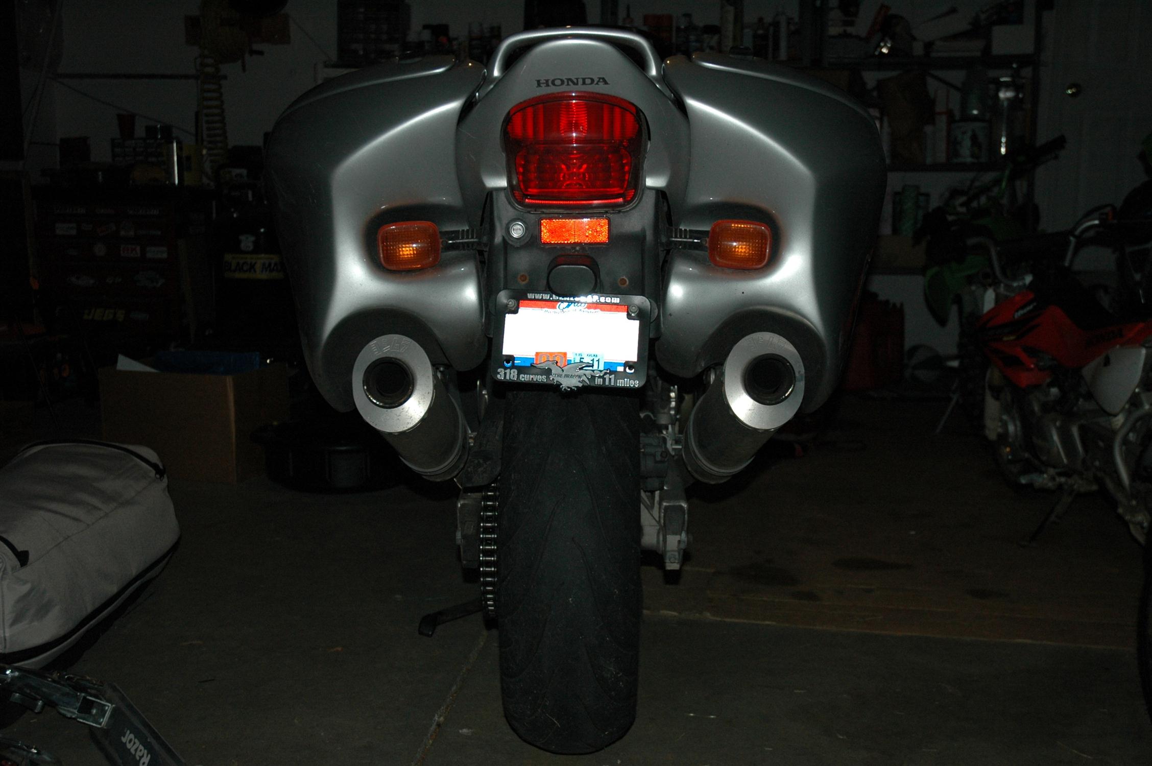

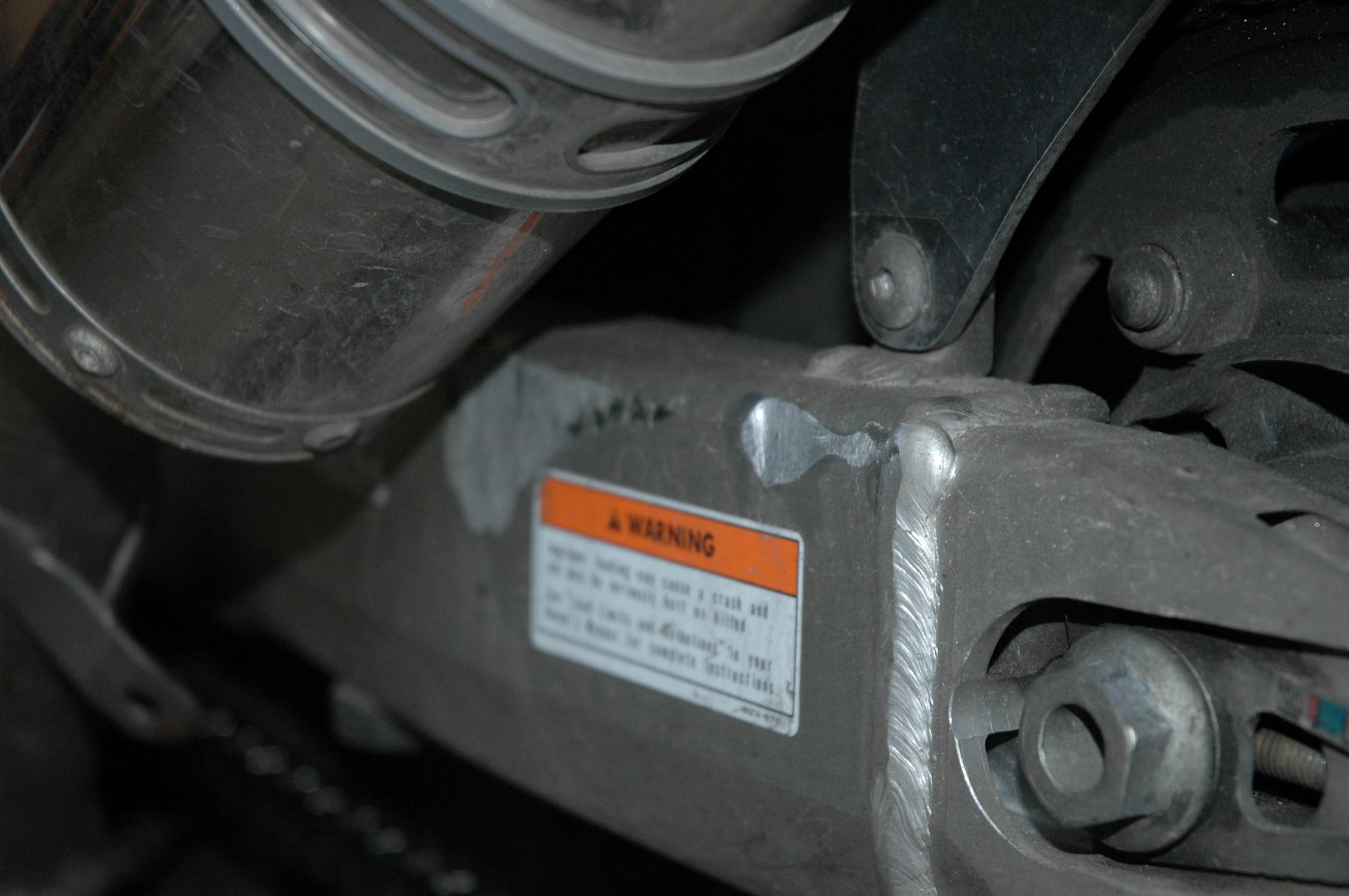

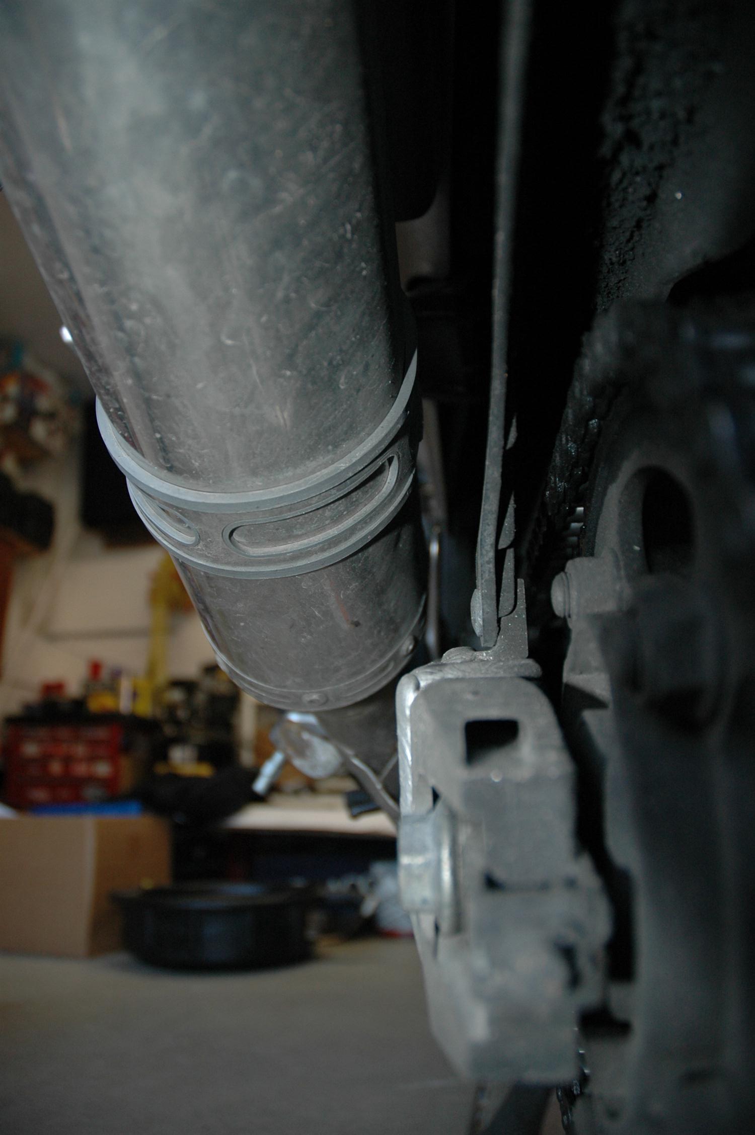

SoloTSi97 Posted July 7, 2010 Posted July 7, 2010 Nothing looks bent, but it's pretty clear that there's been a lot of contact between the swingarm and my Yoshimura exhaust. The wife and I did a 2-up trip a month or so ago, during which I made a mental note that I really need to have the suspension rebuilt, and I haven't ridden it much since due to battery and flat tire issues. But, as I was taking the back wheel off to change the tire, I was surprised to see how much metal has been worn away on the swingarm, apparently from the exhaust rubbing. I took some pictures of the rubbed areas on the swingarm and also tried to take a couple so y'all can tell me if something looks bent or just not quite right. The bike hasn't been down in a year or so, and even then it was a right-side tipover. This problem is on the left. The suspension is certainly overdue for service ... is it simply a matter of the fact that my 220lb. @$$ is asking too much of a tired old suspension and things shouldn't get as close as they are? Thanks!! -Bob Quote

The Krypt Keeper Posted July 7, 2010 Posted July 7, 2010 might be your mid-pipes. I had to adjust my left side mid pipe just right so it would give me Leo Vince ehaust the correct clearance on the left side. The Right side like mentioned has no issues at all. Try rotating your mid-pipe some and see if it helps you. Quote

SoloTSi97 Posted July 8, 2010 Author Posted July 8, 2010 Thanks for all the suggestions! Turns out it was that the midpipes had turned, which forced the cans (on both sides) in toward the swingarm. There's more clearance on the right, so it wasn't rubbing, but both were tweaked inward. I suspect that it was a combination of doing a long round of 2-up riding recently and having a bunch of stuff in the beetle bags. After I got to looking at the pics I took of the bike from the rear, it is clear that the beetle bags were tweaked inward and rubbing on the fender. I've been thinking about taking them off anyway, so off they came and I twisted the midpipes back into place. All is well now, and she's thinner than ever! -Bob Quote
