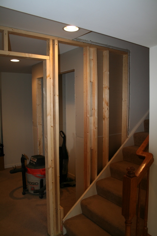

For years we sequestered the kiddos in the basement. Which meant it looked like an explosion in a toy factory. But the little bastards are growing up, so I decided to reclaim the basement for adult space. I've been working on it for about a month now. Here's the progress so far:

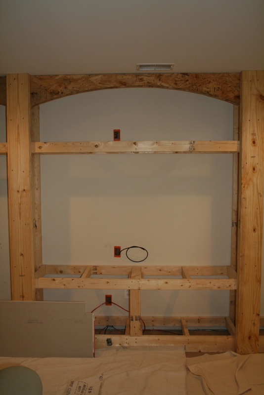

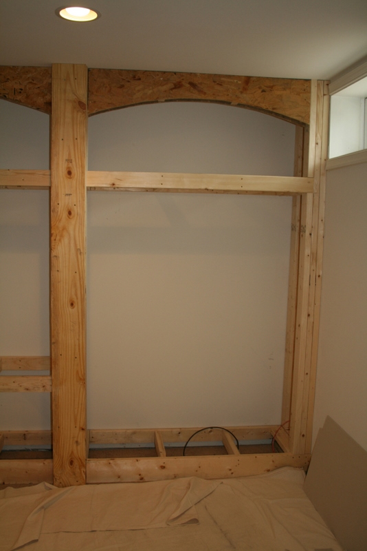

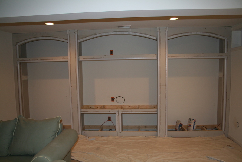

1. I'm converting a 16' wall in this bump-out area into a built in entertainment center. A piece of furniture this big would cost thousands. Much more than I'd spend, so there's that. Plus I like the integrated look, well when it's finished. The top part will be ambient lite with LED rope lighting. All the wiring for the home theater is internal.
Framed

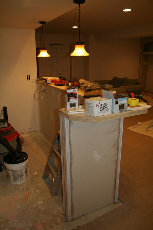

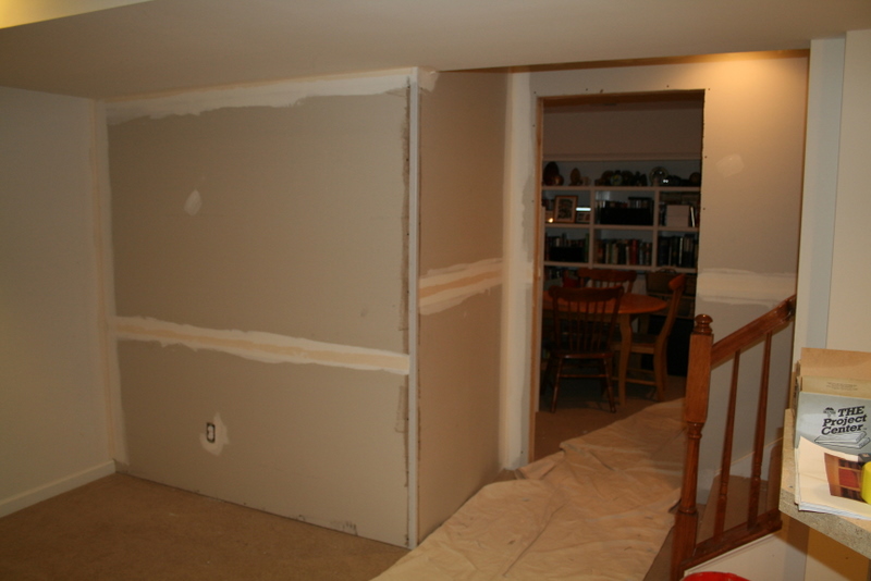

Sheetrocked, partially mudded, corner beads set. You might be able to notice the 3/4" rounded corners.

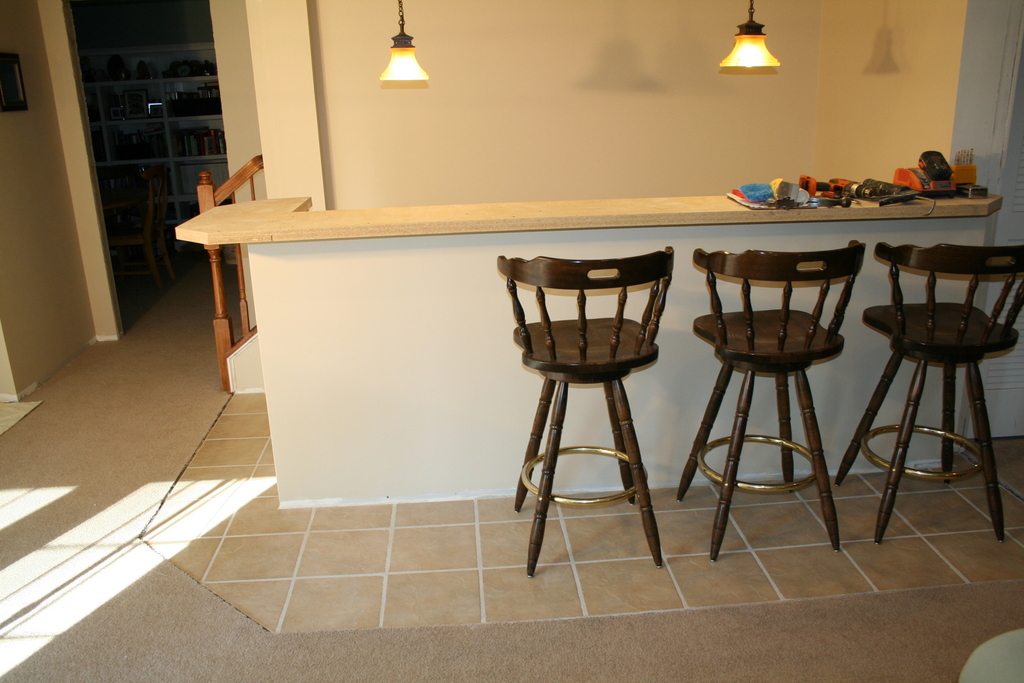

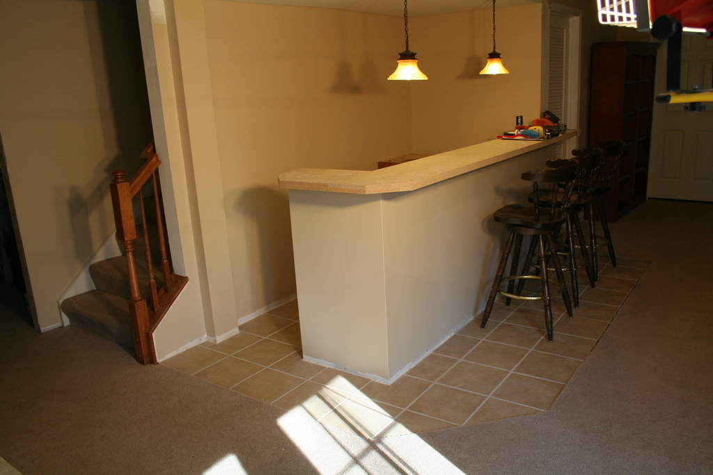

2. Facing the entertainment center is a bar. Not much to look at now. But eventually the floor around the bar will be tiled. The countertop might be solid hardwood flooring or tile, or something else. Suggestions? Inside the bar there will be two outlets, a two bowl sink and cabinets. I'm refurbishing some solid oak wall cabinets that will be used as shallow base cabinets inside the bar.

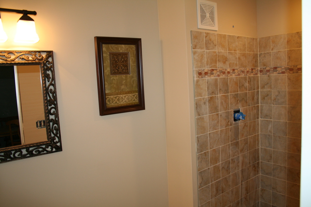

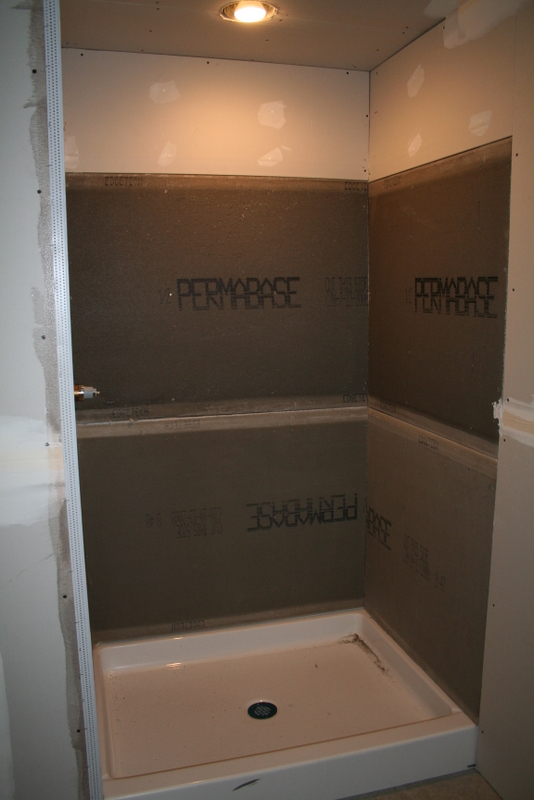

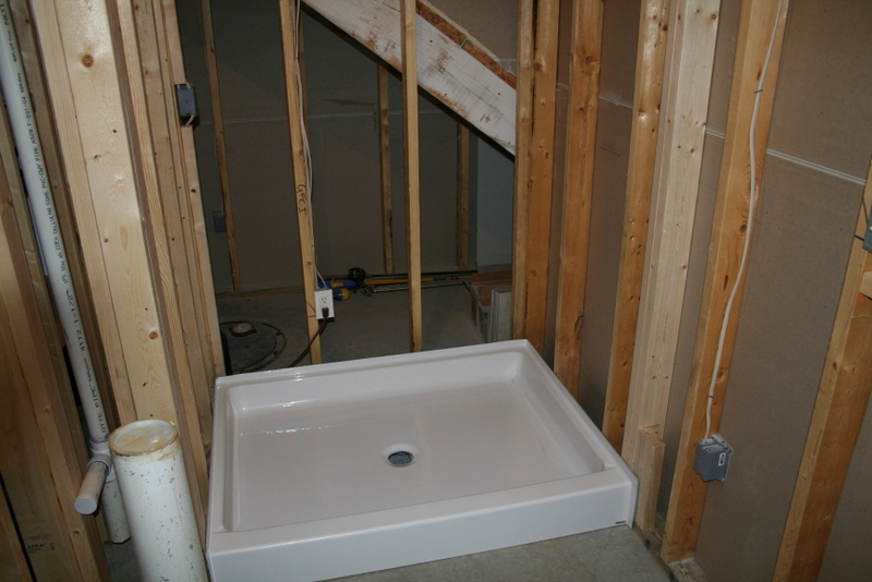

4. Finally I'm finishing a full bathroom that's attached to the new walled-off room.

Thank You, In retrospect I should have created a mud bed. The drain in the foundation did not line up with the shower pan (of course), so I had the extra joy of chipping away part of the foundation and moving the drain. With a mud bed I could have made my shower drain over the existing drain in the foundation. Funny how I think of this stuff after the fact.

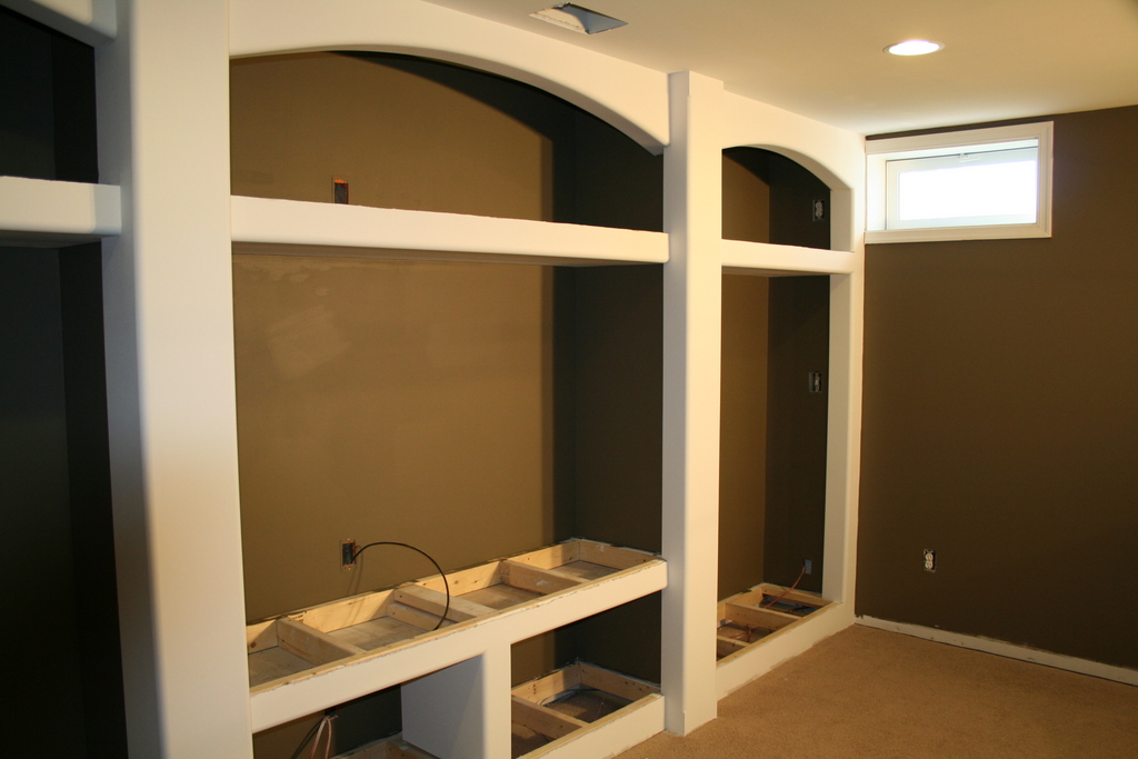

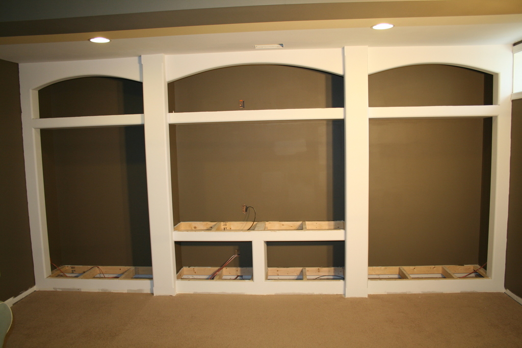

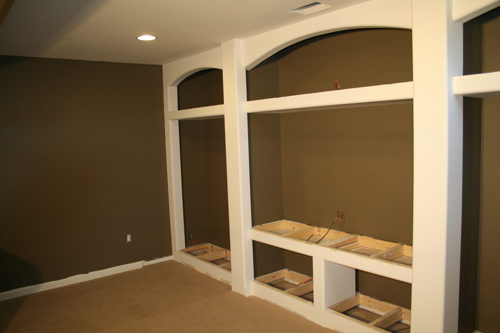

I finally finished mudding and sanding the entertainment center. Here it is primed and painted. The next step will be adding hardwood shelves and trim.

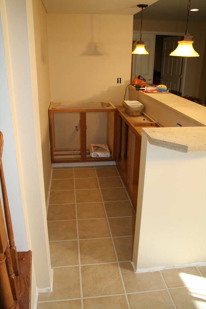

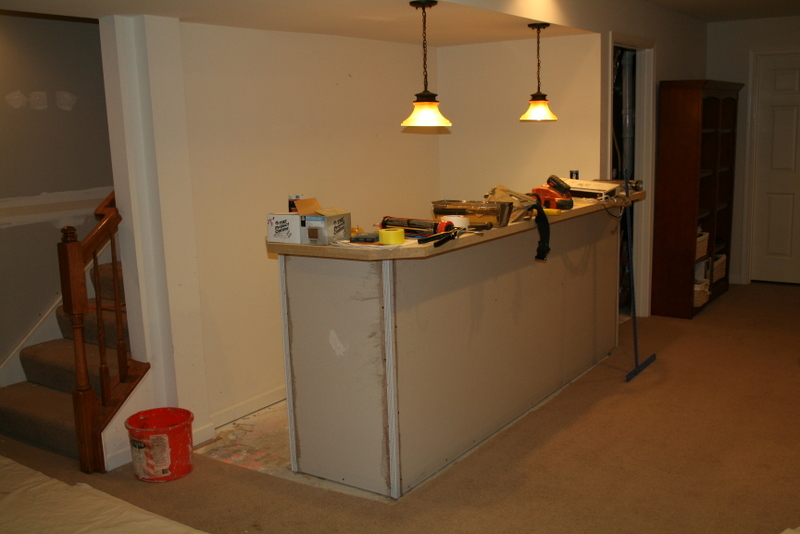

Finished mudding and sanding the bar as well. Also installed the tile floor and built the inside cabinets. Countertops will be done next.

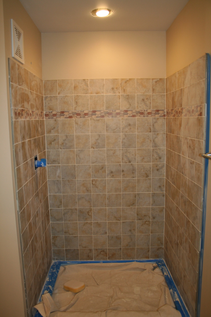

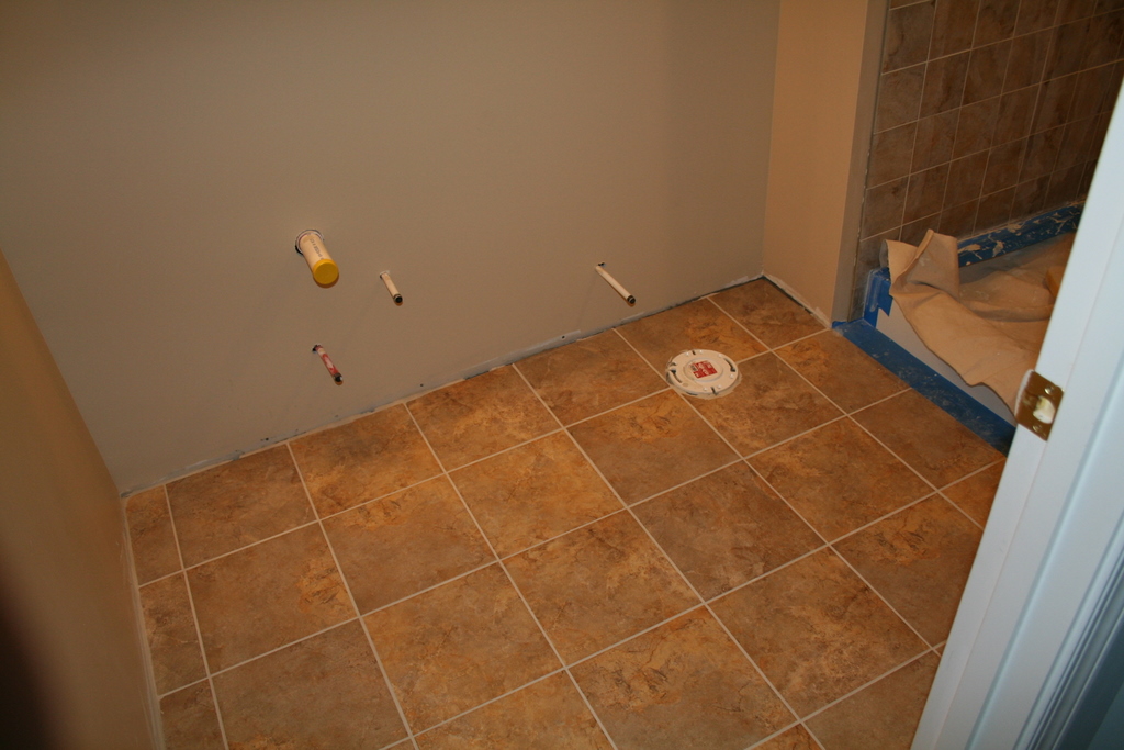

Drywall, paint and tile are done. Installing baseboards and fixtures will be next.
In the bathroom, my wife has gotten a little ahead of herself and put up decorations.
