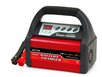

- I bought a Vector 1089A battery charger/desulfator a while ago to maintain the batteries of my 2 bikes: the XX and a Suzuki DR-350. It was about $80. The 'desulfator' function is supposed to use high frequency pulses to shake loose and disolve the sulphate collected inside the battery to restore the performance. The way it works was to attach to the battery, start the 'desulfate' process by pushing a 'recondition' button and it runs for 24 hours before it turns itself off. After desulfation, the battery is recharged to full. It kind of works but not very well. Before desulfate-and-charge, my batteries were measured about 12.5V even after a full recharge. After desulfate-and-charge, they showed about 12.65V so there was a little improvement. A new battery fresh from the shelf was measured at 12.9V.

Did you run a second desulfating cycle with the Vector device without any improvement before you ran a cycle with the Batteryminder?
Yes, I did. I have the Vector for a couple of years. I have run the desulfation cycle several 24-hour back-to-back but the best it could was to bring the battery to around 12.6-12.7V.
