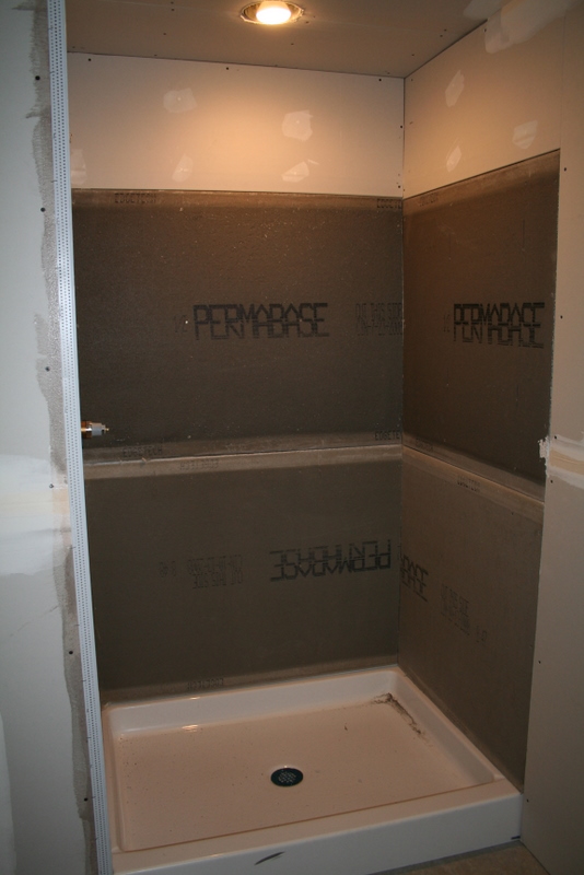

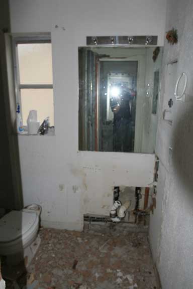

John01XX Posted August 31, 2008 Posted August 31, 2008 Basic 5 X 8 Full bath with a shower. Previous owner decided to remodel the shower and made it about 6 inches wider which placed the step-out right up against the toilet ?? Also there was no shower pan used so there is alot of water damage. Fortunately two of the three shower stall walls are exterior concrete block walls and the house is on a concrete slab so only one wall was shared with a walk in closet that has to be replaced also. The two walls pictured that are not torn out are the exterior walls. I am leaving for NeXXt tomorrow morning so got done today what I could. I have not even closed on this house yet but will close the day I return from NeXXt !! Already have the Utilities in my name and anxious to get it done so I can start moving in next month. Will use the second bath until this one is done. Also having trouble getting the toilet un-stuck from the floor so I can reuse it. Seems like it was grouted in place. Any suggestions for safe removal ? . Quote

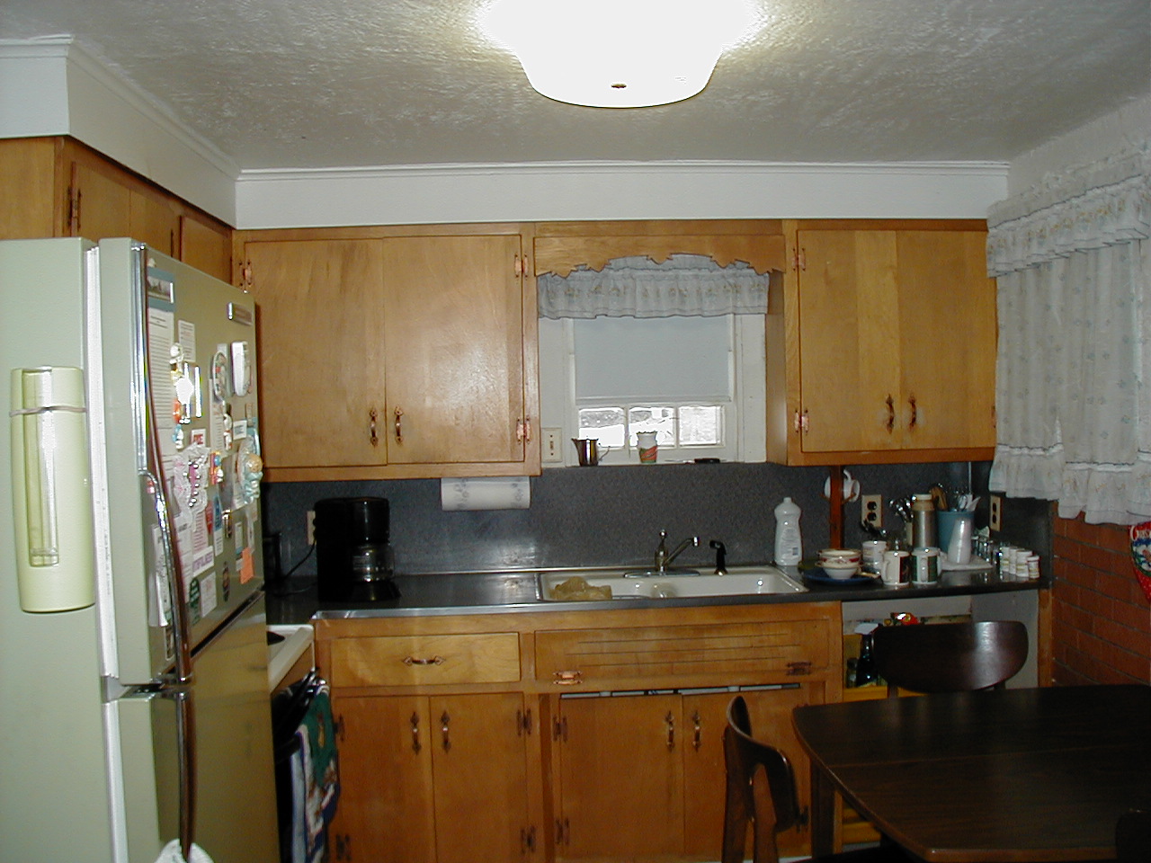

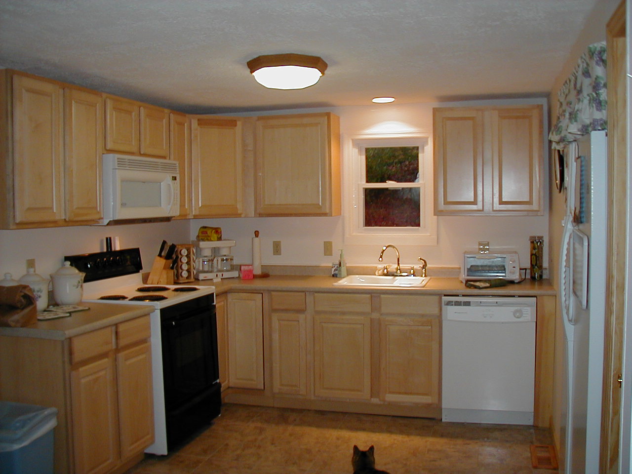

googus Posted August 31, 2008 Posted August 31, 2008 Boy I remember those day!@! I did that to everyroom in my house This was my kitchen project Total cost 4624.18 and 3 months Greg Quote

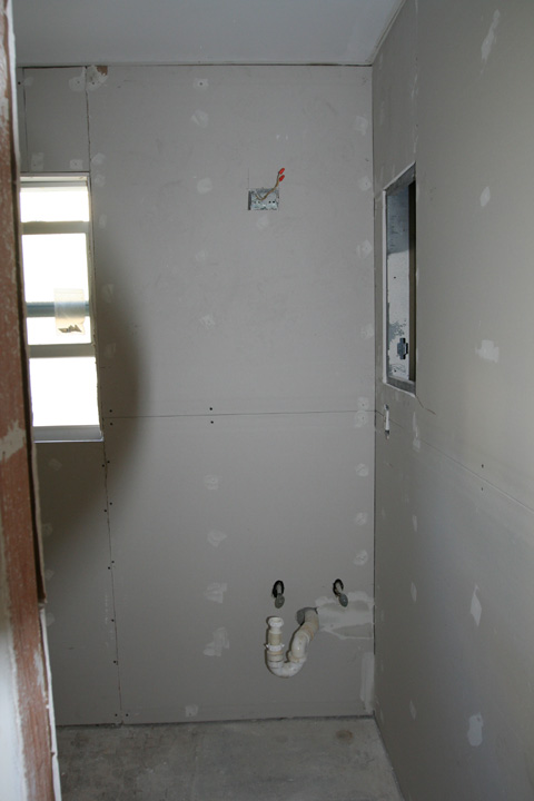

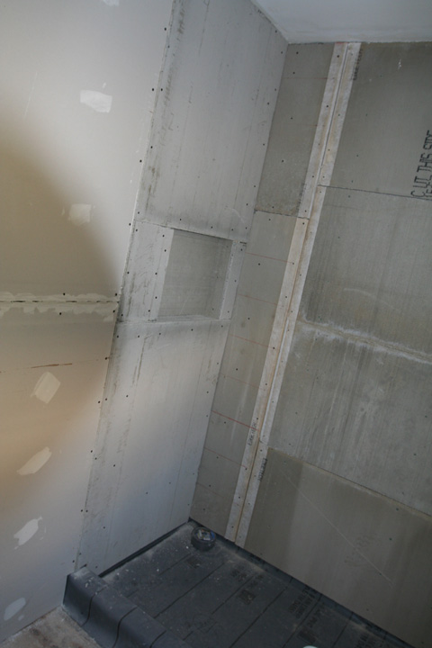

John01XX Posted March 14, 2009 Author Posted March 14, 2009 Anxiously waiting on a very nice income tax refund to be deposited in my bank account. Since I bought a Foreclosure as a first time home buyer in 2008 I qualified for a $7500.00 tax credit !! Finally going to be able to finish my Bathroom and master bedroom remodel. Should have the needed money in less than 2 weeks now. I did get the walls sheetrocked. Now to finish mudding it all in and prep for the new tile. Going to tile floor to ceiling in the wet area and tile up 42" the rest of the way around the bathroom. Adam, beondwacko, came over and installed a new shower light for me, thanks Adam. Hopefully will be done next month Putting down tile in the Bathroom, short hallway and 5' x 6' walkin closet as well as the floor of the linen closet. Then new carpet to go done in the Master bedroom. Picture to follow as I complete the tile work. Quote
MrBadExxample Posted March 18, 2009 Posted March 18, 2009 I qualified for a $7500.00 tax credit !!Socialist! Who do think that money is coming from? Rich taxpayers, that's who. It might not matter, but you installed the backer board 90 degrees off. The taped, recessed edges of the sheets should butt against each other to make a horizontal joint. The recessed edges are to accommodate the mesh tape and mortar. Otherwise there will be a bulge when you tape/mortar the joints. And if you install the backer board horizontally you would have had much few joints. Lots of joints, Horizontal joints not recessed, creates bulges when taped/mortared. Compare that to this installation: Quote
John01XX Posted March 18, 2009 Author Posted March 18, 2009 I am learning as I go and have never done this before. The durarock that is in the wet area was given to me free and was not a full size board so had to have more seams than normal. I am tiling floor to ceiling in the wet area and 42" up the rest of the way around the bathroom. The tax credit has to be paid back over 5 years, so not actually free money just a free loan that enables me to do a couple home improvements that I need done now Quote
BDAZ XX Posted March 24, 2009 Posted March 24, 2009 I hope you put some 4-6mil plastic behind it as a vapor barrier in the shower. Quote

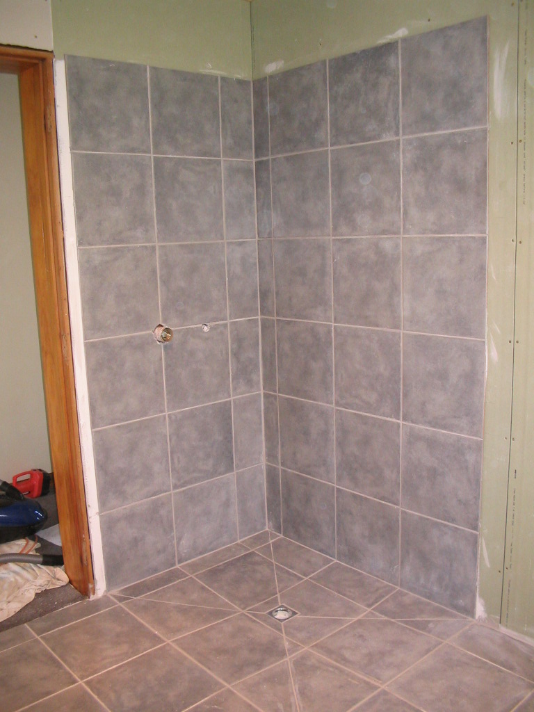

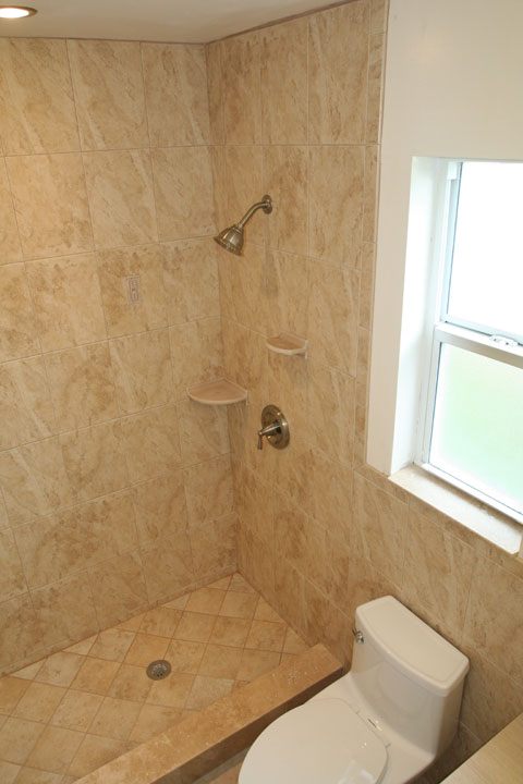

John01XX Posted April 19, 2009 Author Posted April 19, 2009 Got the walls tiled and the shower floor almost ready for tile. Curb ready and the new Hurricane Impact glass window installed. Vanity light and medicine cabinet done. Will be starting on the diagonal 6" shower floor tile next and then the 18 x 18 floor tile to finish Quote
Fonzie Posted April 20, 2009 Posted April 20, 2009 Lookin good John! Looks great John! So when you comin' to do mine?!? Quote

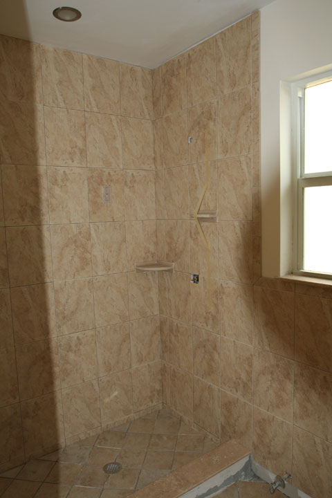

John01XX Posted April 20, 2009 Author Posted April 20, 2009 3 more pics today alittle progress, hope to finish by Thursday Quote
TFT Posted April 26, 2009 Posted April 26, 2009 WOW!!!!! Nice!!! I really like the tile work. The light fixture is great looking too. Nice job. Quote
ndivita Posted April 26, 2009 Posted April 26, 2009 Finally Done with the bathroom Really looks good. Congratulations. Quote
John01XX Posted April 26, 2009 Author Posted April 26, 2009 All of the fixtures, faucets etc are done in nickle finish instead of chrome. I left the chrome for the hardleys ! Quote

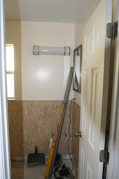

tvking Posted May 4, 2009 Posted May 4, 2009 Looks great John. I like the light a lot. Is it a florescent? Looks like it could be. Quote
John01XX Posted May 4, 2009 Author Posted May 4, 2009 Looks great John. I like the light a lot. Is it a florescent? Looks like it could be. Thank you Todd, coming from you, it means alot. Yes the light above the vanity is florescent. Small twin 22" tubes. I picked it up on sale at Home Depot a few months back when this project first started Quote
