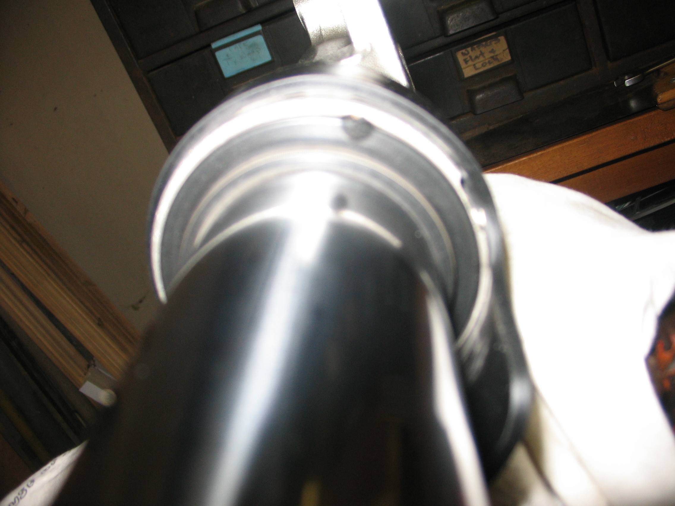

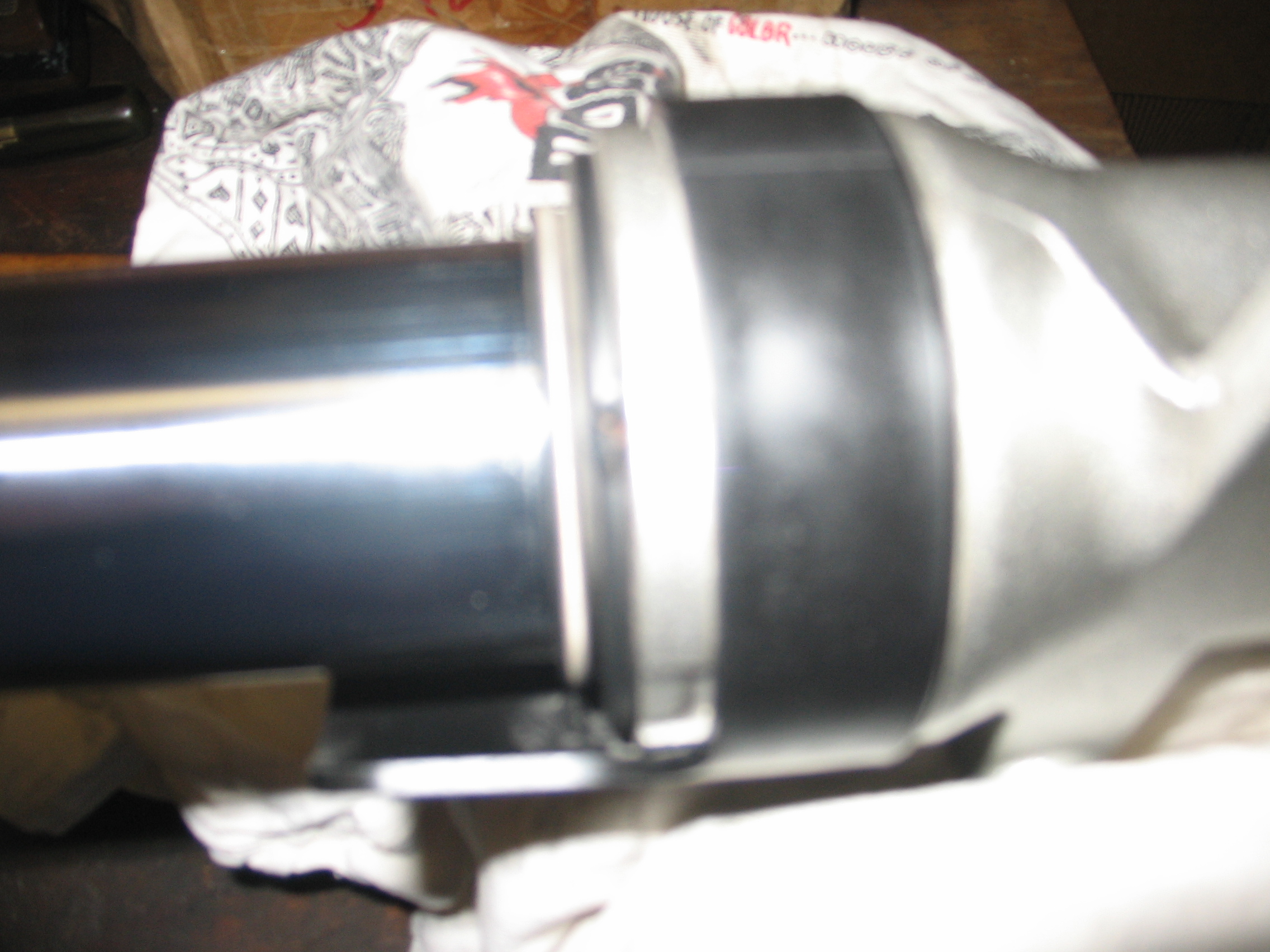

Warp11XX Posted February 14, 2008 Author Posted February 14, 2008 I looked up the spec in the '99 to '02 manual...143mm or 5.6in. I'm assuming all FI models are the same since mine is '03. Now I'm looking at other problems... This really sucks! :icon_thumbsdown: Boo Honda quality... It's not a rock chip or anything since it is on the rear side of the slider. Bike purchased new in Jan of '05. Not quite 35K miles. I wonder if any water has gotten under and started to fuck with the seal? The other side dust cover is also cracking all around the sealing/sliding lip with little tiny cracks that look like dry rot. My camera isn't good enough to get it though with the light in the garage. I purchased extended warranty that should total coverage for four years. I've never had the bike in a shop except for the front brake recall check. Would dealership/warranty cover something like this? Is it worth the pain in the ass to claim or should I just buy dust seals and hope for the best? I'd hate to put it back together just to ride the damn thing to the shop for them to completely re-do the job... Quote

Warp11XX Posted February 15, 2008 Author Posted February 15, 2008 Well I guess it'll be another fuggin week before I can put my sweetie back together. I pulled the dust cover this morning and inspected the seal. No water has actually entered the top of the slider, so the seal and clip are bright and shiny with no obvious problems. I looked up the dust covers and they only go for a bit under 10 bucks. I'm taking the one in the pics with me to the stealership and try to talk them into ordering under warranty just on principle :icon_snooty: . If they won't do it I'll just get even later since I rep for them as a class sponser for the local MSF program. They probably shouldn't piss me off...pay me now or pay me later their choice. Quote
