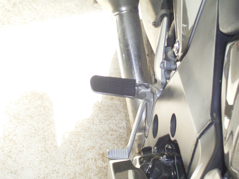

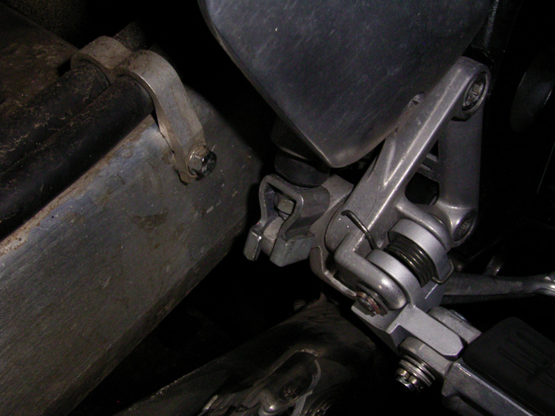

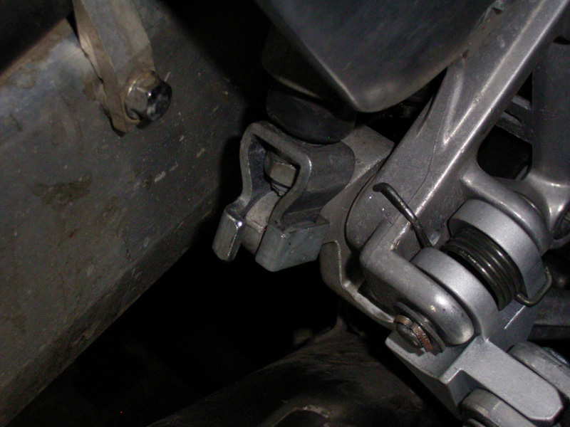

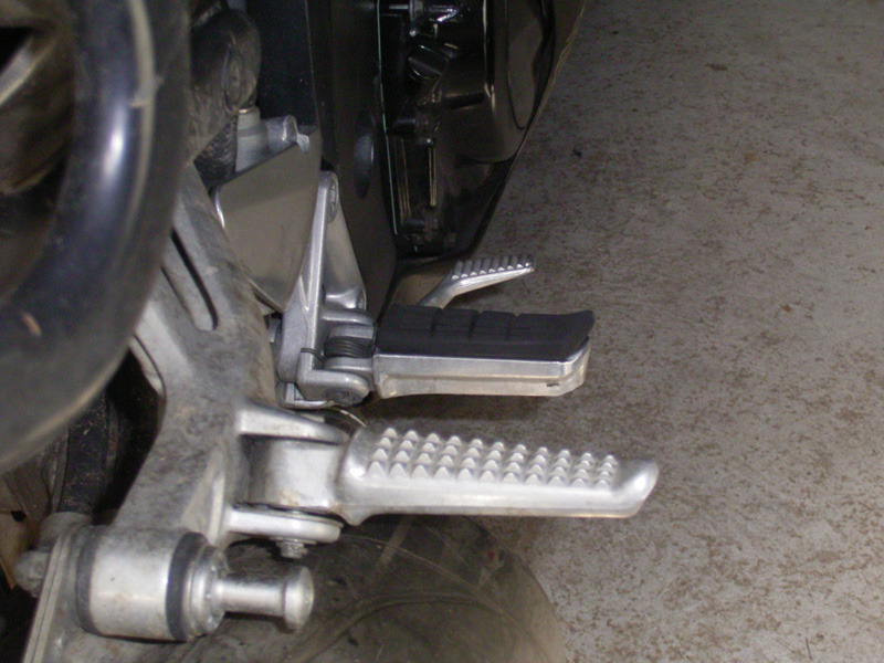

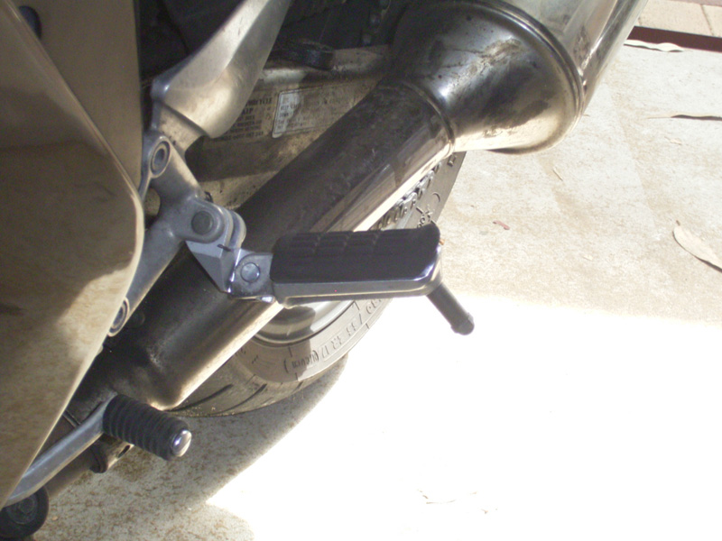

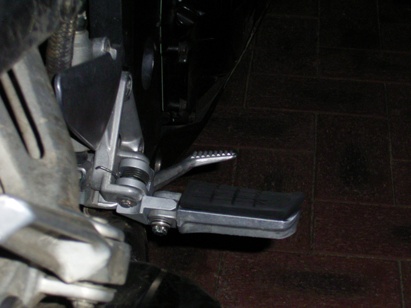

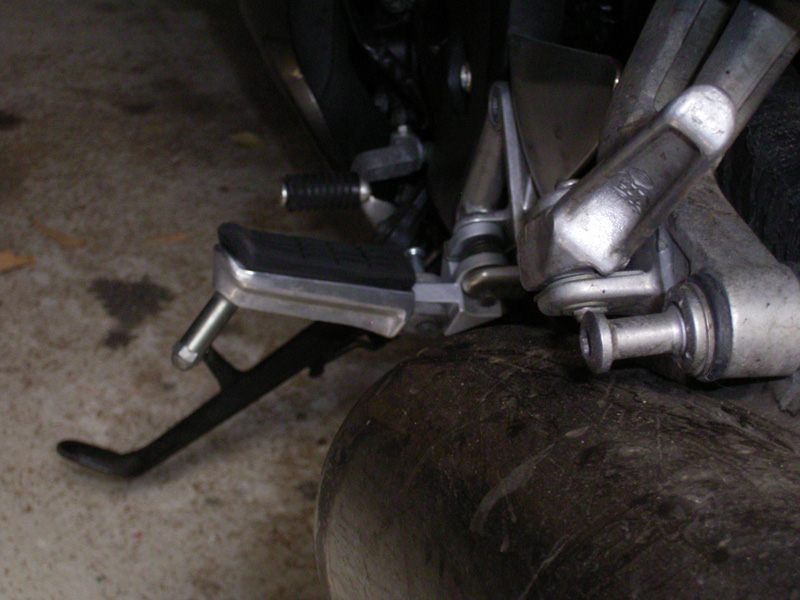

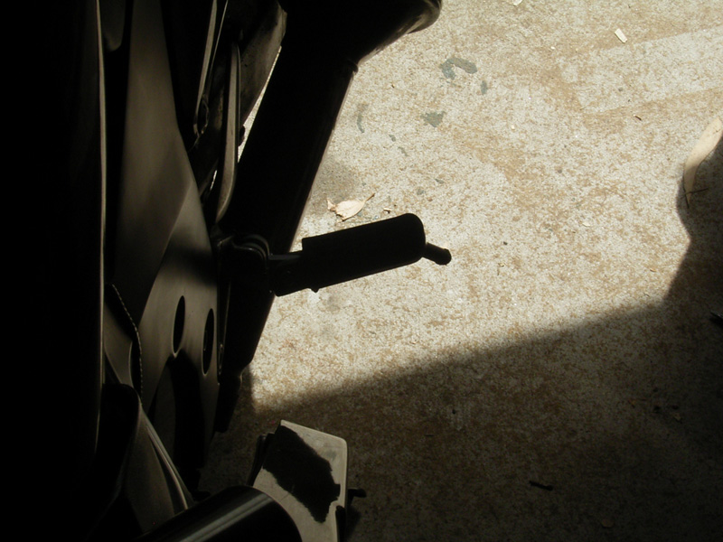

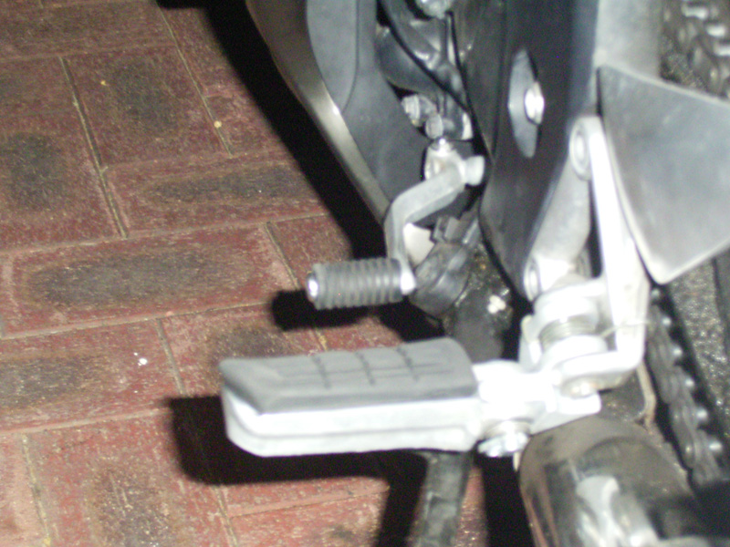

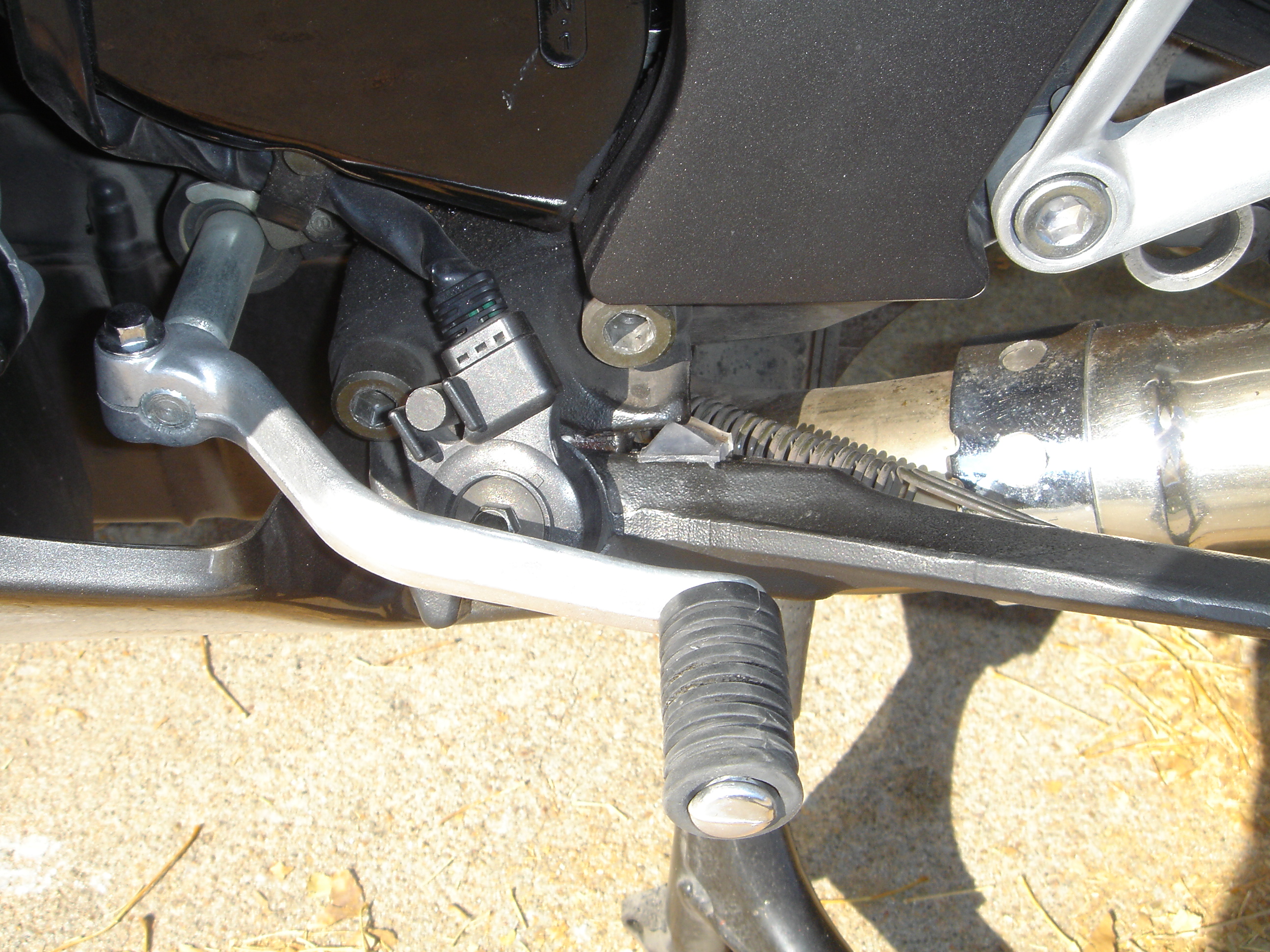

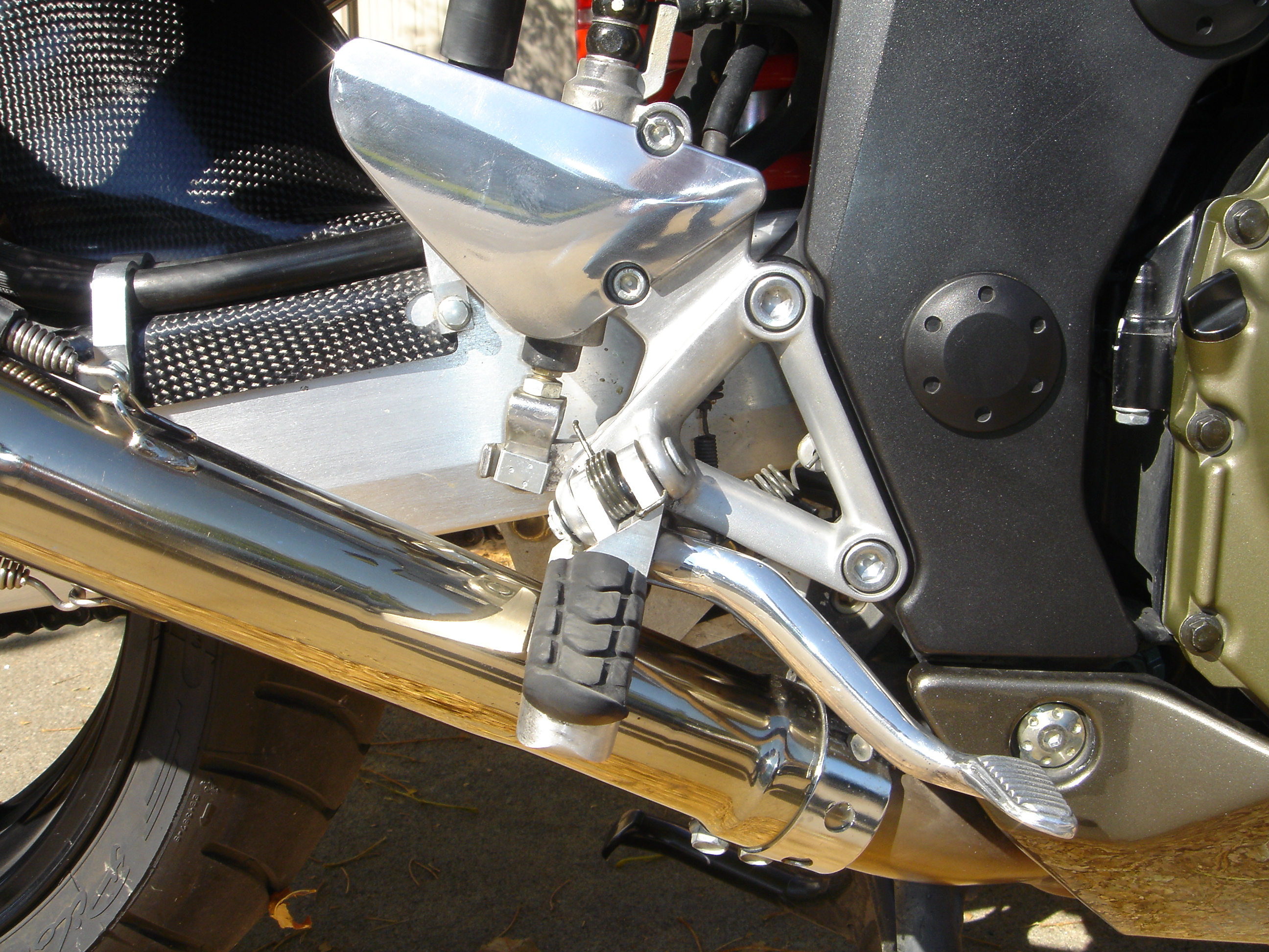

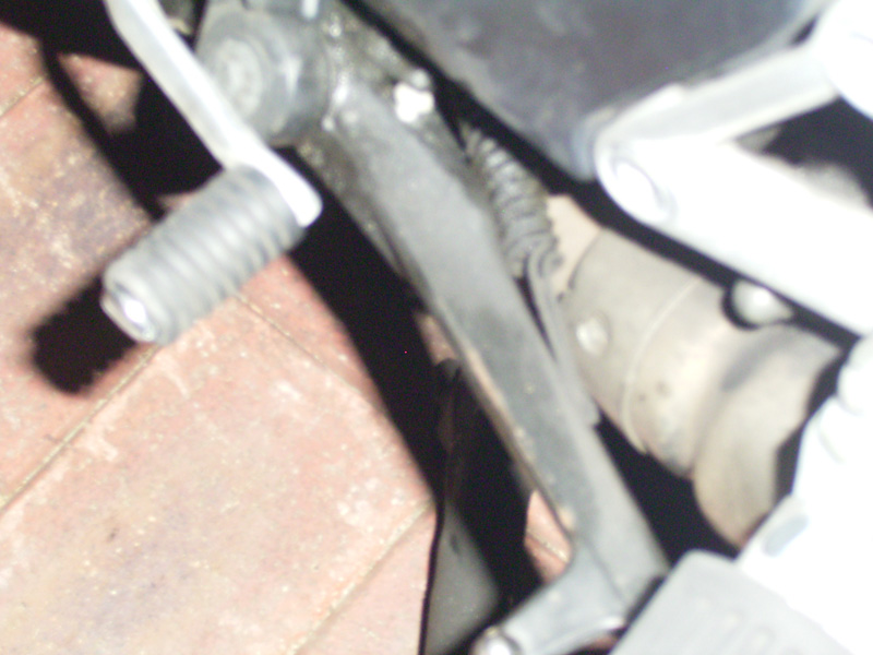

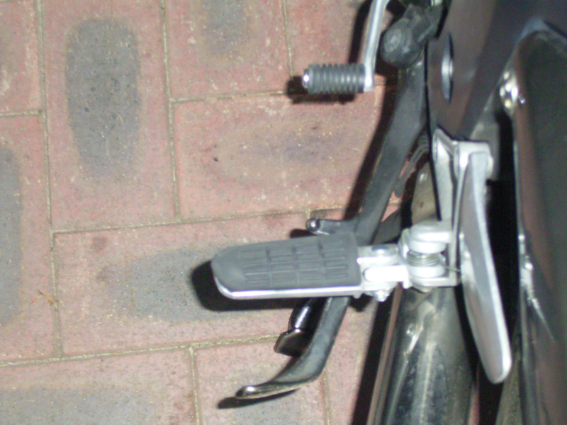

Para045 Posted December 23, 2006 Posted December 23, 2006 Well I have fitted mine and wow what a difference it makes, so much more comfortable on my knees and I am not getting the pressure on my feet anymore when I lean forward . The brackets themselves are great and I had no problem with them fitting into the hangers or the pegs fitting on the male tang, If anything they were slightly loose, I did have to file the bottom of the gullet in the peg to get the pin holes to line up and to get the pegs down level as the pegs were angled upwards quite a bit but that was it. [attachmentid=5716][attachmentid=5717][attachmentid=5718] [attachmentid=5719][attachmentid=5720][attachmentid=5721] [attachmentid=5724][attachmentid=5725] [attachmentid=5722][attachmentid=5723][attachmentid=5726][attachmentid=5727] As far as the levers go - The gear lever I just moved one notch down but I had problems with my size 14 foot getting under the shift lever because of the side stand. I did think about grinding off the little tang sticking out the side of it but decided instead to put a small bolt in the back near the pivot point ( pics 7 + 9 ) to stop the side stand coming up too far, I also unbolted the side stand and put a couple of washers under the front on the bolt to cant the side stand inward to the exhaust, I may end up fabricating a wedge shaped plate to make it neater With the brake pedal I wound it down as far as it goes but that wasn't enough so as someone else suggested I unbolted everything, took the pin out of the pedal and ground the end of the adjusting bolt, took the lock nut off and put it inside the connecting linkage on the thread and the wound the linkage and nut on together as you can see in pics 11 + 12 this enabled me to get the pedal down further The only real negative is a slight sloppyness to the pegs when they are lifted up but some more tension on the spring or new springs should solve that - Thanks again Dave you are a lifesaver ( or at least a knee saver ) Quote
Stretch Posted December 23, 2006 Posted December 23, 2006 [attachmentid=5728]Para045, Great idea canting the sidestand inboard, I'll have to try that. The bolt stop for the side stand, well it's been tried and there is a problem. At extreme lean angles, the sidestand will touch down and really screw thing up in the middle of a hard left hander!!!! It will cause the rear to step out!!! (Don't ask me how I know) I opted for a small sillicone bumper, it will give a little and let you feel the sidestand touching down. Quote
Para045 Posted December 23, 2006 Posted December 23, 2006 [attachmentid=5728]Para045, Great idea canting the sidestand inboard, I'll have to try that. The bolt stop for the side stand, well it's been tried and there is a problem. At extreme lean angles, the sidestand will touch down and really screw thing up in the middle of a hard left hander!!!! It will cause the rear to step out!!! (Don't ask me how I know) I opted for a small sillicone bumper, it will give a little and let you feel the sidestand touching down. That is actually one thing that was in my mind as well when I first put the bolt in the stand - I was looking at the stand foot being almost level with the end of the peg and being lower I was worried it may touch the ground as you say so canting the stand in solved two problems :icon_think: Quote
testrider Posted December 23, 2006 Author Posted December 23, 2006 But after the sidestand was canted, wouldn't that make the bike lean way over while it's on sidestand? Quote
Para045 Posted December 24, 2006 Posted December 24, 2006 But after the sidestand was canted, wouldn't that make the bike lean way over while it's on sidestand? It is only canted in the horizontal axis - when you pivot the side stand down it is still in the same vertical axis so no it doesn't lean any more than before :icon_think: Quote
