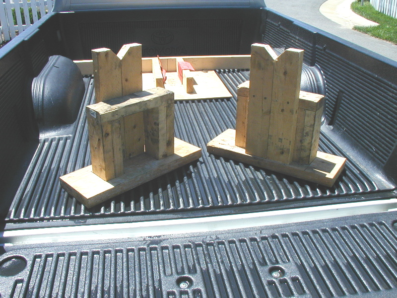

You can also buy their balancing cones for under 20 bucks, and buy a shaft and 2 half inch pillow block bearings from a local supplier. Then set the rig up on jackstands you may already have.
I just balanced my rear Pilot Road with the "MARCPARNES" unit.
I did have to use my own jack stands with it. :icon_biggrin: At first I was thinking I had spent too much money on a steel shaft. (shafted, get it) But as I used it I was blown away by how smooth the bearings were. You can really balance the tire accurately with it. Maybe it is the tire, but man is the ride smooth now.
