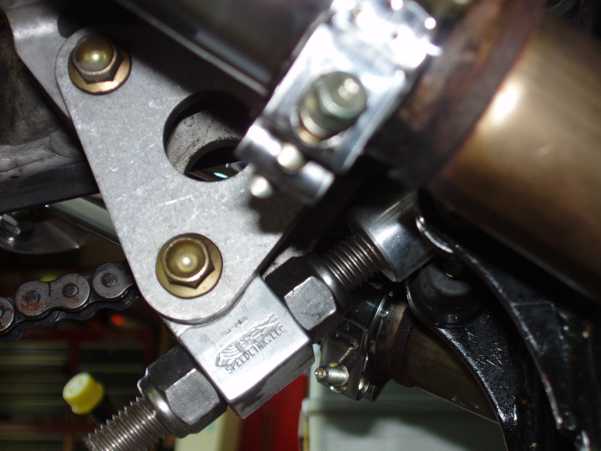

demon Posted May 9, 2006 Posted May 9, 2006 Speedlink makes a hellofa lowering link. You can raise and lower in no time flat. The good thing about this one is that you can lower it for the strip and then raise it back up higher than stock for the twisties Did I say that I love mine? [attachmentid=891] Quote
beondwacko Posted May 9, 2006 Author Posted May 9, 2006 Speedlink makes a hellofa lowering link. You can raise and lower in no time flat. The good thing about this one is that you can lower it for the strip and then raise it back up higher than stock for the twisties Did I say that I love mine? [attachmentid=891] Now that thing is just cool! I found out that CBR600's f2's , f3's f4's interchange with the XX as well. I found a "Bones" brand one on egay for $80, but after looking at that adjustable one, I'm thinking about making one myself. The big question would be where does one get grade 8 1/2 threaded rod. Quote
demon Posted May 9, 2006 Posted May 9, 2006 I got mine through Schnitzracing.com and it cost right at $125 if I remember correctly. It used to be able to SLAM the rear, but I cut some of the threaded rod off to keep the centerstand (rod would hit the center bar of the centerstand and not let it come up). I didn't used to keep my centerstand on the bike and put it on when working on it, but I finally decided to keep it on the bike. With straps on the front and this link, I believe that I could get mine down to about 3" off the ground. I used to have a pic of a baseball not being able to fit between the ground and the exhaust, but have lost it. Quote

demon Posted May 10, 2006 Posted May 10, 2006 I've had the wife on the back with me with it lowered 3" in the rear. It didn't have any problems but I was cautious because of the limited ground clearance. Quote

demon Posted May 11, 2006 Posted May 11, 2006 Oh, another thing, I had to cut and weld my kickstand for the lowered height. I cut about 1 3/4" off of it and welded the foot back on. When it's raised up I have an aluminum spacer that I bolt to the foot raising it back up to stock kickstand length. You won't want to ride it much on the street lowered though. I lowered my front forks in the tripples an inch and took the rest up with the strap. When it's strapped down another couple inches, the ride will suffer. Quote
