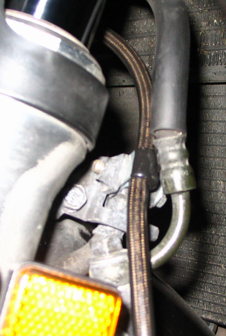

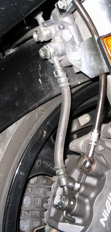

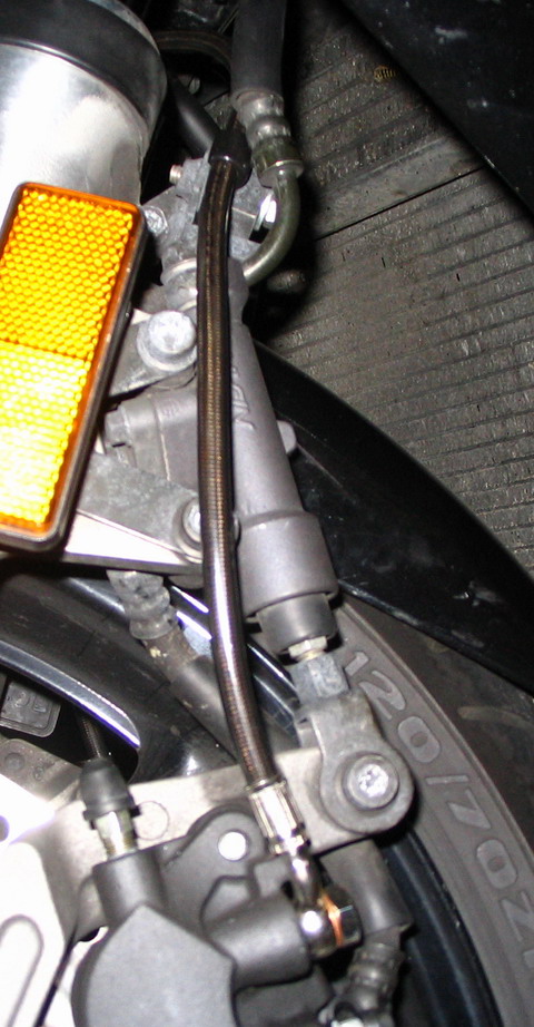

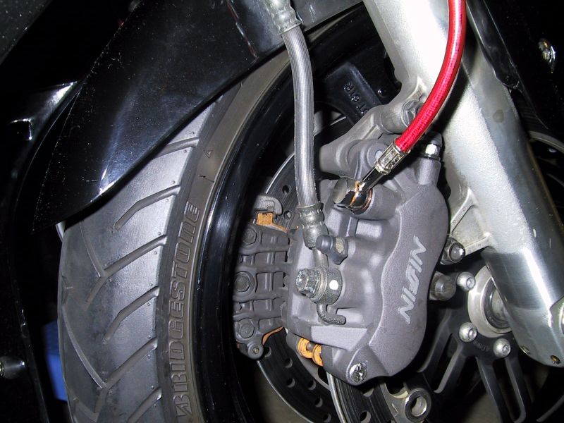

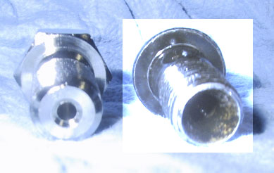

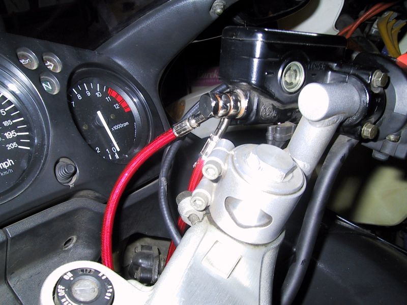

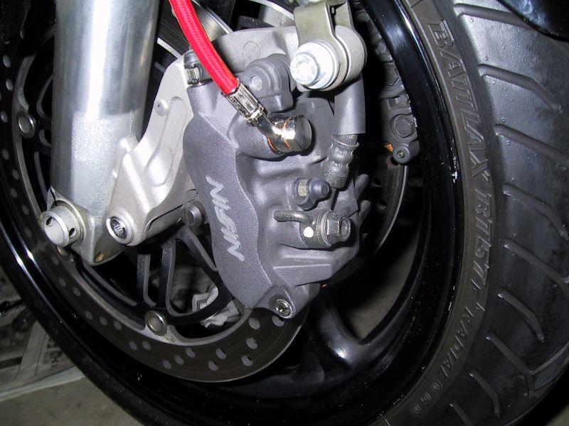

testrider Posted April 22, 2006 Author Posted April 22, 2006 Hi all, I received the Galfer brake/clutch lines yesterday and I installed the front brake lines. Since I have Helibar (which is about 1.5" higher than stock clip-ons), I got the lines with 2" longer than stock. Looks like I should get the stock length as they seem to be too long. So the lines at the calibers are not straight as the OEM lines and I'm wondering if it's ok. Please take a look at these pictures and let me know if I should loosen the banjo bolts at the caliber to try to straighten them up or is this ok? I would appreciate your comments very much. PS: Also, just curious, the Galfer banjo bolt has a much smaller hole comparing to OEM. I wonder what effect does the smaller/larger hole have no the brake lines? Quote

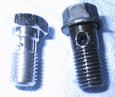

XXTi Posted April 22, 2006 Posted April 22, 2006 Don't worry about the size of the hole in the banjo bolt. They will work fine. I can't really tell from your pics, but it almost looks like you used the straight ends of the lines on the calipers and the bent ends on the master cylinder. If so, you put them on backward. Quote
testrider Posted April 22, 2006 Author Posted April 22, 2006 Don't worry about the size of the hole in the banjo bolt. They will work fine. I can't really tell from your pics, but it almost looks like you used the straight ends of the lines on the calipers and the bent ends on the master cylinder. If so, you put them on backward. Thanks, Jim, yes, for the right caliber I put the straight end on the caliber because it wouldn't fit the M/C side without hitting the M/C body. Anyway, do you think they are still ok so should I straighten up? I already tried but the line is too long so I don't think I can do any better... Thanks again. -mike- Quote

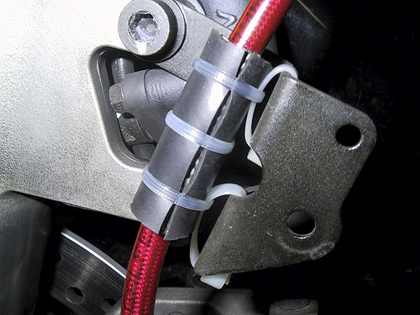

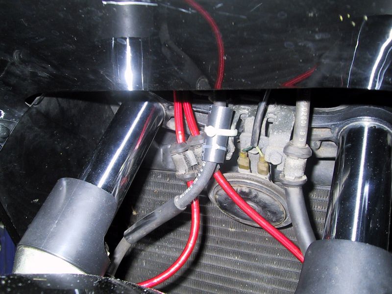

testrider Posted April 23, 2006 Author Posted April 23, 2006 Ok, since I couldn't do much about the lines, I believe I tied them up nice and tight. Here are 2 pics. Again, I would appreciate all comments. Quote

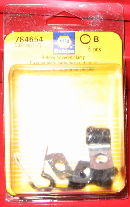

Toynut Posted April 30, 2006 Posted April 30, 2006 Have you considered using the existing bracket holes to mount an Adel clamp(s) instead of that Rube Goldberg pull tie setup (no insult intended). You would have the benefit of a clean looking install, plus the strength of a rubber and metal mount, that would be much less subject to heat and vibration stress as would a nylon pull tie. You can get them at any performance shop in incremental sizes, in steel or aluminum. They are generally under a buck. Try a store that selles Aeroquip hose or Russel fittings. Good luck, BTW. Quote
ccriderXX Posted April 30, 2006 Posted April 30, 2006 Have you considered using the existing bracket holes to mount an Adel clamp(s) Toynut, Thanks for the suggestion. I like that idea. I am currently routing my too long brake lines. I will look locally for some clamps. Here is what they look like at : McMaster-Carr Quote
Toynut Posted April 30, 2006 Posted April 30, 2006 That's what they look like, CC. You can also buy them with an aluminum strap in a performance store that carries Earl's Products. Quote
Toynut Posted April 30, 2006 Posted April 30, 2006 Oh, BTW, Pick up a copy of Street Rodder magazine. You'll find all sorts of trick billet aluminum, and stainless bits if you REALLY want to make it look trick! Quote
testrider Posted April 30, 2006 Author Posted April 30, 2006 Have you considered using the existing bracket holes to mount an Adel clamp(s) instead of that Rube Goldberg pull tie setup (no insult intended). You would have the benefit of a clean looking install, plus the strength of a rubber and metal mount, that would be much less subject to heat and vibration stress as would a nylon pull tie. You can get them at any performance shop in incremental sizes, in steel or aluminum. They are generally under a buck. Try a store that selles Aeroquip hose or Russel fittings. Good luck, BTW. Thanks for the suggestions. I think I saw these type of clamp at Home Depot? I'm going to see if I can get some and reinstall the clamps. I appreciate your advise. -mike- Quote

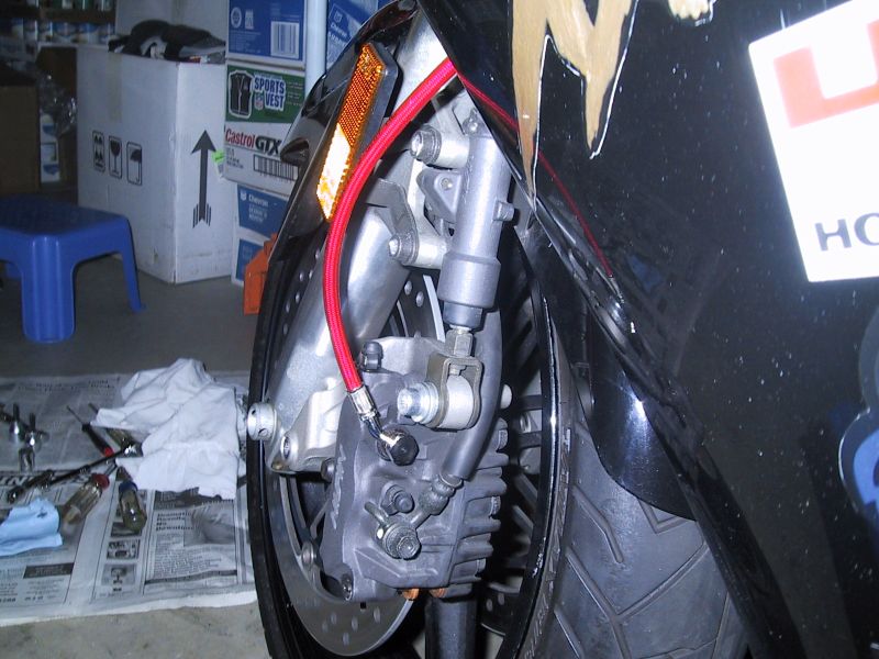

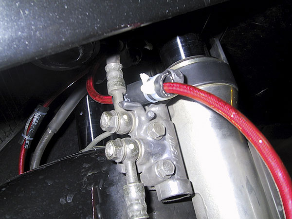

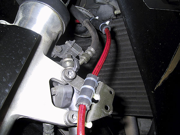

ccriderXX Posted May 6, 2006 Posted May 6, 2006 The clamp suggestion was great! Thanks Toynut. I didn't get Adel clamps, but some I got rubber coated 1/4" clamps at NAPA. A picture is below. I used the bolt locations where I had removed the stock brake lines to attach the new lines in clamps. I took a picture of both left and right sides. I had ordered speedbleeders with my galfer brake lines. But I had a difficult time priming them. I finally got a mityvac type tool at Harbor Freight. Man that may be the most helpful tool I have! I will not be able to do brakes without one now. It is a must have. Here is a link: http://www.harborfreight.com/cpi/ctaf/disp...temnumber=92474 It is item 92474. Quote

CBRBob Posted May 6, 2006 Posted May 6, 2006 So the lines at the calibers are not straight as the OEM lines and I'm wondering if it's ok. Please take a look at these pictures and let me know if I should loosen the banjo bolts at the caliber to try to straighten them up or is this ok? I would appreciate your comments very much. You know the small block of aluminum that sticks out of the caliper next to the hole? The line is supposed to butt up against it for orientation, same as the master cylinders. Keep BOTH of them in line and you should have no problem. Quote

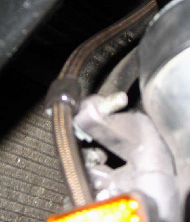

ccriderXX Posted May 7, 2006 Posted May 7, 2006 Thanks for the update. Could you post a few pictures at the calipers? Also, I saw that you use 1/4" clamp. Are you sure you were not squeezing the lines at the clamps? I measured mine and the OD of the lines are almost 3/8" (definitely more than 1/4"). I measured them with my calipers and the Galfer lines are .30" diameter. I actually didn't tighten the clamp all the way down, I loosened it a bit and made sure the line isn't sqeezed. Here are pictures at the calipers. Quote
