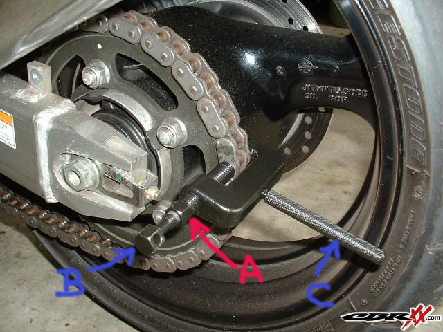

Thanks for the reply. Yes, that's correct. Make sure it's there. It's very easy for it to fall on the floor when you're not looking. This happened to me, and I accidentally pushed the pin through the back and destroyed the master link. Yes. Make sure it's all the way to the stop. In one of your later posts, you attached a photo from webbikeworld where it is backed off an inch or two. I'm pretty sure this is wrong. I initially tried to do it this way, and I was having a heck of a time trying to flare the rivet because all of my energy was going into bending the rivet pin. Yup. I'm pretty sure I held 'A' while tightening 'B'. Kevin I accidently pushed out the pin by holding 'A' while tightening 'B' and screwed up my 1st link. It looked like while holding 'A' and tightening 'B', 'A' was retracted back into the C-clamp and therefore push out the anvil leaving a gap in the back that I didn't know. I kept turning in 'B' and found the pin backed out in the back! -mike-
Thanks for the reply. I appreciate it. However, which position is the correct position to stake the pin, pic 1 or pic 2? Thanks again.
Just saw this pic on webbikeworld.com and it didn't even screw 'A' all the way down to the side plate. Is this incorrect or is it ok too? Thanks again. -mike-
I have a little trouble using the Motion Pro chain tool to rivet the link. I already screwed up a master link. I pressed the side plate on just fine. I have some questions in this picture: 1) the anvil is on the back against the pin head, correct? 2) now I screwed in the 'A' (red arrow) until it stops against the side plate? 3) now I screwed in the rivet pin 'B' 4) While holding 'C', I keep tightening 'B', until the pin head is flared to the correct measurement, is this correct? Or am I supposed to hold 'A' while tightening 'B'? Thank you very much for any help! -mike- PS: is it better to position it on the rear sprocket like this pic or it doesn't matter? I position it between the front & rear sprocket on the bottom.
