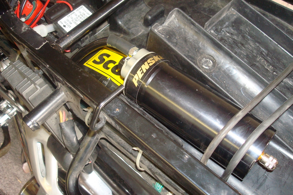

What if the remote reservoir for a Penske shock is just place non secure under the seat?
Right now the stock bungee straps holding it in place.
Will the reservoir move around due to the hydraulic force of the shock compressing and extending?
Thx,
Bob
No, it's absolutely fine - that's how I've got mine secured and no movement whatsoever. Why over-complicate things?

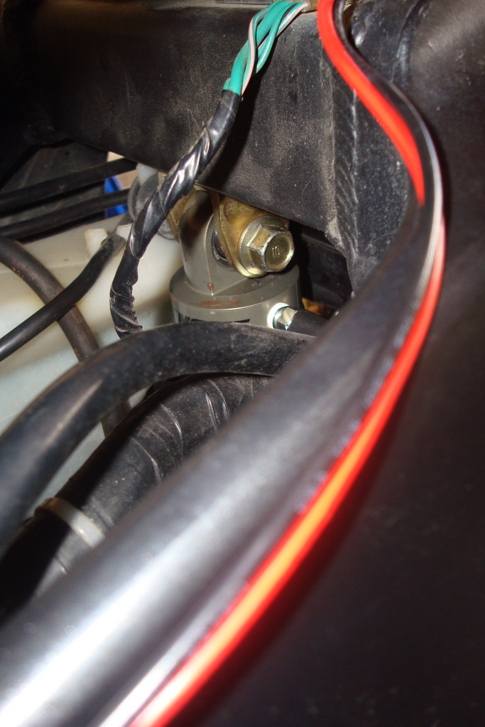

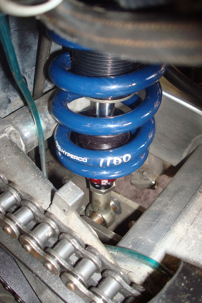

For what it's worth, I've enclosed some pics of my Penske installation. There are no problems installing it but it does show where I located the remote adjustment. I wiped some copper-based grease on the pivot pins to reduce the risk of fretting corrosion but is isn't strictly necessary. Can't believe how good the result was and it really showed up the standard front end. I didn't go the whole hog with a subsequent front end upgrade, just used JAWS longer springs and shorter spacers but this gave a good result.
Geoff

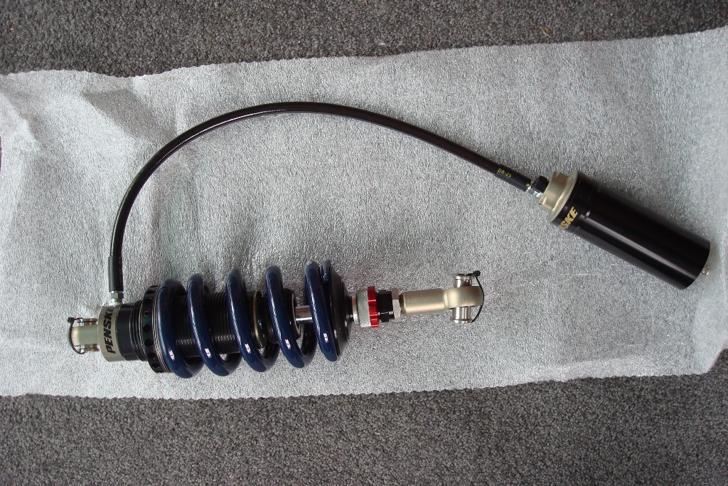

I've just got back from the maiden test ride with the new Penske 8983 rear shock with remote damping adjustment in place of the OEM Honda unit. For a cynical bastard like me, the difference came as rather a shock and was pretty profound! Suspension gurus would say that this is stating the bleedin' obvious but sometimes, something like this simply has to be experienced!!
It might sound contradictory but the most noticeable difference was that you simply didn't notice the suspension doing its job and maybe that's the biggest compliment that it's possible to give. On the OEM unit, rear wheel chatter over my local favourite bit of road was really noticeable and with the wheel not having constant contact, the impact on handling was way less than optimal in terms of grip, rate of turn-in and a whole load of other factors. With the new unit, the chatter had completely disappeared and I was able to corner with greater confidence because the bike felt much more stable.
The shock was set up specifically for me by Cogent Dynamics as part of the group buy (spring rate, valving etc) and I haven’t played with ride height, sag, preload or any of the multitude of damping options. I don't doubt that that a suspension god could extract even more performance from it, but I'm leaving well alone for a while! Top suspension units like Penske and Ohlins are always going to outshine OEM units by a country mile but I'm also wondering how much of the improvement has been due to that imperceptible performance decline of the OEM unit over time which is very difficult to detect when you ride regularly.
If there is a downside to fitting the new unit, it's because it's magnified just how crap my stock front fork setup is! Fortunately, the new internals arrived from the Jaws in the UK yesterday so I hope to address that shortly.
Good suspension doesn't only give benefit to good riders but clearly applies to the whole spectrum of abilities and type of bike; conferring increased grip, quicker handling and probably a significant increase in tyre life which is another thing I'll try and monitor. Again, it's probably stating the bleedin' obvious but from my experience today; I'd opt for good suspension way before aftermarket cans, Power Commanders or any other form of tweak!

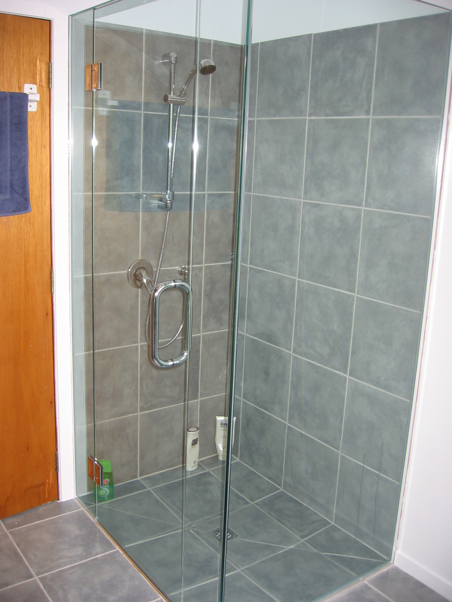

I share your pain! :icon_pray: The renovations seem never-ending at our beach house. We renovated our bathroom a couple of years ago and put in one of those all-glass units held together with the silicone-based adhesive used for fish tanks. The base is tiled, the same as the rest of the bathroom, with a slight fall towards the drain. Works really well.

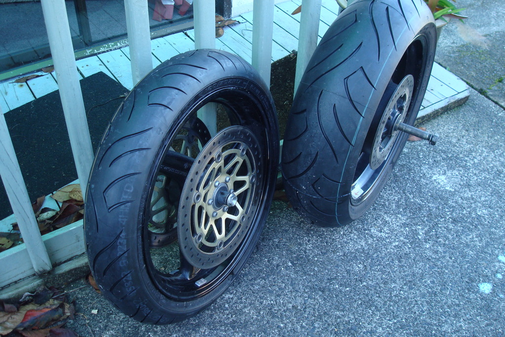

I've just fitted the newly-released Avon VP2 Sport tyre. It has three different rubber compounds in the construction. There is a durable medium compound in the centre for improved mileage and a softer compound out to the edges for maximum grip at high lean angles. A third low hysteresis compound (rapid rebound property) is applied across the tread base to improve the bond between the two road contact compounds and the carcass underneath.
I've been a fan of Avon Storms since their release in late 2006 but went to an Avon Viper sport softer compound front last year. Both front and rear tyres lasted about 7000 km on coarse chip roads. Grip was exceptionally good but am now evaluating the VP2 (the successor to the Viper) both front and rear. I've only done 700 km on them so far but the grip is such in both wet and dry that my nerve gives out before the tyres do! The only unknown at this stage is how long they will last given the weight of the 'bird and its tendency to "push" the front end.
