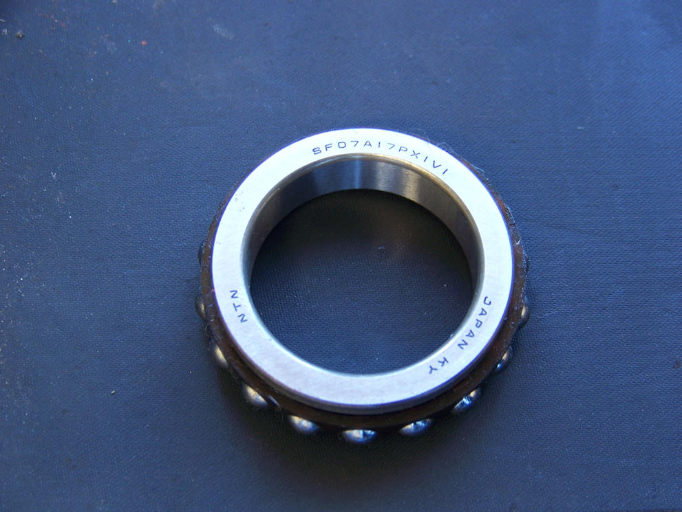

The parts are stock, from an '08. I don't have the outside race . . . I'm guessing it's still in the frame of the bike my forks came from? Hmmm, I just looked at a few random front ends on ebay and none of them come with the outer races, I guess this is the norm. Which is nice to know, but not too helpful right now
Ok, so would an aftermarket tapered bearing kit have the parts you need? Because if that were the case I could paypal you the cost of the kit, you could order it and have your way with it, then forward it to me when you're done. Given a choice, I'd rather buy a plug-n-play ZXXX conversion kit set up for the tapered bearings anyway.
Finally got my parts . . . took a bit longer than it should have thanks to my rural mailbox having an unscheduled encounter with a baseball bat. Yes, that shit actually happens. Anyway, here's a pic with the only numbers I could find. I freely admit that my knowledge of bearings is somewhere between jack and shit, so if this isn't what you need let me know. Preferably using a picture, with the relevant parts circled in red
I have a digital caliper and an outside micrometer if that helps. If you can get me pointed at the right gizmo, I can take physical measurements of it.
