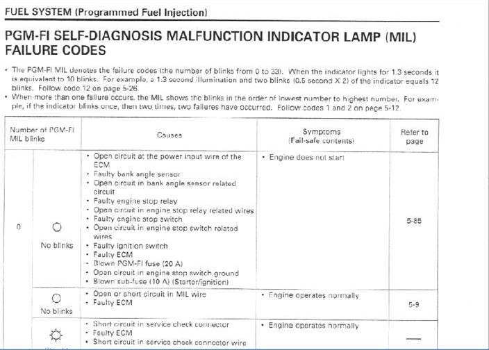

Hey guys. I am going through my shop manual for my F4i. I came across this document. I'm not a stupid guy, but i'm having a hard time decifering what the hell they are talking about.
How do you calculate the number of blinks??
Is it simply 1.3 sec = 10 blinks, and anything after that is added on?
If that is true how do you get 1 or 2 blinks?
The example cites a light on duration of 1.3 sec long equals 10 blinks, plus 2 .5 sec. blinks equals 12 blinks. Seems pretty straightforward.
Maybe i'm a block head today. I see now how the 12 is calculated.
Are we supposed to assume that if the computer is saying all blinks under 10 will be .5sec each?
Meaning 3 blinks will be 3, .5 sec blinks.

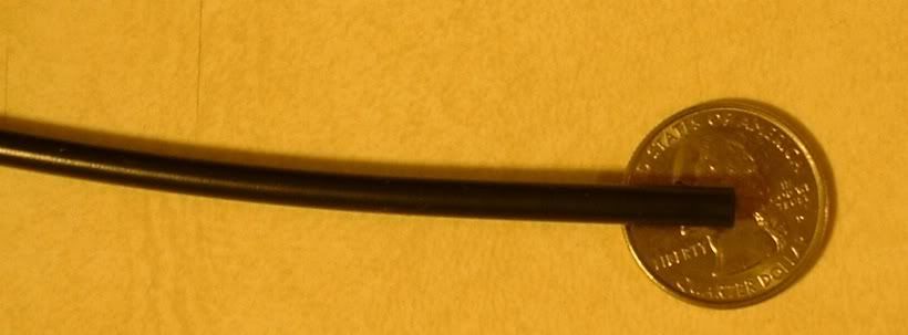

My bad guys. It starts and 3/16" and shrinks to less then that. I believe about 30% shrink,,,like most.

I just read the codes on the bike. It gave me 9 blinks which says the IAT (intake air temp) sensor. The problem i'm having with that code is that even if that sensor is failing, the bike should still start,,,says the manual.
