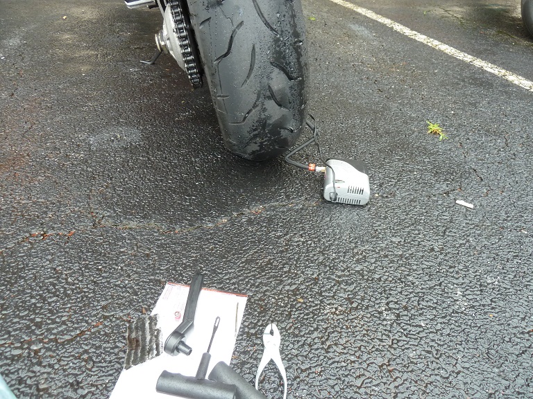

slime powersport compressor and tyre plug kit.pumping up the tyre on my vfr800 in georgia back in 2013.plugged 2 punctures from 3 inch nails
ive run with 4 plugs in a rear tyre with no problem but have never had to put one in a front yet.
