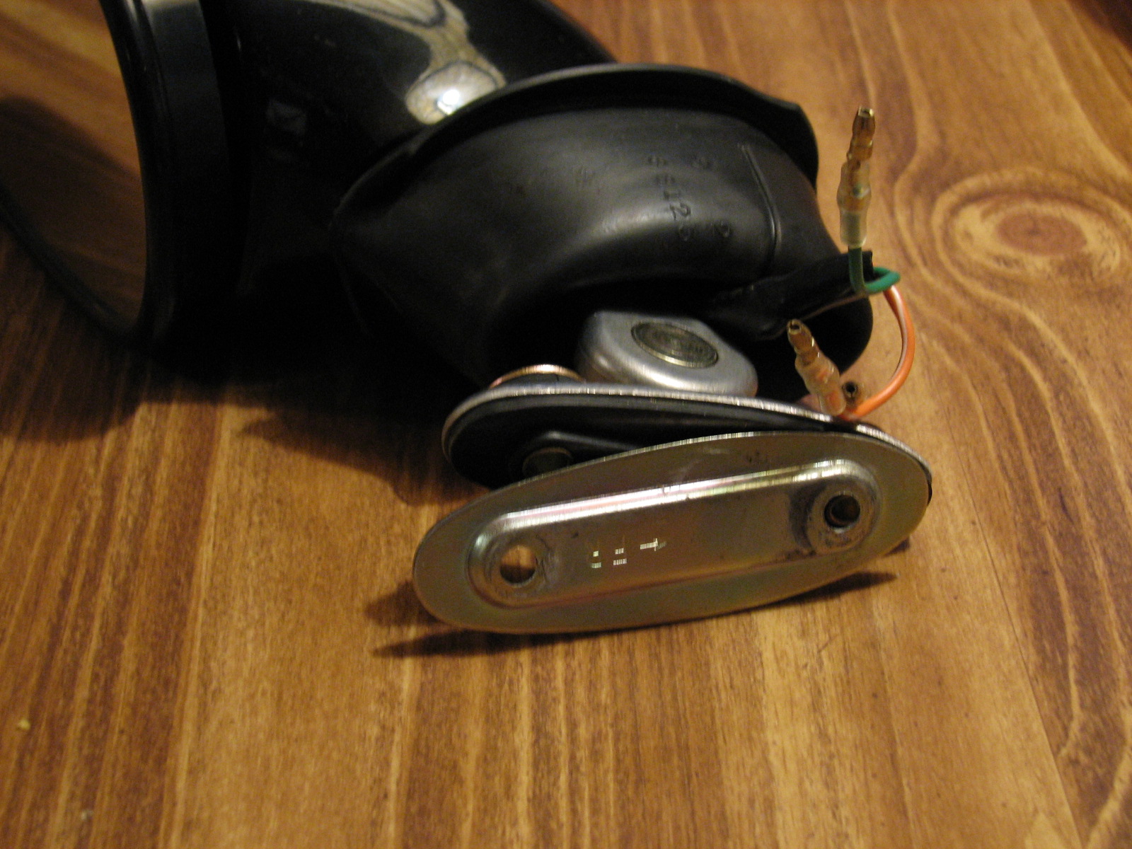

  24. 'Nother question: the little brass colored bracket I've got leaning up against the mirror mount.......that's where that goes, right??? In other words......it goes between the mirror, and the side of the screen, right?? Not on the inside of the screen, right?? I'm 99.9% sure of this, but I just find it hard to believe there aren't more scratches against the screen part with that metal being there. For some reason, I keep drawing a blank about where this stuff was when we tore her down
