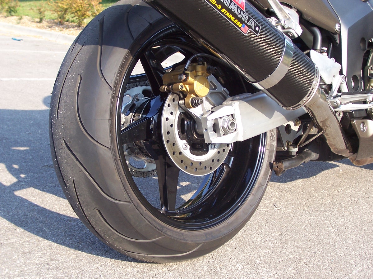

Yes, I've converted my rear wheel to the RC51, as well as the RC51 front end. I actually didn't start off with trying to match the wheels. After converting the front end, I wanted to use the RC rear caliper so I would have a matching brake system on both ends. Well, the RC caliper won't fit the Bird caliper bracket. After experimenting with combinations Bird and RC parts I realized the only way it would possibly work was to adapt the complete RC rear wheel, caliper & bracket to the Bird swingarm. I Ebayed all of the parts I needed, but wasn't completely sure if it would even work until I had bought everything and started measuring. The RC wheel is 6" wide, but the center hub is narrower, also the rear rotor is smaller in diameter, undoubtedly because the RC51 is 75lbs or so lighter than the bird. The complete rear wheel assembly with dampener, sprocket and rotor is 7lbs lighter than the Birds' weighed the same way. The front wheel without rotors was 1lb lighter.
The RC axle is approx 50% larger diameter and uses push axle blocks. The the axle slot had to be machined for the larger axle and the outside of the swing arm machined for the push blocks. The swing arm side tubes are an excruded part with a center rib. We drilled into the rib and tapped it for the adjuster bolts to push the blocks. The caliper bracket slot-tab arrangement is just the opposite of the Bird, so we cut off the aluminum locator block on the swingarm, machined a new one for the RC caliper bracket and welded it on. Finally, the wheel offset is different, so we machined new spacers for both sides.
The RC conversion on both ends has been a lot of work and at some point I was on a mission just to prove it could be done, but the end result for me has been worth it.The bike makes directional changes MUCH more quickly and the RC51 brakes could launch you over the bars if you aren't careful. I'm still dialing in the front end height, etc, but the bike feels much more planted and there is no torsional flex in the front end. I've got some pics of the swingarm mods I can post for you, but I need to look for them.
