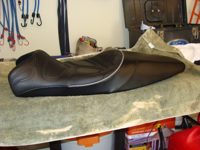

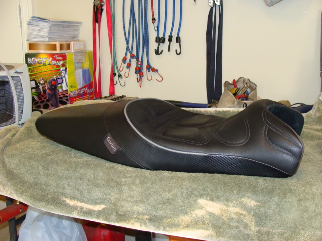

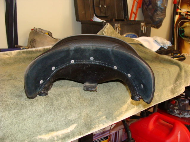

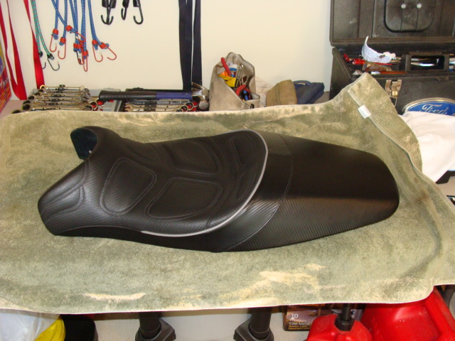

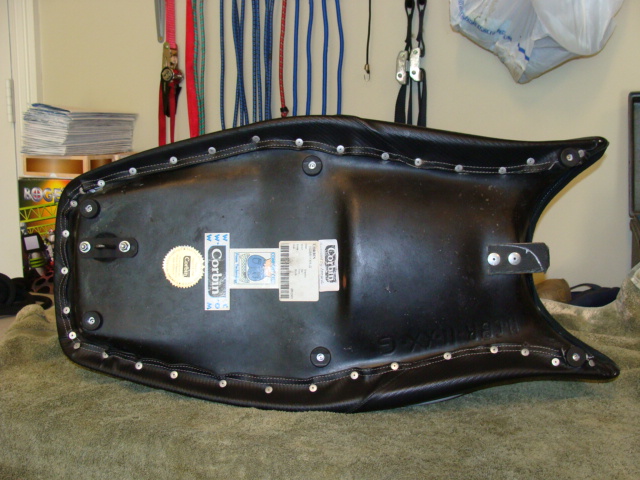

Hello boys and girls! My beloved 'Bird has been adopted by my lovely wife and the Corbin dish is too high for her to reach the ground. So my loss is your gain. I have a Gunfighter saddle in all carbon fiber leather for sale. It has the stitching on the 'drivers seat' and a light grey welt on it. No tears or anything like that on it at all. I am out of town at the moment and I only have the one picture now but PM me and I can send you more when I get home. I will also include a bottle of Corbin Saddle Cream with the seat. I am asking $250 but won't turn away any reasonable offers. If I don't get any bites here then it will end up on Fleabay.
Thanks!
