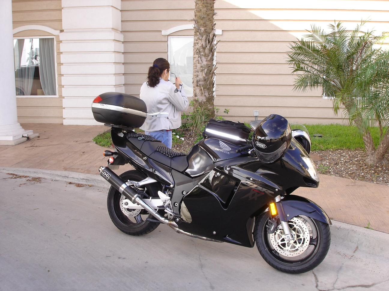

This Givi Wingrack kit contains everything you need to mount both sidecases and a top box. I had used this system for just a couple weeks last year; it is in like-new condition! Take it all for only $175, shipped and insured!

Well, I can agree that they are not the most sleek looking things but I won't see them while riding. I could care less. I'm sure some where I'll pass some poor sap stuck on a VeeStrom650 or GS1200 with big ass square aluminum cases and leave him thinking "those bags were ugly but that bike was fast." Besides, when I mount the 46 Givi on the tail rack I am immediately removed from the beauty pageant. How much worse could it get?
Thanks John. I appreciate the good deal and plan to put them to good use. Enjoy Nexxt. You should come to Texxt.
Trust me, my bike ain't pretty.... specially with the Givi's, the fuel cell and the beaded seat cover on it lol... not to mention the outside don't get washed much... and yeah, those bags are still ugly, but I'd use em!
