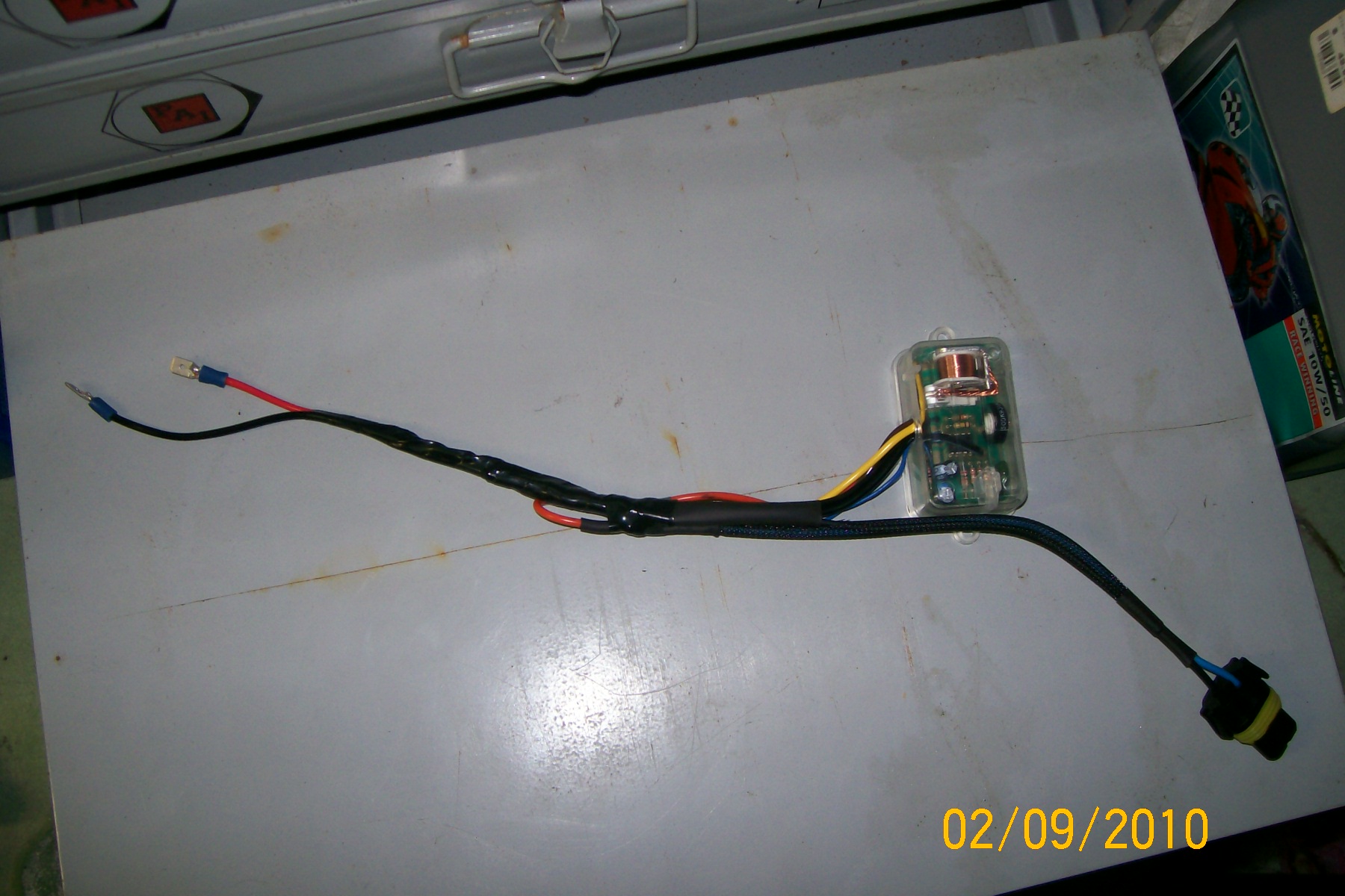

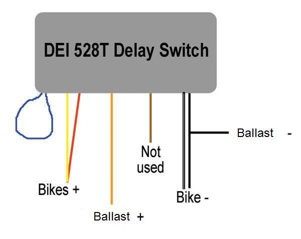

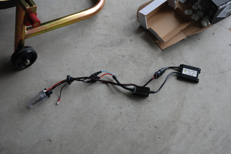

In case someone doesn’t know what the DEI 528T delay timer looks like……….. There are two reasons for adding it to my bike. 1. When turning on the key and the ballast powers up, depending on how much juice is in your battery, it can pull enough power to reset the clock. 2. When turning on the key it powers the ballast then the bulb flickers and comes on, then by pressing the start button to crank the bike, power is killed to the ballast till bike starts then repowers the ballast bulb flickers and comes on again. So the head light has to come on twice. With a DEI- 528T 30amp delay switch, you turn on the key and the timer starts a 10-90sec delay (adjustable) before the ballast is powers up. That gives the bike time to start and the charging system to energies. No reset clocks and the bulb only comes on once to extend it’s life In the pics above the DDM kit come apart in 3 sections, the bulb with it’s plug, the ballast with it’s relay/capacitor that plugs into the bulb and the power wire that one end plugs in to the OE headlight connector and the other end plugs into the ballast (this is the wire you spice in the timer.) I should have done a better job of taking pics as I went along.

Installed the DDM Tuning HID kit today with the DEI 528T delay switch wired in to the power pig tale on the kit. Most of my time was spent to figure out where to put everything and cutting the wires so there wouldn't be to much slack or extra wires wadded up behind the fairing. I know everyone who has installed HIDs have been very impressed and I’m no different…..Should of done it years ago and for as cheap as they are now there is no reason not to have them. Sort video with the dalay timer set to 35sec.

Great decision, almost, do both. Worth every bit and last much better. Only thing that I find a problem at all is the slow start up. but, after the first time they seam to be quick enough. At night, I kick the high on right away, so it is charged up. I have the euro right switch, so I, as you know, can turn it off at startup. Do they make one for yours? I wonder if one for the bird could be adapted for yours. Can't be that much different. As far as I know of, no euro switch. Most are splicing some sort of capacitor for the high beams so the “flash to pass” switch will work. They are also splicing in some sort of relay timer thingy on the low beam to give it a 10sec delay. Something about the power drawl before the bike starts makes the clock reset some times
