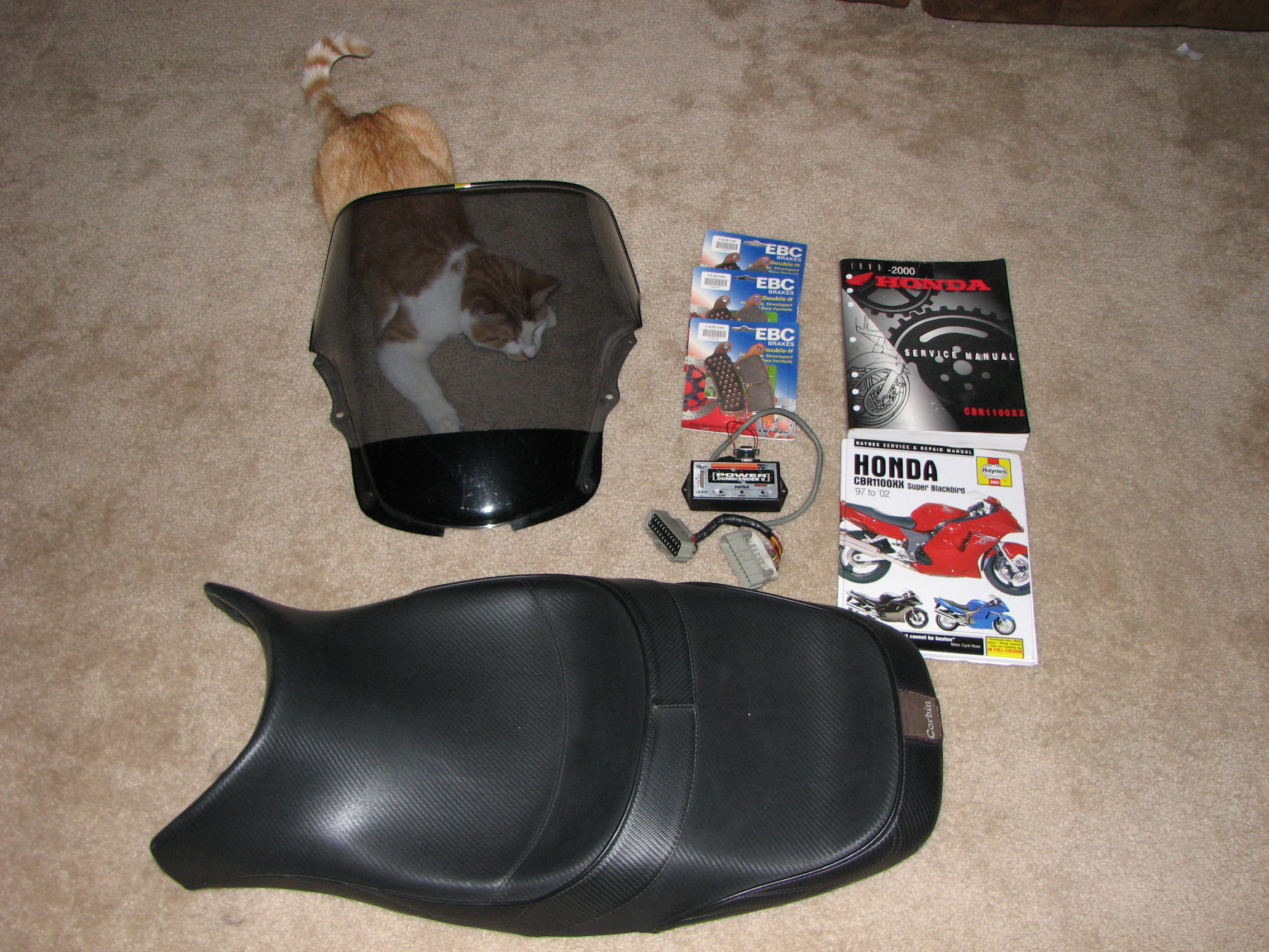

I finally went through my garage and have the following items for sale...
Corbin G&L - $225 shipped - Sold
EBC HH pads (all three sets) - $75 shipped - Sold
Steering Stem tool - $50 shipped - Sold
Honda '99 - '01 Service Manual & Haynes manual - $35 shipped - Sold
Galfer SS Front Brake lines & Clutch line - $125 shipped Sold
PCII ('99-'01) - $200 shipped Sold
Secdem Screen - $50 shipped
PM me if you're interested in any of my stuff and/or if you want more pics. I prefere checks or M.O.s... I won't use PayPal after the screwing they gave me a while back...
