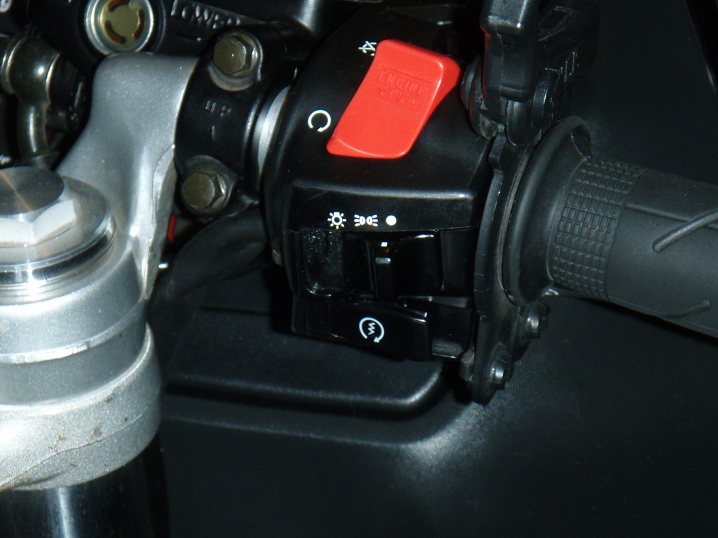

Not normal here. My McCulloch low beam will flash once, then start warm up with the motor running or not.
Just for grins and giggles, I just went out and set the high and low beams to come on with the key and gave it a try. Both bulbs flashed once then started coming up to full brightness when I turned the key to on without starting the engine. (I see spots before my eyes now.)
You said you have the HID on the high beam. What are you using for your low beam?
