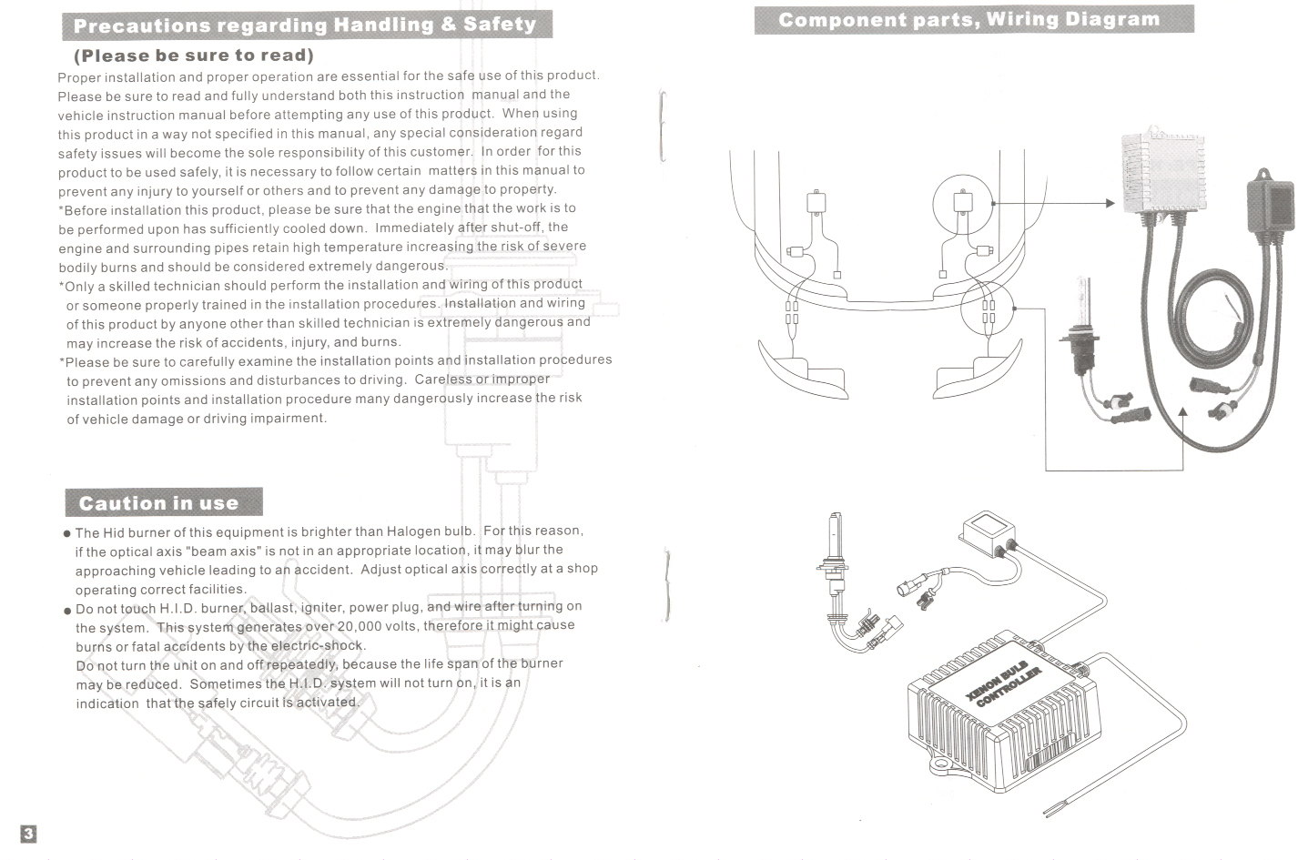

This is what the manual looked like that came with my McCulloch kit from Andy:
Front & back:
Pages 1 & 2:
Pages 3 & 4:
Pages 5 & 6:
