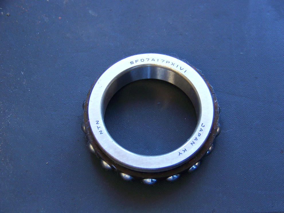

RedEye Posted June 17, 2011 Author Posted June 17, 2011 Bump again. Front tire disintegrating, grisly death imminent. New forks probably rusting in box. Even the dog looks sad. Please can I has adapter? Quote
