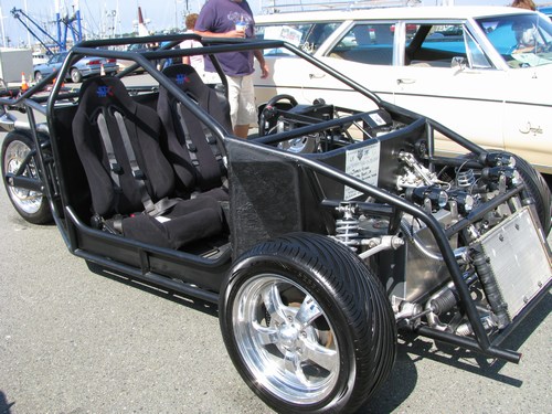

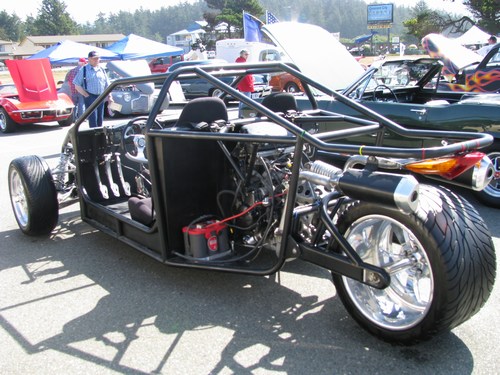

here are a few pics of my Trike.
P.S. the power comander is not hooked up at the moment.
