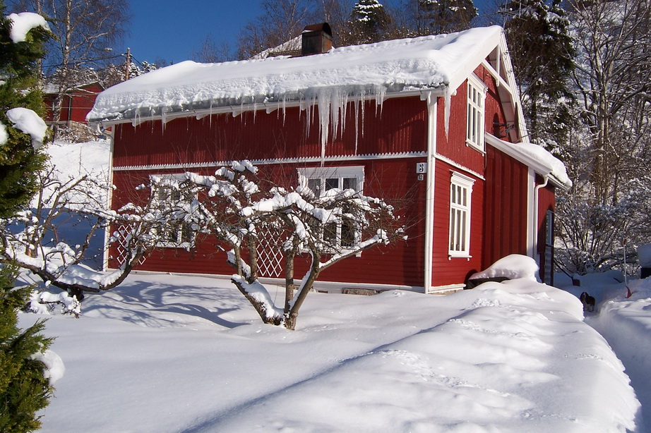

BearXX Posted December 15, 2007 Posted December 15, 2007 Clear the snow above it, salt the ice that's left. Repeated applications of the salt may be required. We typically get up there and hack them out, but be careful if you decide to try that- I've repaired a lot of roofs and gutters that were damaged by overenthusiastic homeowners. That's what I was concerned with, damaging the roof or gutters. So it is not good to leave it till spring? You already have a problem my friend. The ice behind the gutter is water flowing under and behind the gutter. As it freezes it expands and enlarges the openings. You better get rid of it. This was our house 2 winters ago. The ice gets very heavy before the spring. Quote
