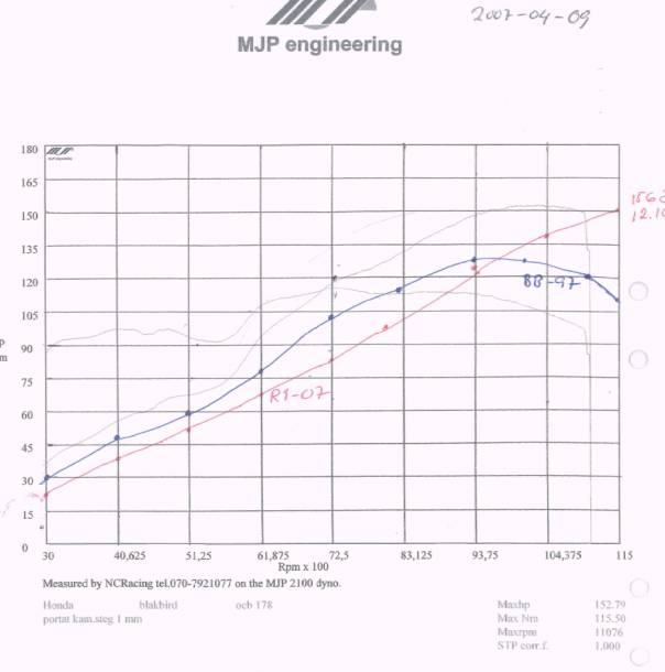

R1000 Posted November 20, 2007 Posted November 20, 2007 I believe it will be very difficult to take out a ZX14 or a Busa on a straight flat out even with some serious mods on the bird, unless you are using a turbo or nitrous. Still, an old Honda CB 750 -72 can easily take them out on any severe twisty road if the driver is more capable :-) My bird is currently modified with a reworked head and aftermarket cams etc. It pulls more than 150 honest rwhp on the wheel, which in combination with a 16/46-sprocket set makes it quite strong. I have surprised more than one owner of modern sport bikes when they try to overtake after a curve on track and find out the heavy bastard in front pulls stronger and leave them behind. The cost to make the bird all out stronger than a ZX14R or a Busa will be higher than trading in the bird and buy a used ZX14R or a Busa. You also have to modify the chassi on the bird to cope with the higher power level. The bird engine is very reliable in stock condition and there is no need for blueprinting to increase reliability unless you are looking for more 160+ rwhp. The most cost effective mods to improve performance are adding a full 4-2-1 system and change sprockets. To climb up on the next level, more than 150 rwhp, you need head work and other cams which will add another $1500, or more. The pic below is a dyno curve of my bird. The third thin curve on top is the engine in current condition. One can see that it has a healthy low and mid range that makes the bike very strong on twisty roads and track days. Quote
runner Posted November 20, 2007 Author Posted November 20, 2007 R1000 is exactly on target and confirmed my thoughts...the bird is a great bike which you shouldn't stretch too far. thanks! Quote
