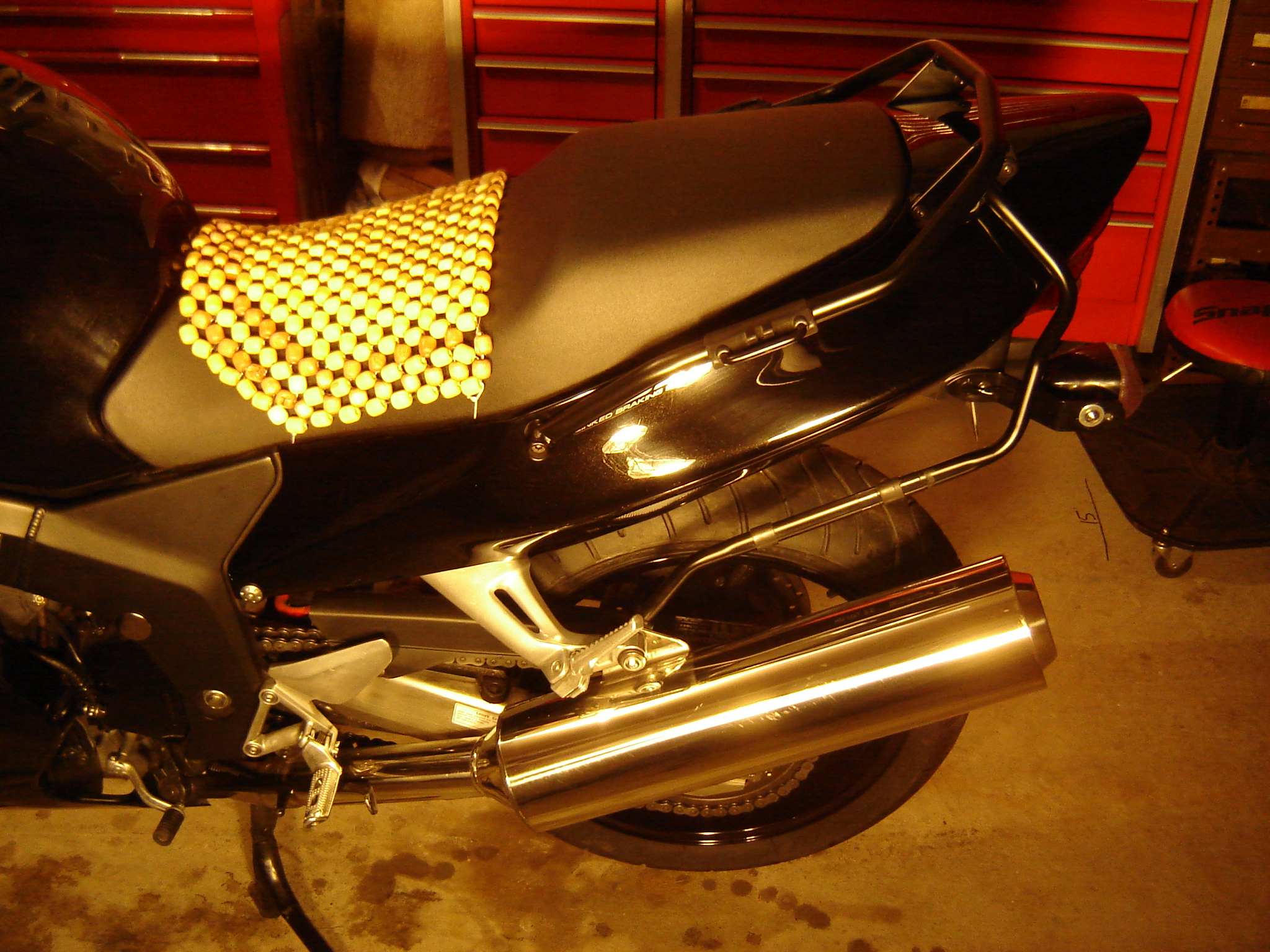

rcskisfast Posted June 12, 2007 Posted June 12, 2007 Not sure of what your asking. Hope this picture helps. Ron Quote

gt_mule Posted June 15, 2007 Posted June 15, 2007 Here's some pics with the seat off. The extra wiring is my garage door opener. Hope this helps. Quote
XXMAN Posted June 15, 2007 Author Posted June 15, 2007 These pics help me greatly thank you. I guess the bags I puchased are for a fi bike So now I will have to be creative because the reg/rec is in the way on the carb bikes. Thank you everyone that tried to help. Quote
