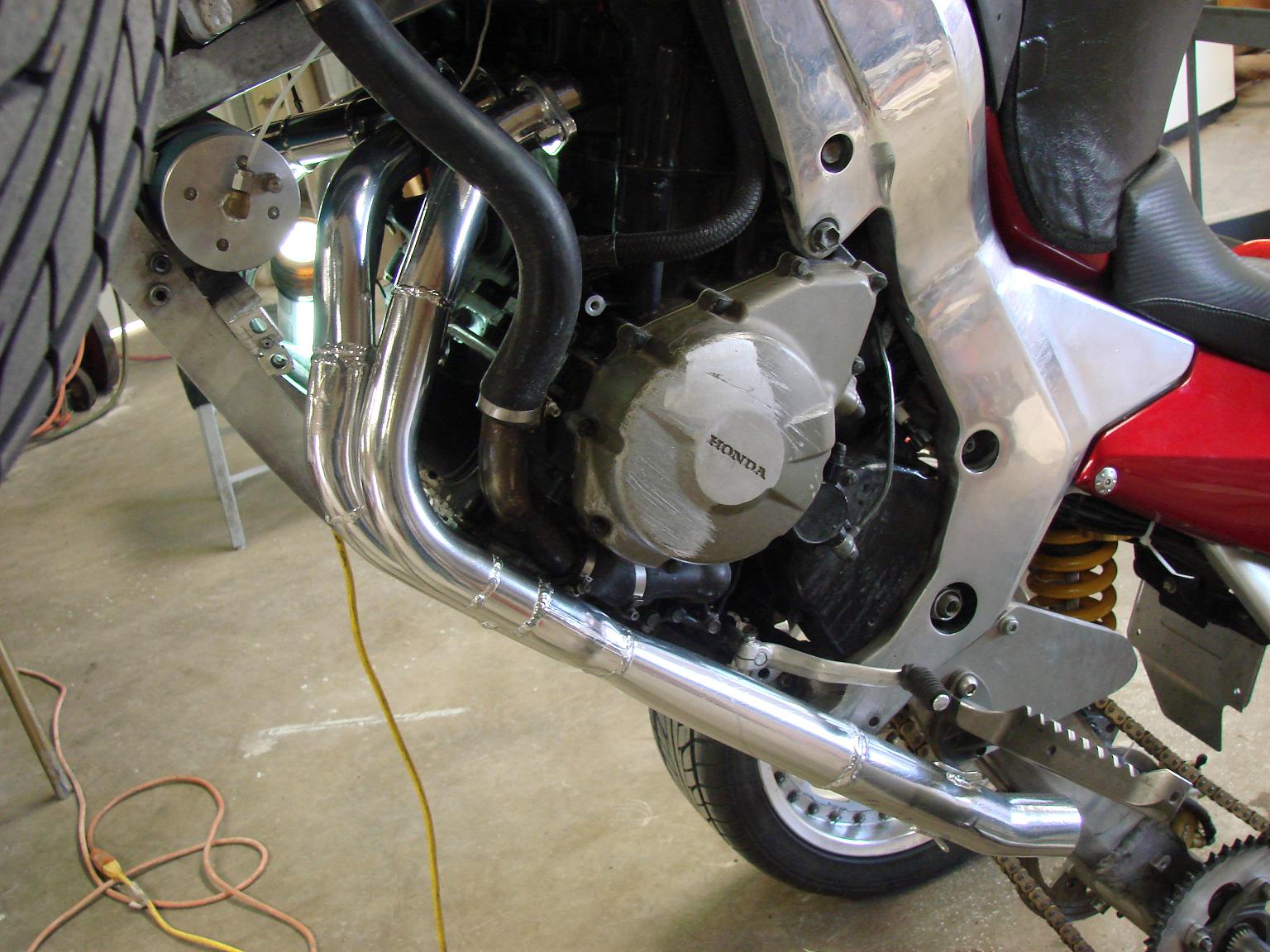

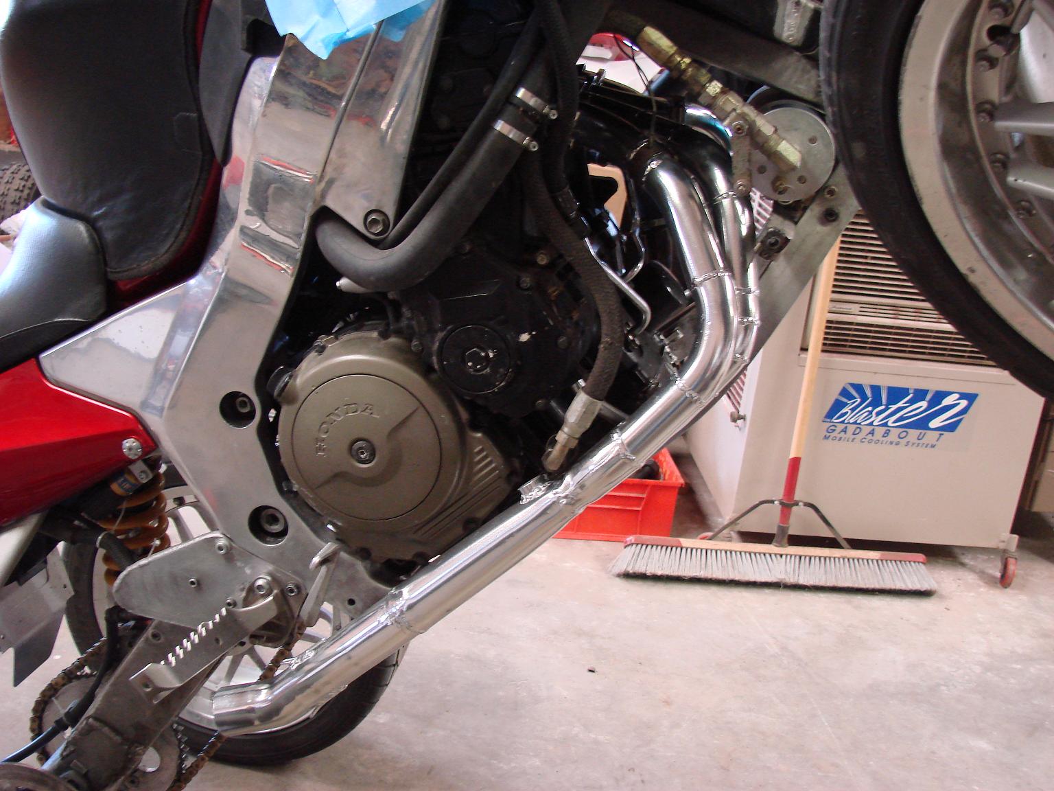

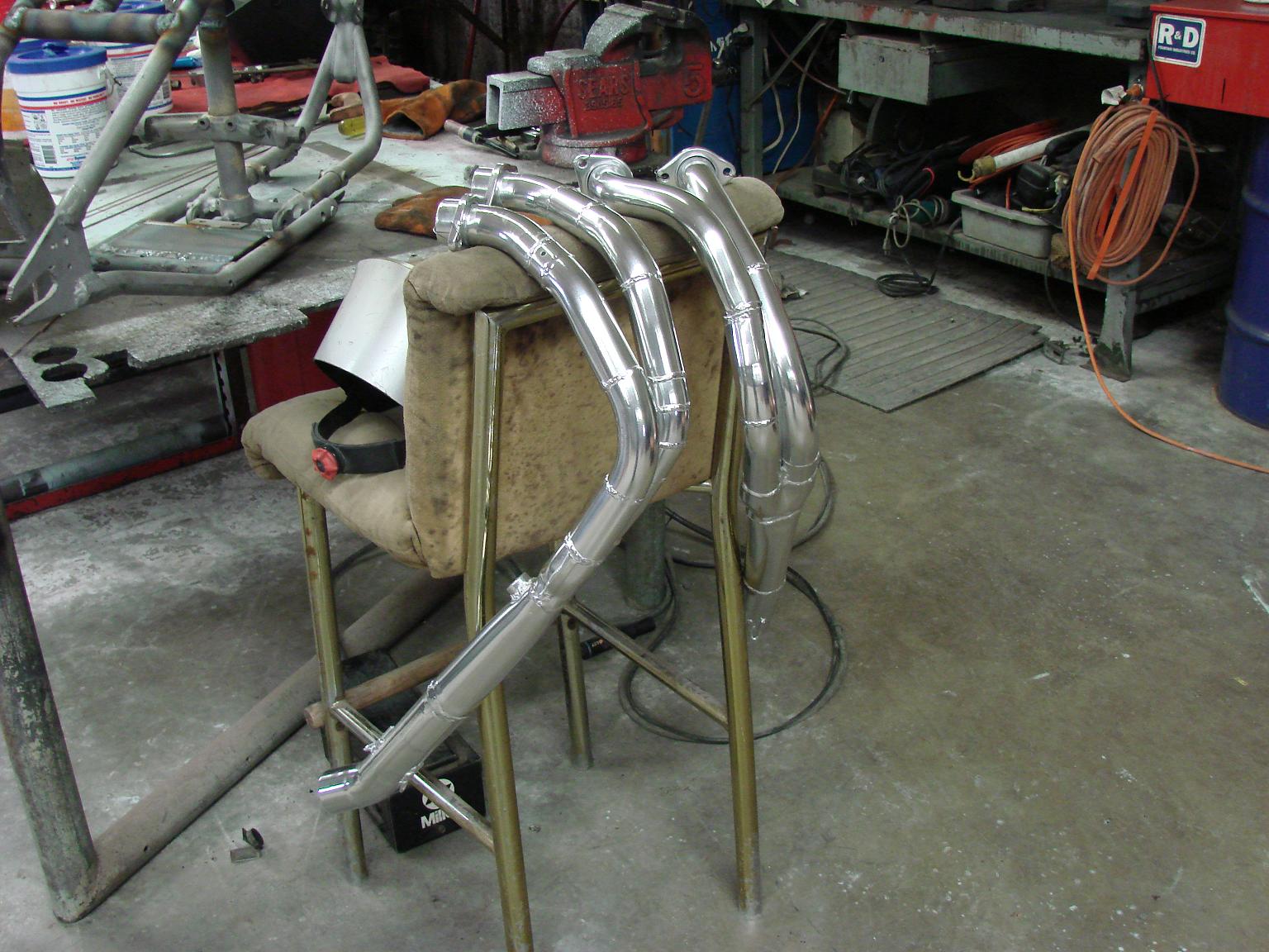

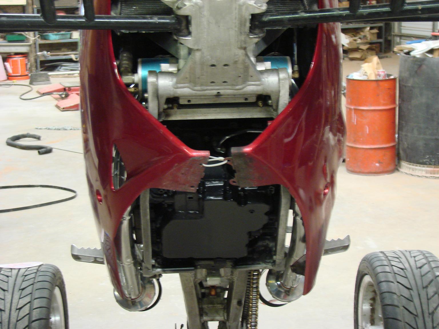

cbrxxquad Posted April 7, 2007 Posted April 7, 2007 I got mine done because the body is against it. Didn't melt it. $125.00 Quote

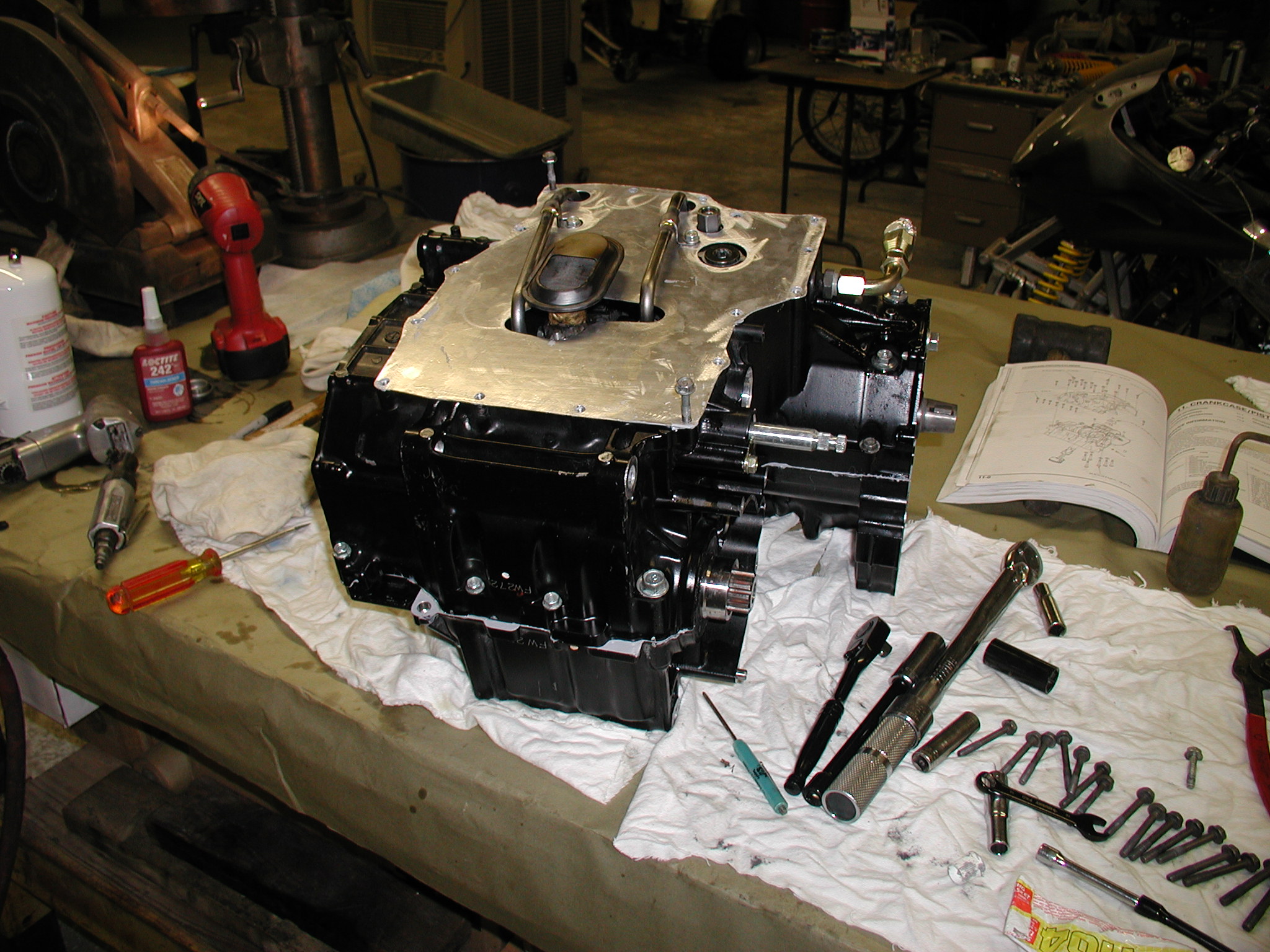

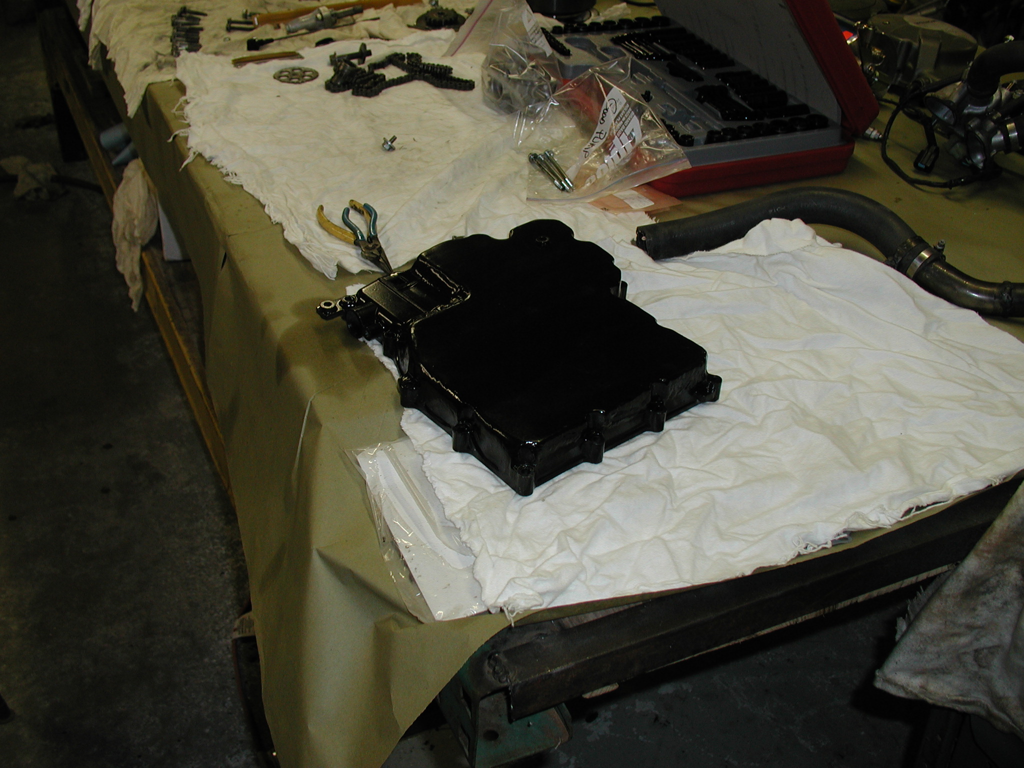

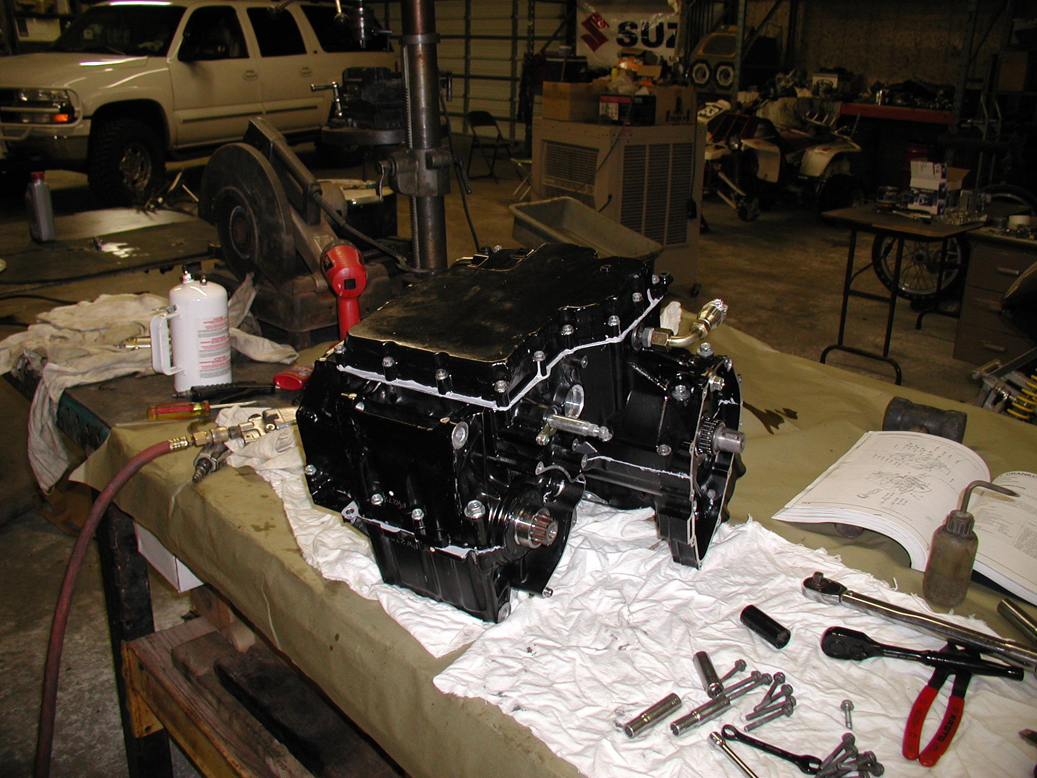

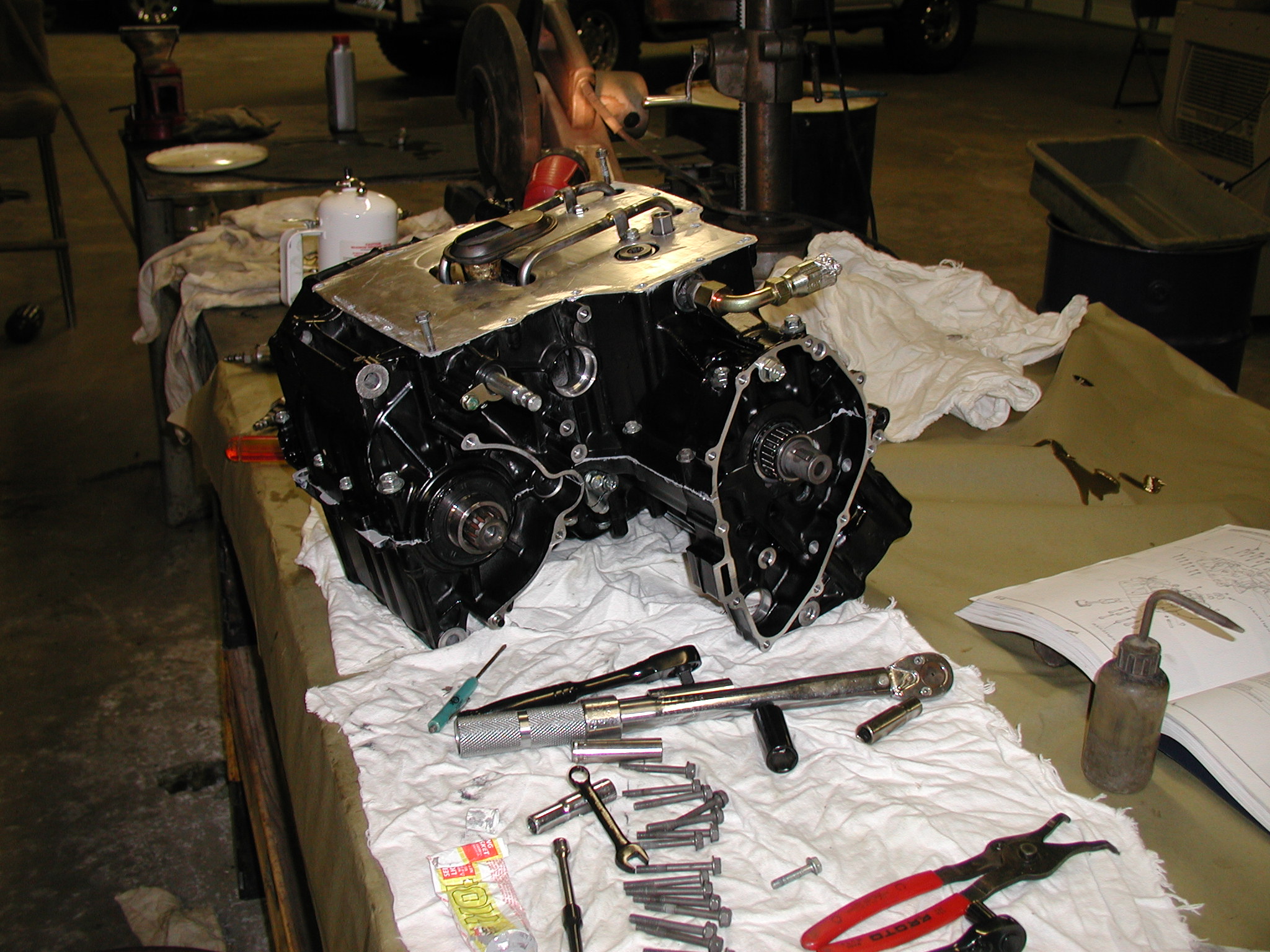

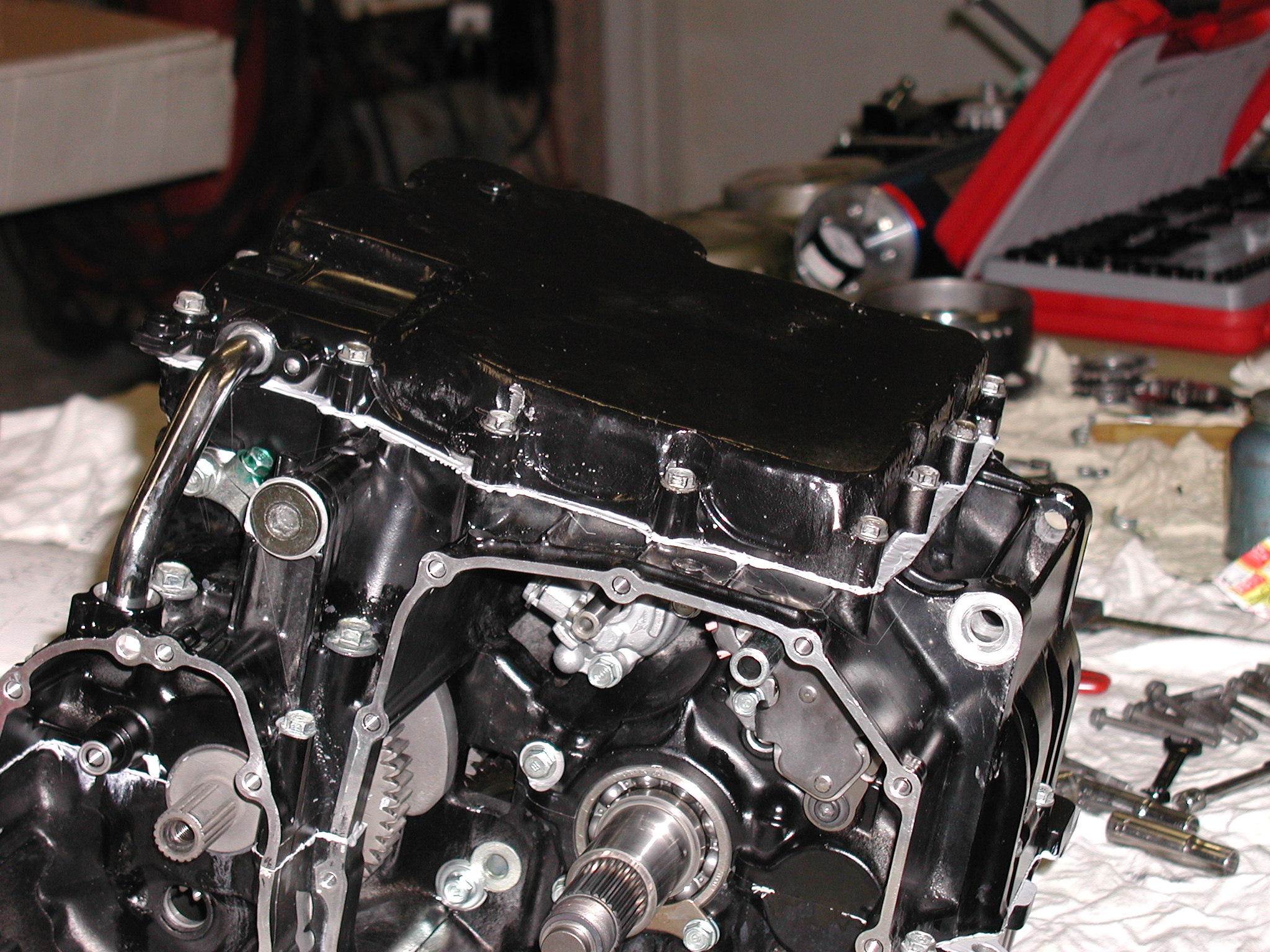

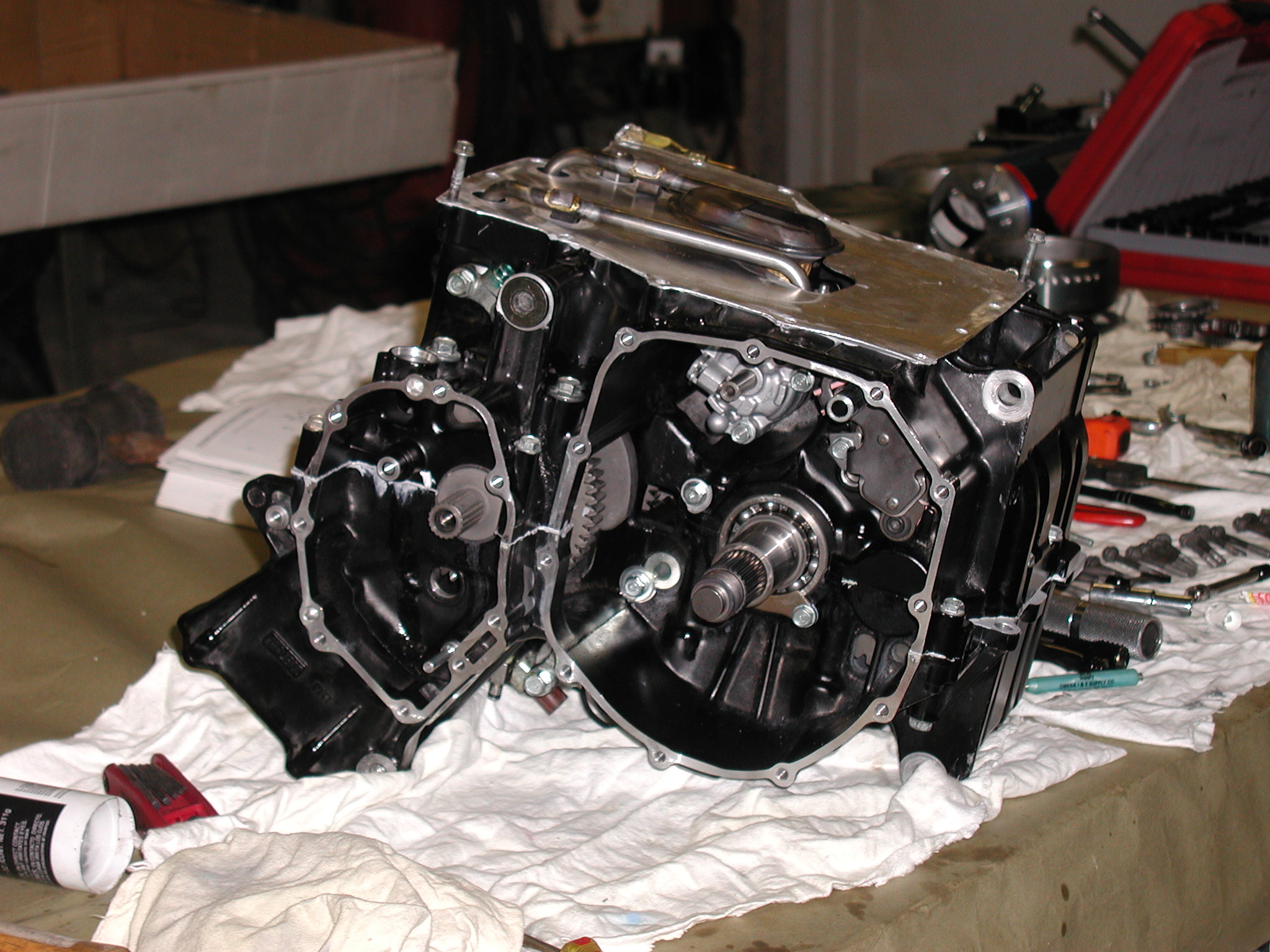

cbrxxquad Posted April 7, 2007 Posted April 7, 2007 I got mine done because the body is against it. Didn't melt it. $125.00 What oil pan are you running? I cut the sump off and welded in a 1/4" alum plate after talking with Kent Stotz , and Elton Fish at EFR. EFR has a pan that is 1" thick and billet but you have to plug the oil lines going to the cooler. I wanted to keep the cooler, so I had to build my own. Elton sold me his relief valve and helped me with mods to the oil pickup. But, I still had problems with oil starvation when I stopped and turned. Made a plate that samwiched between the pan and block to prevent the oil from getting out of the pan. And added the oil accumilatior to the main oil galley. Now EFR sell one like mine, and stopped selling the billet one. Quote
Byrdman Posted April 7, 2007 Posted April 7, 2007 I cut the sump off and welded in a 1/4" alum plate after talking with Kent Stotz , and Elton Fish at EFR. EFR has a pan that is 1" thick and billet but you have to plug the oil lines going to the cooler. I wanted to keep the cooler, so I had to build my own. Elton sold me his relief valve and helped me with mods to the oil pickup. But, I still had problems with oil starvation when I stopped and turned. Made a plate that samwiched between the pan and block to prevent the oil from getting out of the pan. And added the oil accumilatior to the main oil galley. Now EFR sell one like mine, and stopped selling the billet one. Pictures? Not that I need it but I'm interested nonetheless. Quote

cbrxxquad Posted April 7, 2007 Posted April 7, 2007 I cut the sump off and welded in a 1/4" alum plate after talking with Kent Stotz , and Elton Fish at EFR. EFR has a pan that is 1" thick and billet but you have to plug the oil lines going to the cooler. I wanted to keep the cooler, so I had to build my own. Elton sold me his relief valve and helped me with mods to the oil pickup. But, I still had problems with oil starvation when I stopped and turned. Made a plate that samwiched between the pan and block to prevent the oil from getting out of the pan. And added the oil accumilatior to the main oil galley. Now EFR sell one like mine, and stopped selling the billet one. Pictures? Not that I need it but I'm interested nonetheless. Hey did I tell you that grand prix shifting suxxxxxx big time.......lol Quote
Byrdman Posted April 8, 2007 Posted April 8, 2007 Hey did I tell you that grand prix shifting suxxxxxx big time.......lol I love your shop, wanna adopt a fat kid? The oil pan and blaffle look good. That baffle almost seems too good though! It would seem like a significant amount of oil would be stuck up in the engine, there's not much open area for it to drain back down? Ever have any issues? Quote
cbrxxquad Posted April 8, 2007 Posted April 8, 2007 I was worried about that, but I have 6 qts oil in it. 1 in the accum and it does not use that much oil as the clearances are very small, less than .001", plus the pressure is 100 lbs. All per EFR design. I was worried about the parasitic losses in the level of the oil into the crank. I can actually feel the braking effect when I stop. If I get on the rear brake to much the combined effects will lock the rear tire or chatter. My dip stick is marked way high for oil level, I think three qts higher. So what is pulled out under the pan sucks what is on top into it. There is also the line into the side of the oil pan. I think it is enough to feed the pump alone. Yes, you can come over and play. Quote
