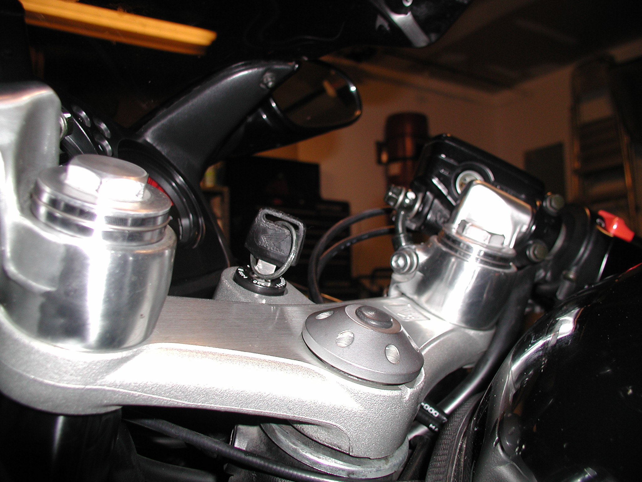

post-2556-1174136474.jpgcan someone measure or post a pic in reference to how high the stock 97-98 forks stick out of the clip ons ?
Travis and I did the racetech springs/ fluid swap last night on my bird and we noticed one side is about 1/4 inch higher than the other.
I'm pretty sure they dont slide all the way down to the little safety/retainer clips.
thanks
-mike
I just measured mine (97XX), from the top of the clip-on to the bottom of the circlip is 1.5mm.
thanks
-mike

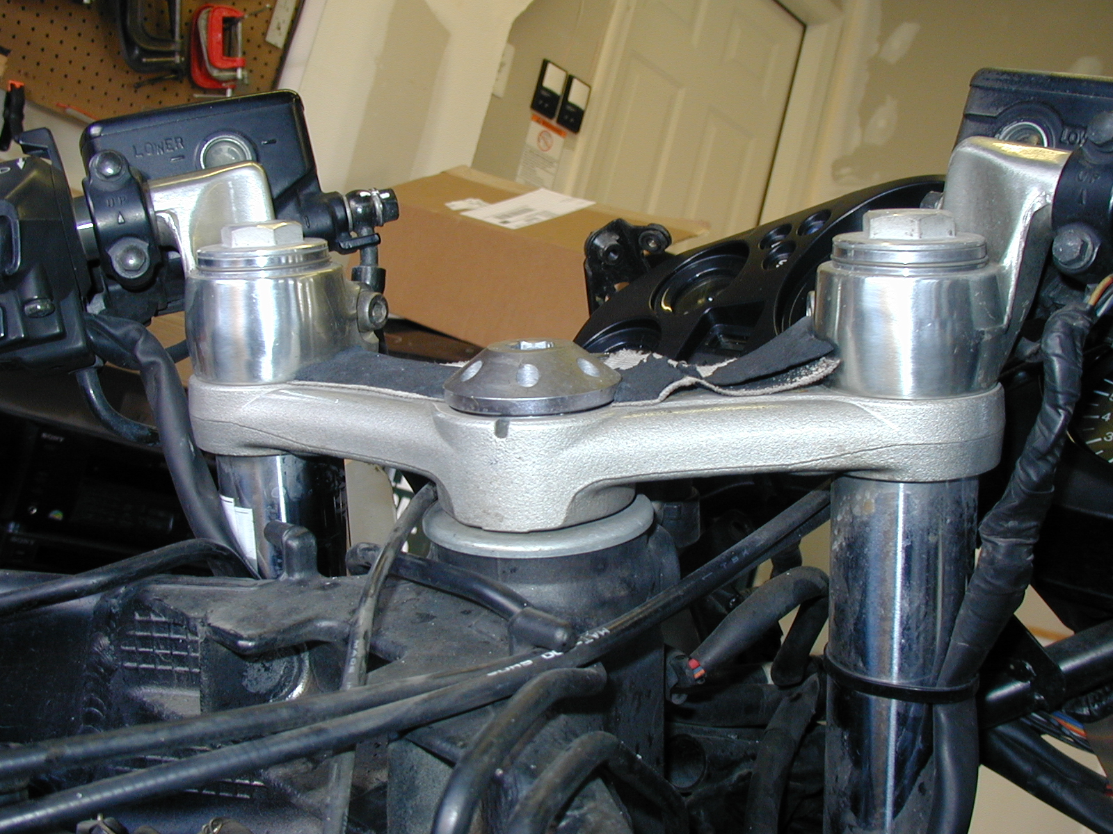

The distance on mine (98XX) - triple to circlip groove is ~36mm but I have VFR bars on now :icon_think: From looking at your pick of the left bar it looks about right, I think it was ~ 8mm above the bar to the circlip :icon_eh:

My 97-98 manual calls for 39 mm from the top of the top bridge to the circlip groove.
Just checked my manual and it does indeed state 39mm Pg 13-25 :icon_confused: Guess I will have to put them back to 39mm from 36mm, am I right in assuming this will quicken the steering like shiming the rear to lift it up :icon_think:
Yes, Mine is shimed and I have the front dropped 8mm. For me this is the limit for quickness without being to unstable.
