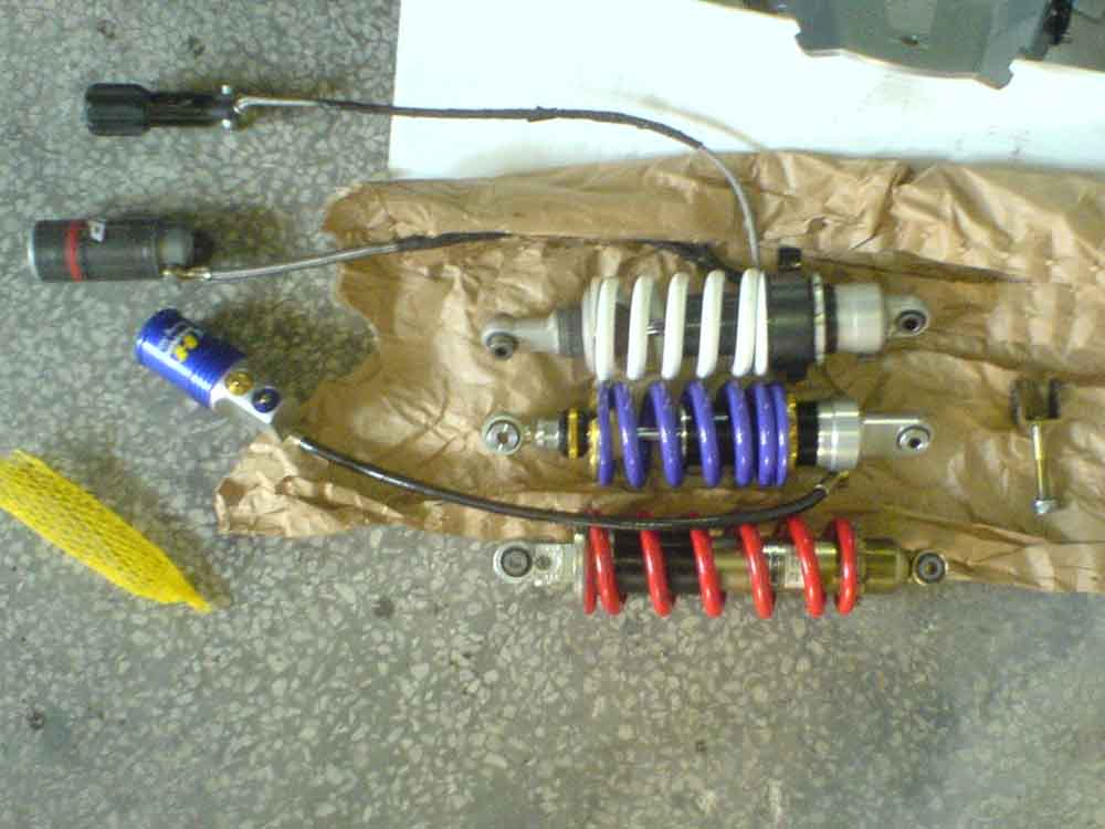

Helvet Posted August 3, 2006 Posted August 3, 2006 Why not consider Penske? Highly recommended and adjustable. Ohlins arnt adjustable ?? Ohlins are MORE adjustable than the Penski for the 'bird... I assume the Penski is adjustable for compression and rebound like the Ohlins, but the Ohlins also has a remote preload adjuster, so you're not under the thing with a hammer, drift, and spanner every time you want to go on a ride with a passenger... '01 to '03 model here... http://www.indysuperbike.com/customer/prod...6867&page=1 Mike Hyperpro offers the same with a fully progressive spring (Ohlins has a two-step linear spring), and it's cheaper too (at least in Holland it is.....). Quote

pug Posted August 4, 2006 Posted August 4, 2006 Thanks to Helvet, I am currently run the one in the middle and I am more than satisfied. It has hi-low comp aswell as rebound and ride height adjustment, and probably soon will have remote preload. Quote
