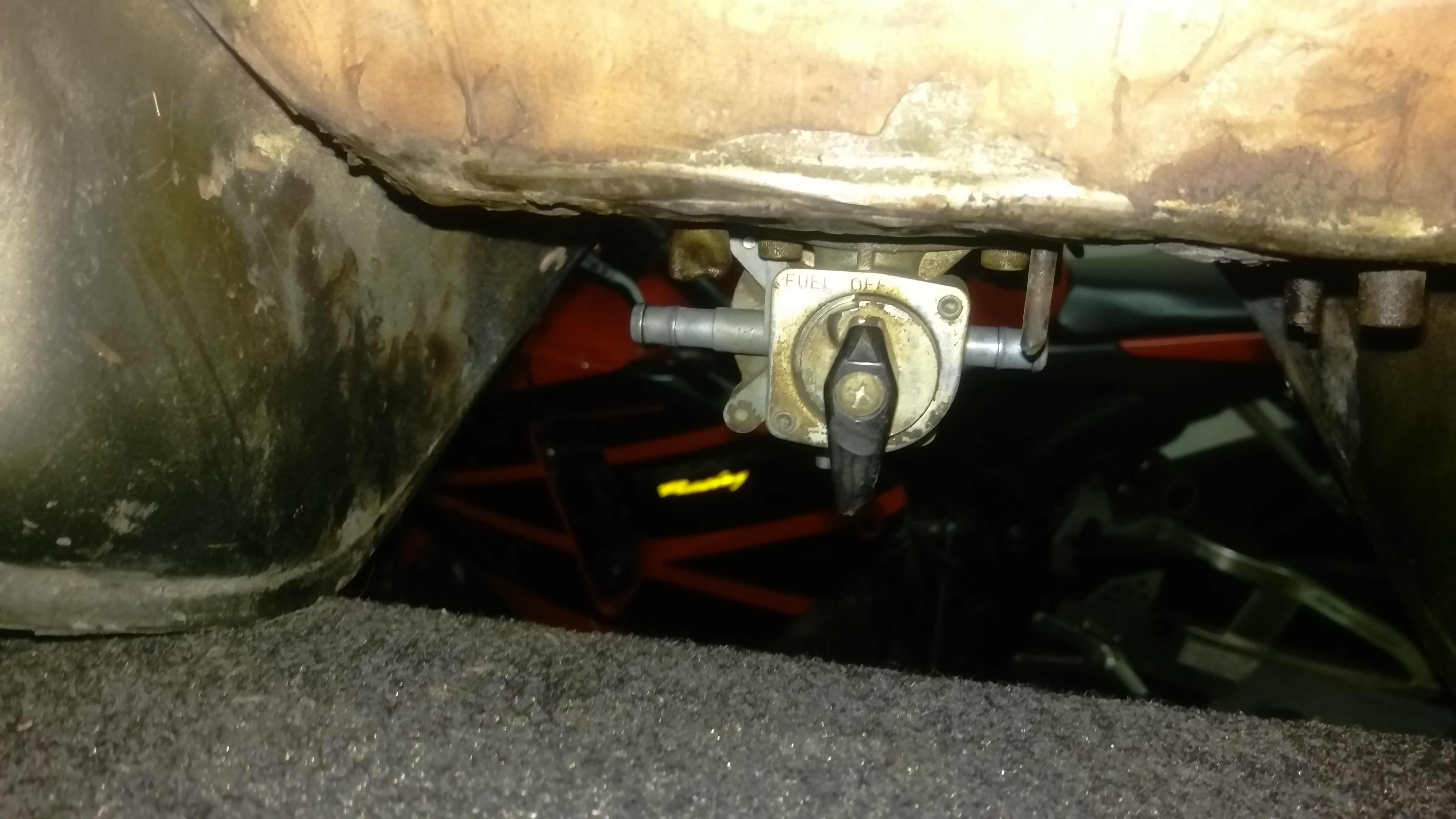

The petcock was cut out and replaced by a previous owner on my 98 bird, so I'm not positive that it OR even the tank belong to this bike. Does anyone know if this is the right one and/or know the on/off/res positions?

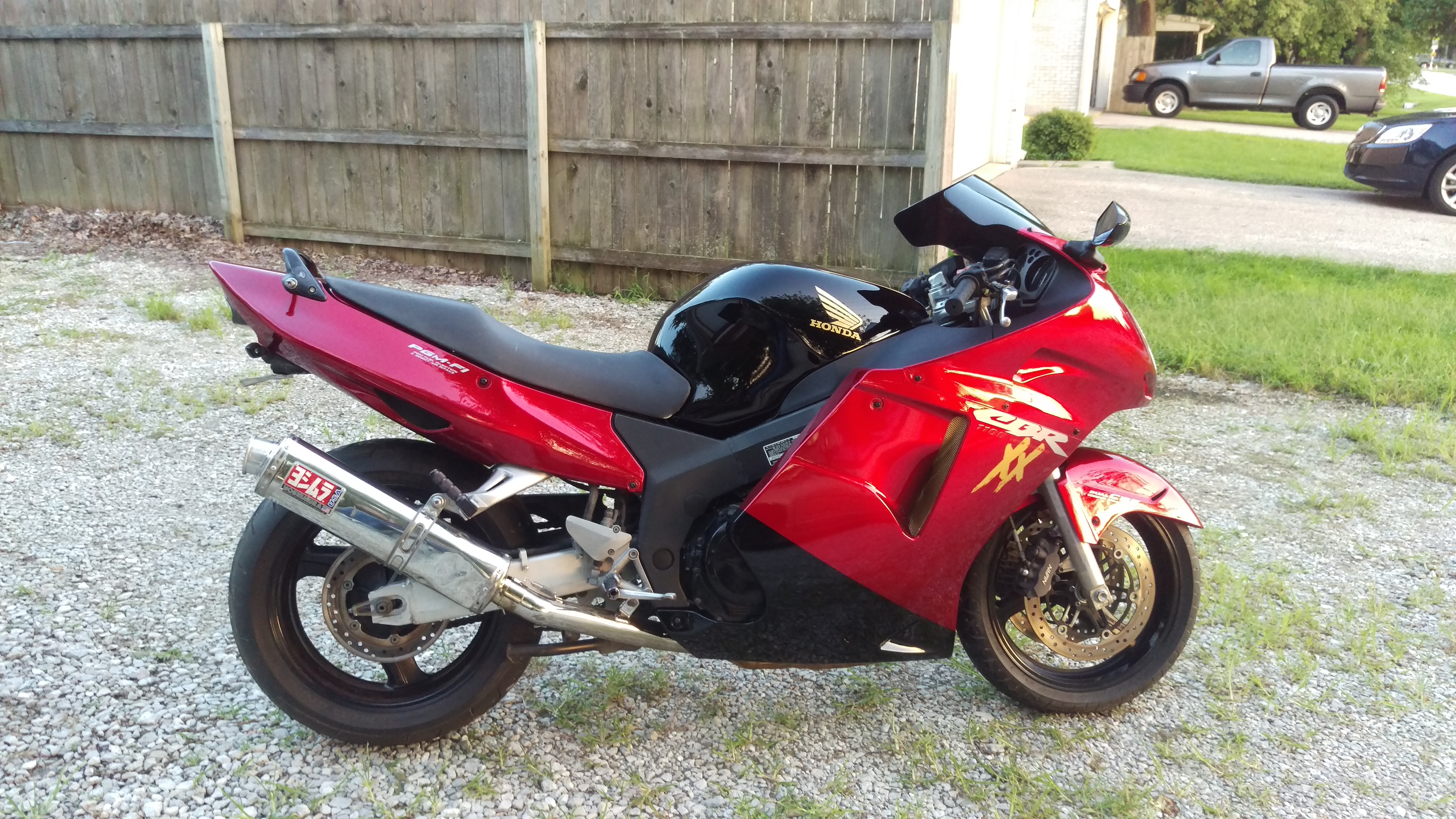

As it turns out, a float was cracked, and filled up with gas. I should have know when I saw JB Weld on the housing. I put a new one in there and she runs like a champ. I guess I don't have to rebuild yet. Now I can spend the good days riding. : ) I only want to rebuild them because I'd like to change the jets, and swap out the busted carb. This bike is a restoration project. It has been wrecked a time or two from the previous owner. One step at a time, and I'll have the bike of my dreams in no time at all! I've only had the bird for month or so. Here are the before and after pics.

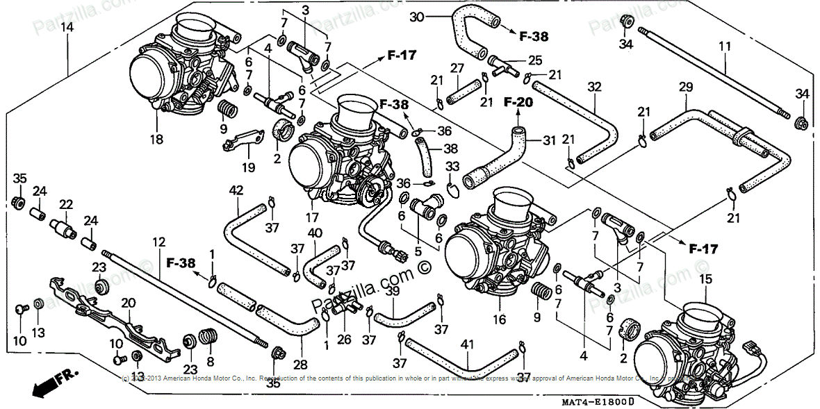

Can anyone tell me what these tubes are for, and where to hook them up? I had the bike going yesterday with no problems at all. Today they are just pissing fuel all over the place. They are #29 on the diagram below. The ones with the band on them.

I agree that that isn't what they are called, but I've been looking, and that's the most common phrase for them on bikes from what I've seen. Notice that I'll do some more research to see if I can find them. I was just hoping these were more common than they apparently are. I might just have to pay the $114 blackhawkxx mentioned. Either way, I have to have them. I might try some other experiments, like removing them completely. But I have a feeling I might not get away with that since the needle is a part of it. I'll log what I do, and post about it in the future.
I still have no idea where I can find the cut-off valves though. Any help there would be greatly appreciated. Surely somebody out there makes replacements. ..and unfortunately, they don't come with the rebuild kits..
I'm not sure on exactly where the bike came from, but being that it's a carbed bike, they should be on all of them. The air cut off valves basically do what they say. they cut off airflow when less fuel is used. As you open up the throttle, they open allowing it to breathe easier and get the proper air to fuel ratio. The are whats behind the black caps on the front side of the carbs that opens the black plates inside the top of the carb.
