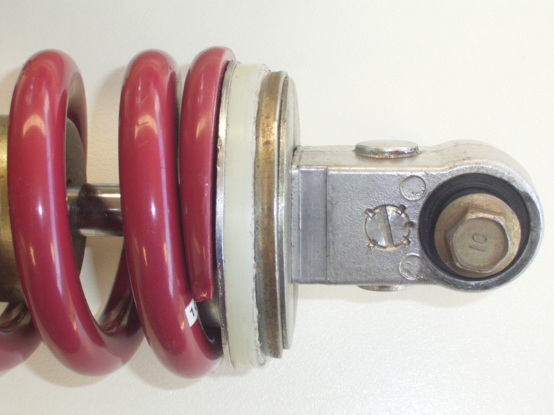

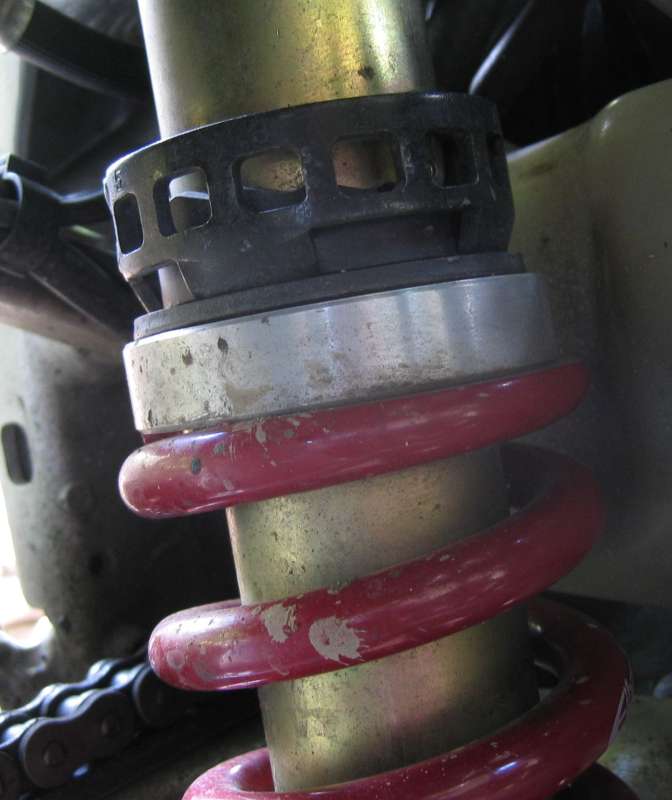

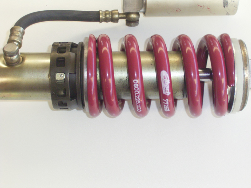

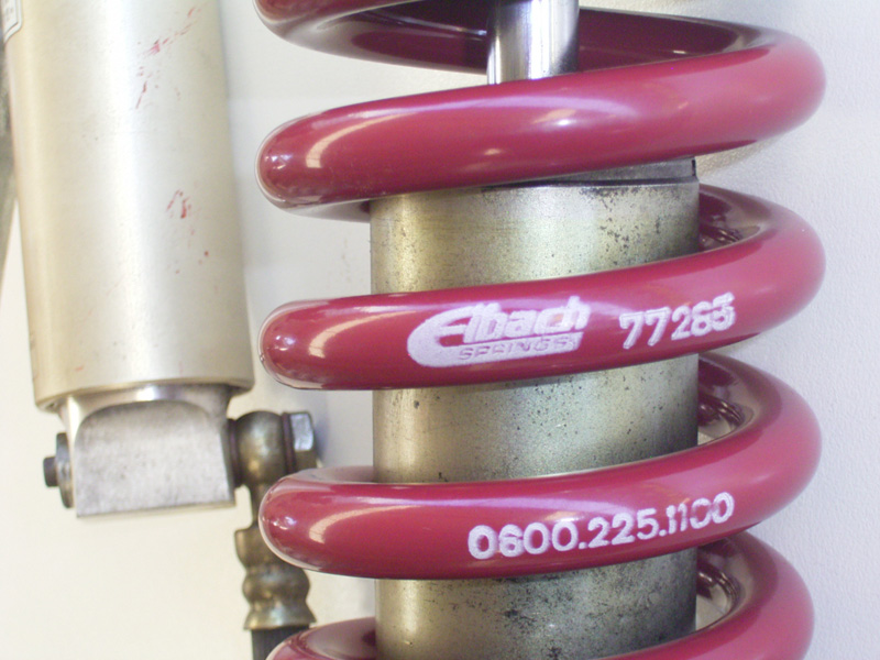

I got an Eibach 0600-225-1100 (6"L x 2.25"Diam x 1100lb's) for mine and then needed a 1/2 spacer/collar made up
1st 3 pics are mine last is a collar another guy on OzBB got made up :icon_think:
